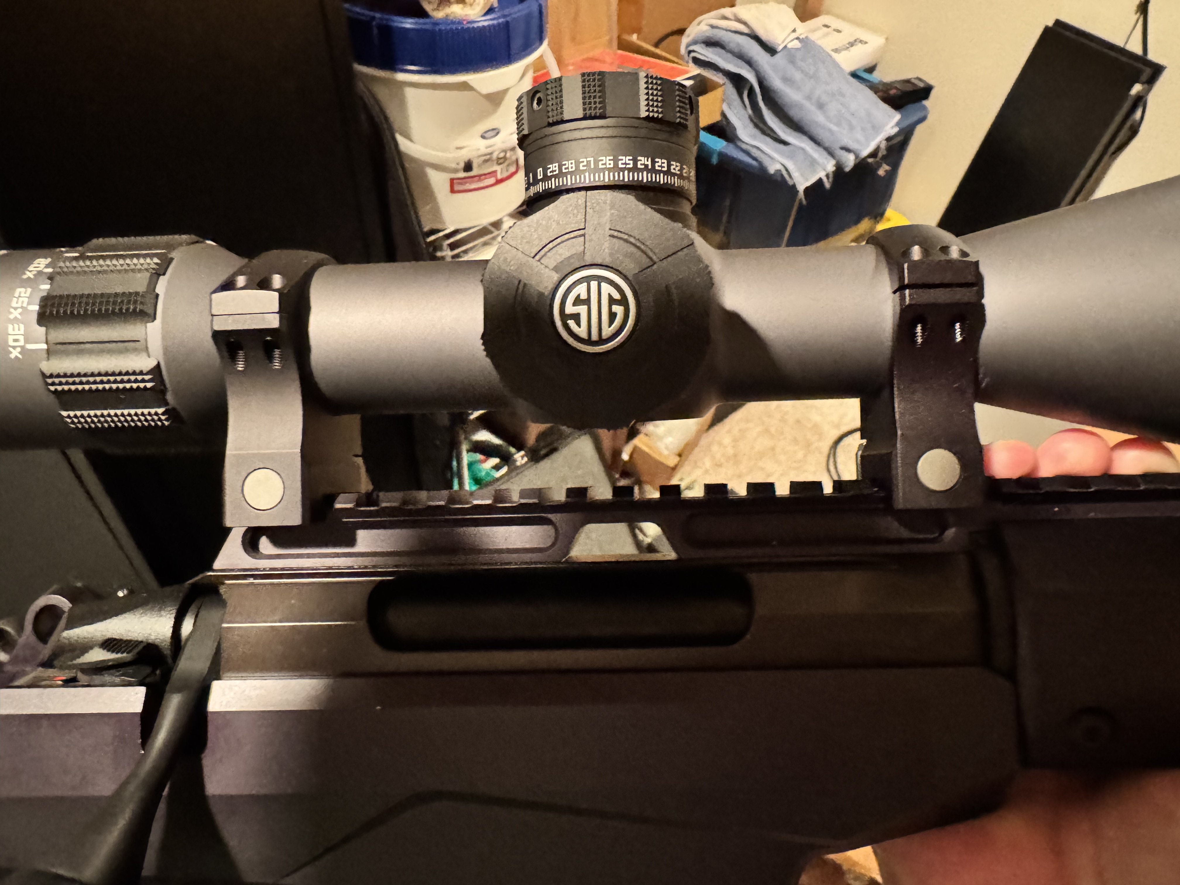

I recently purchased a used Tikka t3x tac a1 (chambered in 6.5 Creedmoor). With the purchase, a Sig Sauer Tango6 5-30x scope was included. However, as seen in the picture, it also came with some no name scope rings that I’d like to replace.
I’ve scoured lots of different forums but the mount recommendations seem to change over time, so looking for some fresh suggestions. I’d like to stay below $300 if possible (I know Spuhr comes up as consistently the best, but $600 for a mount is just a bit much right now.). Only consistency is minimum is 20moa

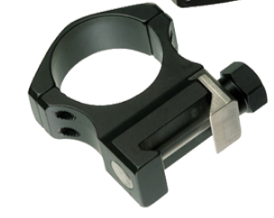

Best bang for the buck and what I use on my Tikka Tac A1, and my AiAX. This mount was designed for exactly what you need. Quick detach and always returns to Zero for me.
Reactions: Fishey9999

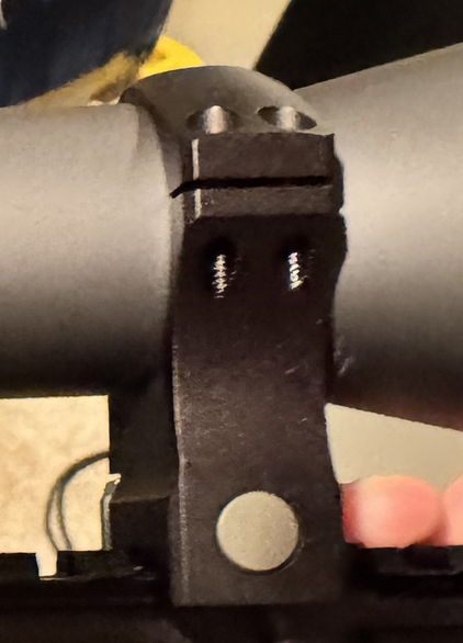

So it looks like you may have Nightforce rings - I'd keep them for sure unless you encounter some problem. Just make sure they're torqued properly. It also looks like the rings are set very close to the ocular and objective bells... I was taught that the rings should be at least 1/8" away from the bells.
Fwiw, rings have one big advantage on a bolt gun over a one-piece mount: the ability to optimally space the rings on the scope tube and rifle rail. Certainly, whoever mounted that scope went for wide spacing --> great stability... although I would have put each ring one rail notch closer to the turrets.
If the scope's current position works for you, there's no real reason to change anything unless those rings are right up against the fore and aft bells. I'd personally move them in that case, but that's me. If you're new to this precision rifle silliness, you might as well learn to do scope mounting correctly. You'll need an inch-pounds torque driver like a Wheeler FAT wrench - but you do NOT need all manner of leveling trinkets. There are plenty of how-to threads and videos. Just make sure you apply correct torque to the mount screws.

Thank you for all the details here! I am definitely new to the precision silliness and now that I know that I've got decent mounting hardware, I'll keep using those until I need something different (like a MOA tilt). I dabbled in the past with a custom built I put together, but now looking to dive back in. The scope was mounted by the FFL because it was just loose in the box (the shipper forgot to include the case so my FFL didn't want it floating around the shop). I definitely have a range day coming up where I'll be remounting it and getting things in the proper position. Luckily, that scope has a built in digital level (LevelPlex) that make it super simple. I still have a lot of reading to do as well. I'll be sure to follow your advice as far as mounting is concerned! I'll need to look up the torque settings and have a torque driver on the way!

If they are NF rings, which they look to be, you can easily use them to start out and not be hindered at all, so right now I wouldn't bother changing them. If it was me I'd move both of them in 1 notch. I never like rings to be right at the "ends" of the tube or too close to the windage/elevation knobs. Sometimes the scope tubes flare a bit at the ends and it can reduce how well the rings hold.
While you don't "need" a 20 MOA mount, and most scopes will get you to 1000 with a 6.5 easy. Sig says the Tango has ~79 MOA of elevation travel, you lose ~half that with a 0 MOA mount, so 40 MOA will easily get you past 1000yds with a 6.5.
One of the advantages of a rail or mount with rise is that if you often shoot longer distances a 20 MOA mount keeps you in the center of your optics at longer ranges. Optics all loose some quality/resolution as you go toward the edges if you start with a zero MOA mount, and shoot longer distances, you are probably taking some resolution degradation because you are not in the center of the optical path. You'd much rather have your best optical performance at longer distances than at 100m (unless that's where you shoot most often).
For example, and I'm sure this math is not ideal and varies by ammo/gun, but a 6.5 drops ~20 MOA around 800 yards. A 20 MOA mount lets you stay near your optical center at 800m. The downside is at 100m you are not in your optical center but most would rather have best optical quality at longer ranges. The difference is usually pretty small, but if you are buying a mount anyway, most opt to have some elevation built into the mount if it's not built into the rail already.
That said there are a lot of good 20 MOA 1 piece mounts available without spending over $300. I'm not a fan of quick release mounts unless you have a need to swap optics around frequently. Some of the ones you often hear about being reliable and dependable.
