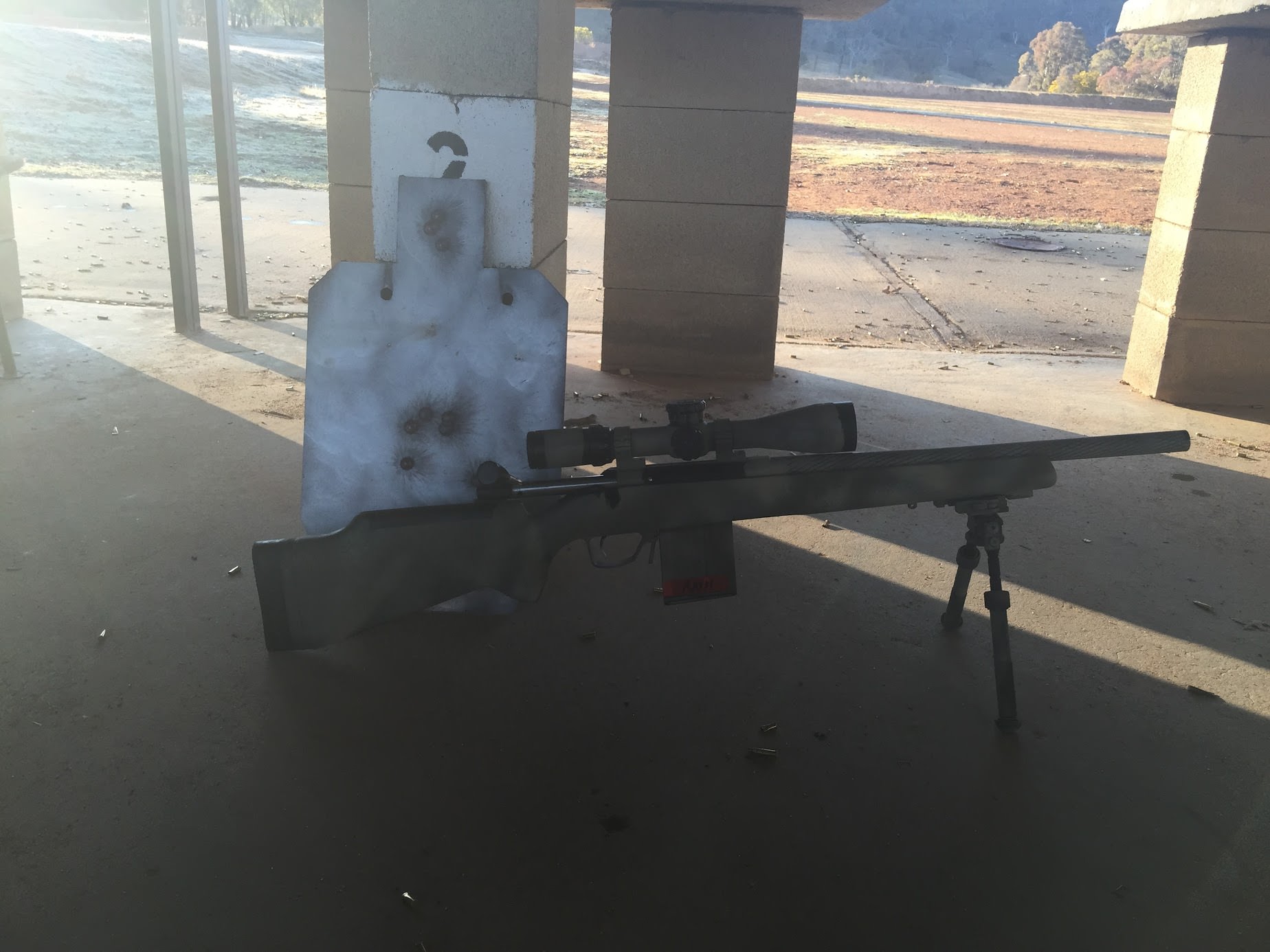

Last Friday I picked up a T3X Lite Stainless in 6.5 CM. Went home loaded up a 10 shot ladder and 40 others with 41.5 grains of IMR 4350.
We shot the ladder real quick more to look for pressure signs than accuracy but they all went in an inch at 100. Shot 3 quick of the 41.5 for zero and they went half inch.
I didn't have much time and I wanted to dope it to 1000 so I can shoot a match this Saturday. I'll end up working up something a little hotter later but I'm pretty confident that if I shoot like crap on Saturday it won't be the rifle.
It's instantly become my favorite ever rifle.
