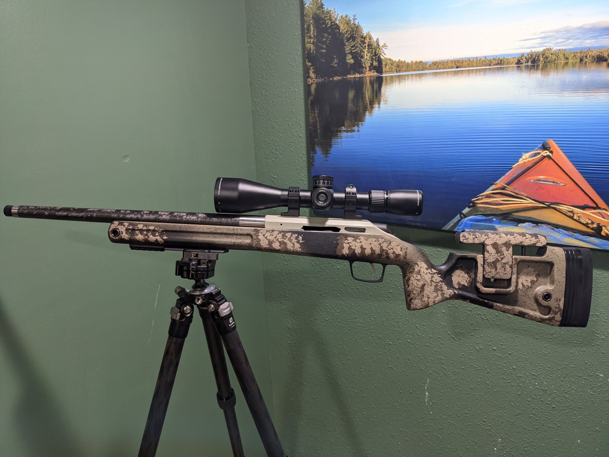

I bought just a Veil action and built a 7SAUM on it. I don't think you'll regret going Tikka, but its hard to resist upgrading it.
Awesome build. I'd love to go 7SAUM, but I don't reload.
