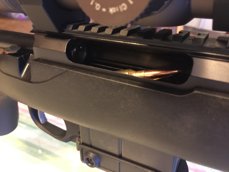

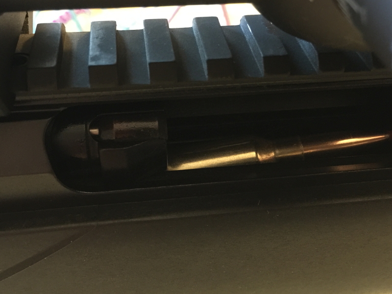

    Picked up my brand new Tikka T3x CTR in 6.5 Creedmoor yesterday. I like it and I'm hoping it will be as great a shooter as my T3 Hunter in .308 Win.
    That said...I've encountered a problem that I haven't seen before in a rifle and I'm hoping someone who has seen this before might chime in, hopefully with a fix.

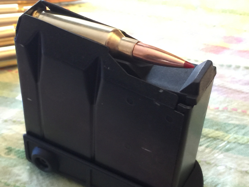

    When feeding rounds from the magazine into the chamber, the rearward motion of the bolt seems to be dragging the top round rearward and the cartridge winds up slightly nose-up and base-down. When pushing the bolt forward, instead of the bolt face catching the rear of the top round and pushing it forward into the chamber, it rides right over the top of the round and nothing gets chambered. Usually, if I run the bolt a second time it will work - but not always. It does this about every other round. BTW, the magazine seems to be seated solidly, not exhibiting the other issue some CTR mags have had - mag falling out.
    It almost seems like the spring is a bit on the weak side, but in addition to this, I noticed that on the last round the front of the follower actually can come up out of the magazine rather easily. Has anyone else had this problem? Is there a fix? I've been reading several posts in the Tikka T3 thread about how reliable the CTR mags are, so I was a bit shocked at this.
    Any help is appreciated. Thanks.

    I have two mags like that one and an original CTR mag. I have never seen that happen. I wonder if the follower is under sized or if the feed lips need to be bent together a little. The only thing I have done to my mags is take a slotted screwdriver to the mag catch slot on them and bend it out a little.

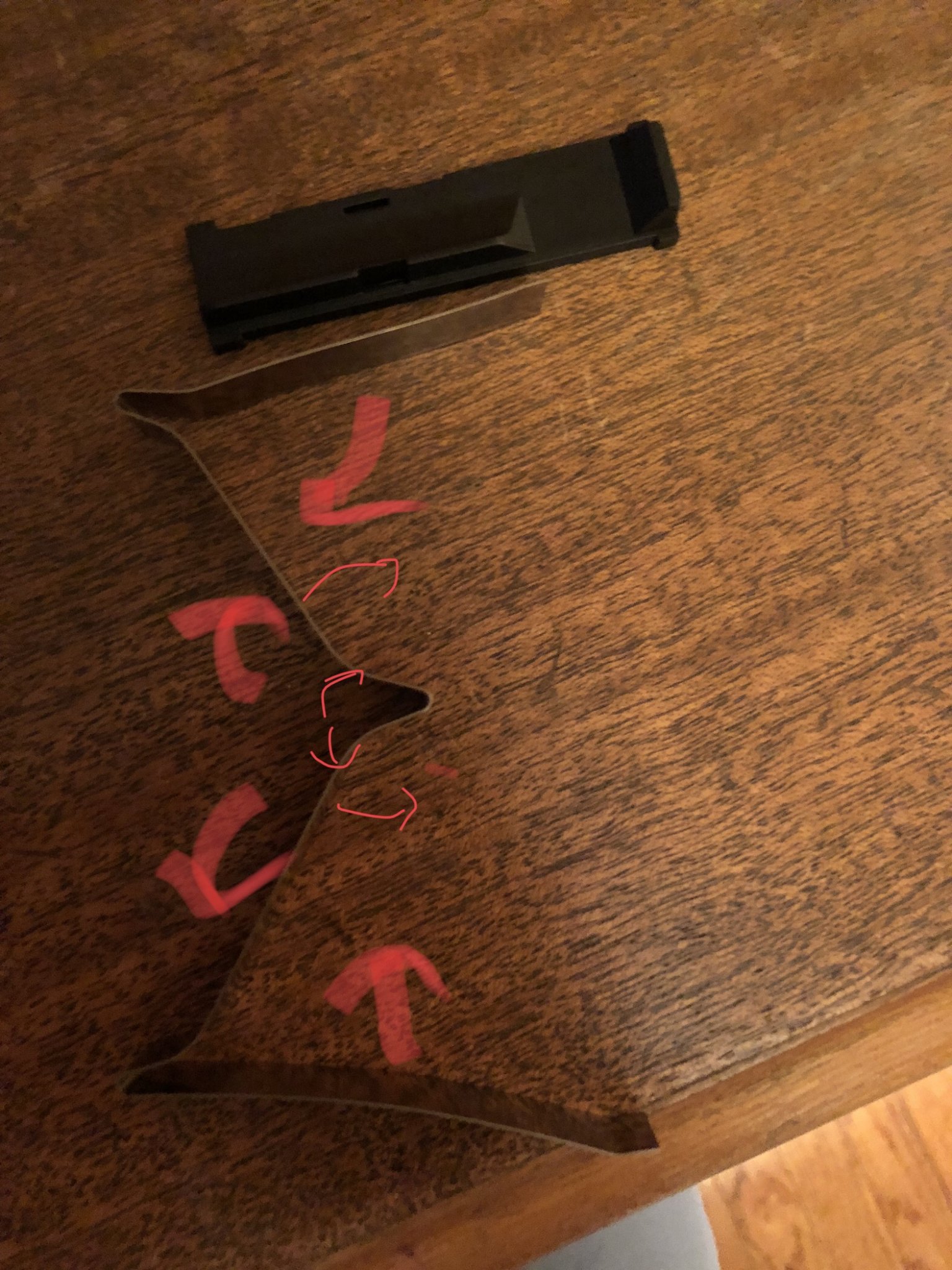

    I've got 6 of these, and I've never seen that happen. Best guess is that the spring is in backwards. CTR/TRG mags use a flat spring instead of a coil like most others. I'm pretty convinced that's part of why they're so reliable. That being said, if it was attached to the follower backward, I could see that potentially causing this problem. If you fish the follower/spring out of the mag body it'll tell you pretty quick. If put in properly, the first bend in the spring should be at the back of the follower.
    Start with this. The flat spring might need some tweaking but it’s easily done and you’ll get it sorted.
    Not sure. When the bolt face DOES catch the next round, it feeds nice and smooth. So maybe, maybe not.
    I tried this already, and it looks like it's in correctly - first bend at the back of the follower.

    How might one go about doing that? If you don't mind sharing, I'd appreciate it.
    Are you familiar with TRG mag?
    Slide the follower out the front. You should be able to get it off the spring.
    The way the follower is pointed up at the front in your pic is how it comes out.
    Then you will be able to remove flat spring which is the heart of the mag. It will need to bent to allow it to apply more pressure on the back of the follower. Refit and cycle test till you have achieved the correct feeding. It may take a few attempts as it must be a specific way (obviously) to function correctly.
    Let me know if you are following. Hope that helps.
    I follow.
    With more pressure needed on the back, I assume that I'll need to bend the front down, giving the rear some "up" and increase the pressure?

    Yes, this worked! I made several attempts, but finally wound up bending the top leaf forward and compressing it as much as possible, and bending the middle section up at the rear - opening it quite wide. Eventually, I got it to work.

    The spring needs more pressure on the follower so I stretched and bent them forward to get it right. Also, if you take a flat tip screwdriver into the cutout for the mag catch and create a lip it will lift the mag, reducing wiggle and improving feeding.

    I had this exact same issue. Bend the mag spring so that the front points down. That will force the back of the round up so the bolt catches it every time. When I first got it, I could hardly get through a mag without a failure to feed. Since I fixed it, I haven't had a single one.
