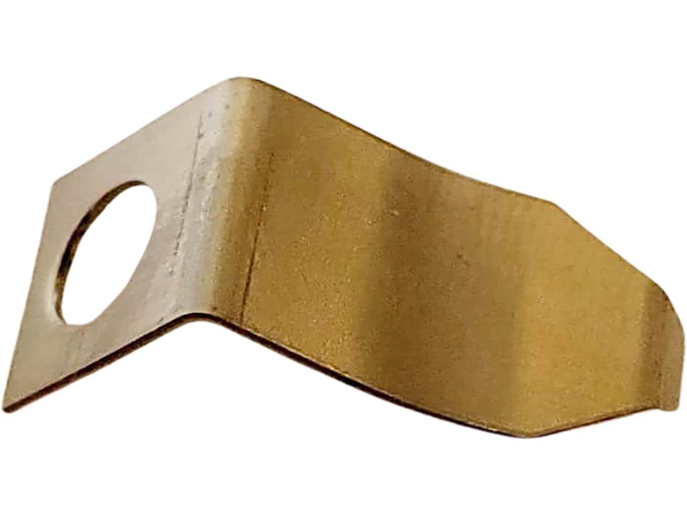

Be aware there may be a small leaf-spring type metal tab under the bolt for the trigger that is used for the standard Tikka mag retention. If I remember correctly you will have to remove that first before switching to chassis/other DBM. (unbolt and remove)
Something like this:
Yes, should work.
Be aware there may be a small leaf-spring type metal tab under the bolt for the trigger that is used for the standard Tikka mag catch. If I remember correctly you will have to remove that first before switching to chassis/other DBM. (unbolt and remove)
Be sure to save that little spring in a safe place - they're expensive to buy right now.
