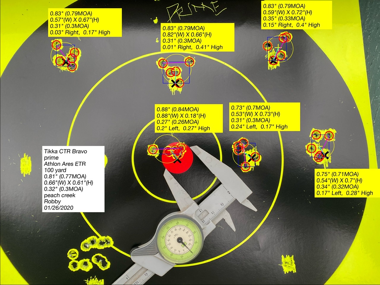

my Tikka CTR 6.5 with Prime at 100yards. All 5 shot groups. 10 shot group was with magneto on. 143eldx shoots like this too. 140 gunner does sometimes.

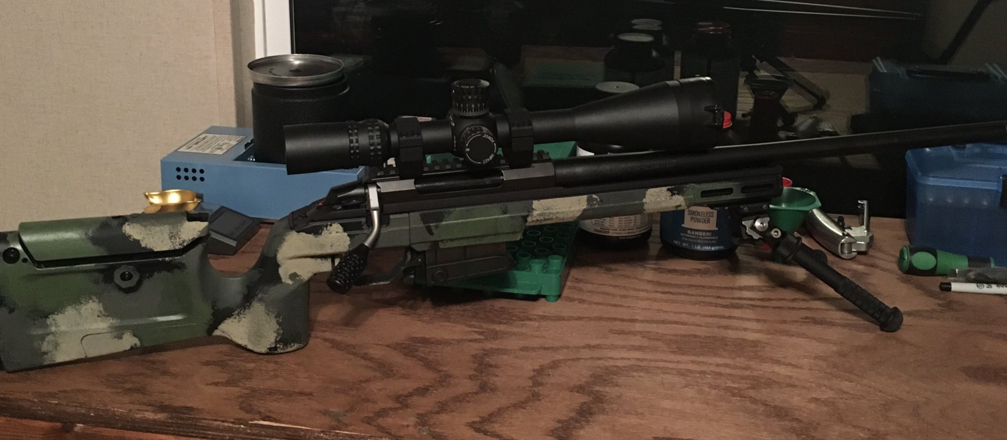

Yes, they do. You’ll need a action wrench, barrel vice, go and no-go gages. As far as weight, with nightforce nxs, and atlas bipod, my 20” ctr .308 is 11 1/2 lbs in the bravo.
I haad a 6.5c T3X CTR for a few months and I would like to check out the B14 HMR because their Adjustable cheek piece, bottom metal takes pmags If you're a lefty, I don't like the ergos of the CTR safety either.
Yes, they do. You’ll need a action wrench, barrel vice, go and no-go gages. As far as weight, with nightforce nxs, and atlas bipod, my 20” ctr .308 is 11 1/2 lbs in the bravo. View attachment 7237202
