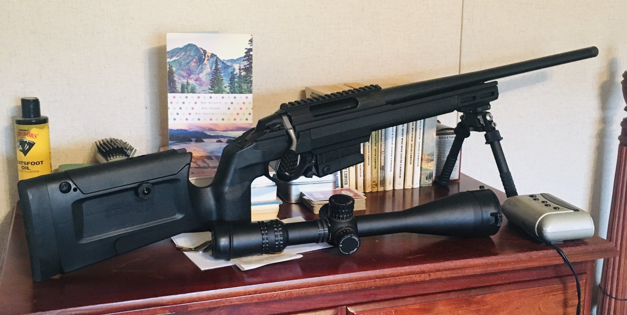

And, yes, a 20" 308 CTR inside a KRG Bravo would be a solid rifle that would last a very long time.
I love the KRG Bravo setup. I've got two other rifles riding in those and they fit me perfectly. I've also got a Savage in a 180 Alpha from KRG and its nice as well. I'm a sucker for their equipment. Plus I get it the next day since I live pretty close to them.

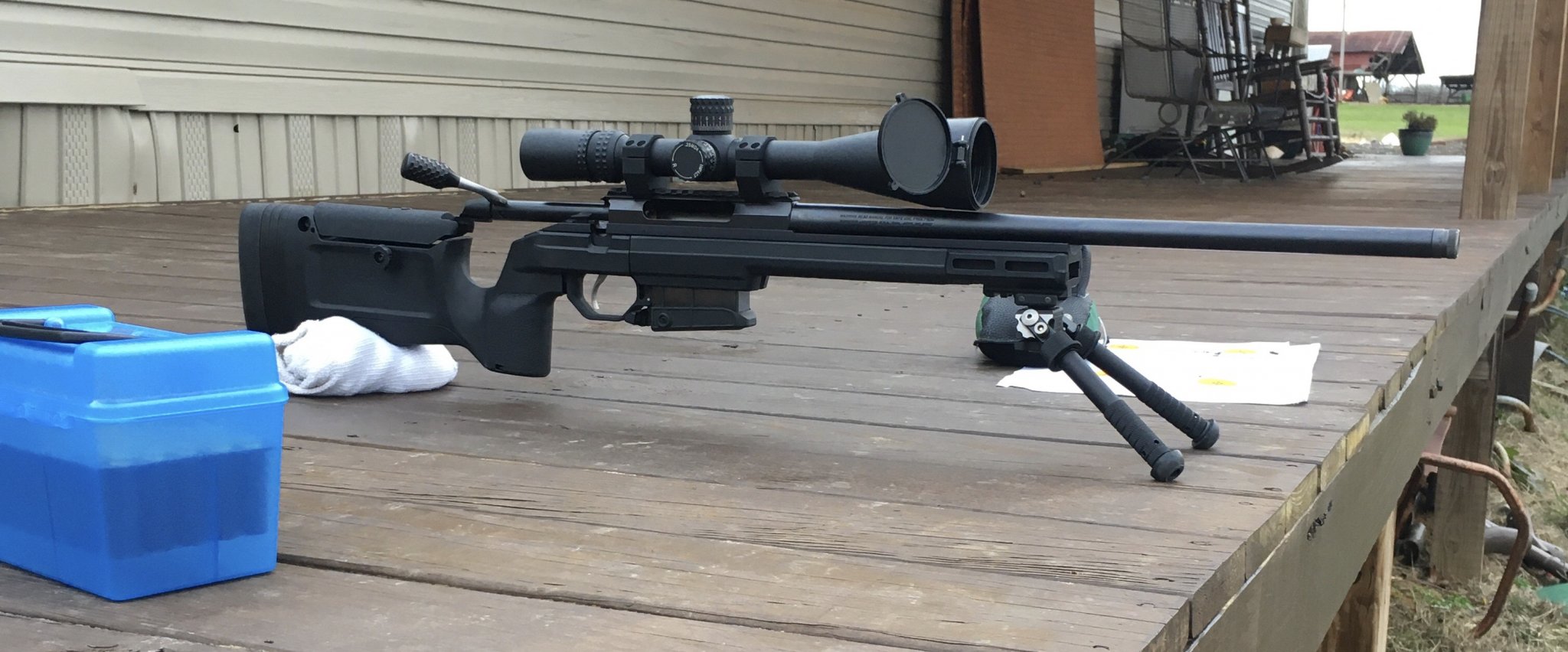

I didn’t remove the rail, it’s pinned so I left it for strength. It’s balances very well and is surprisingly light for what it is. Yes the ctr mags feed great, love the ctr mags.

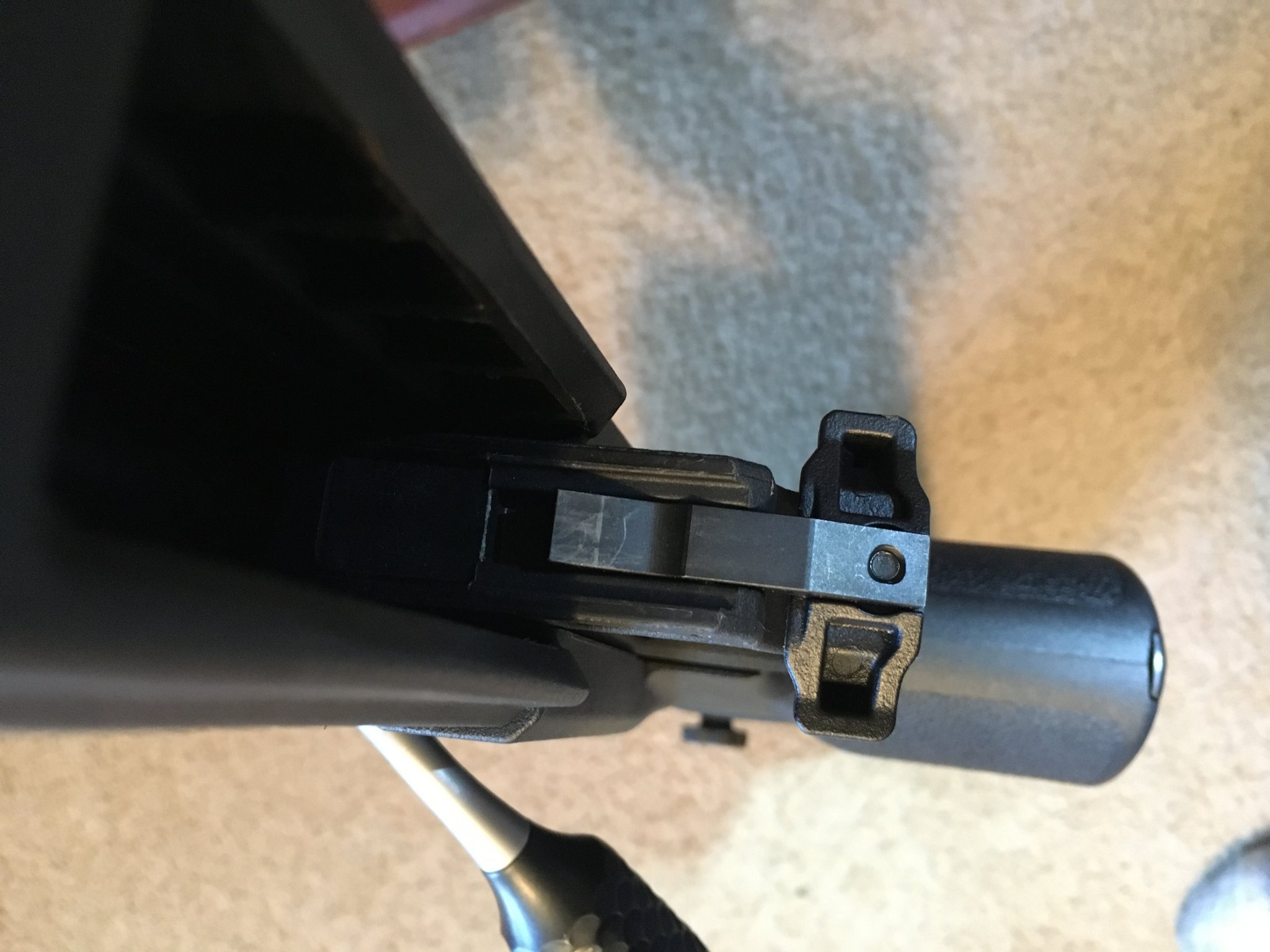

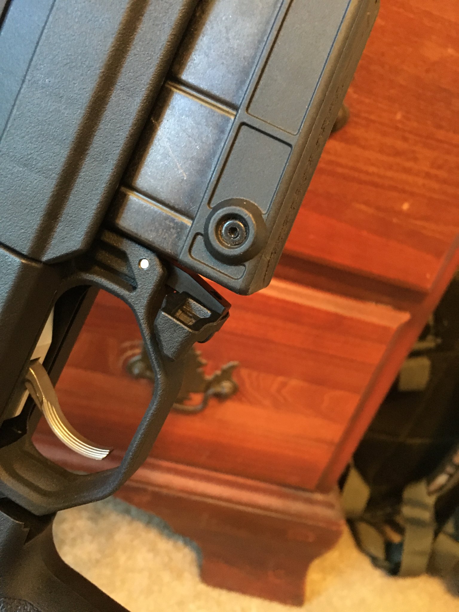

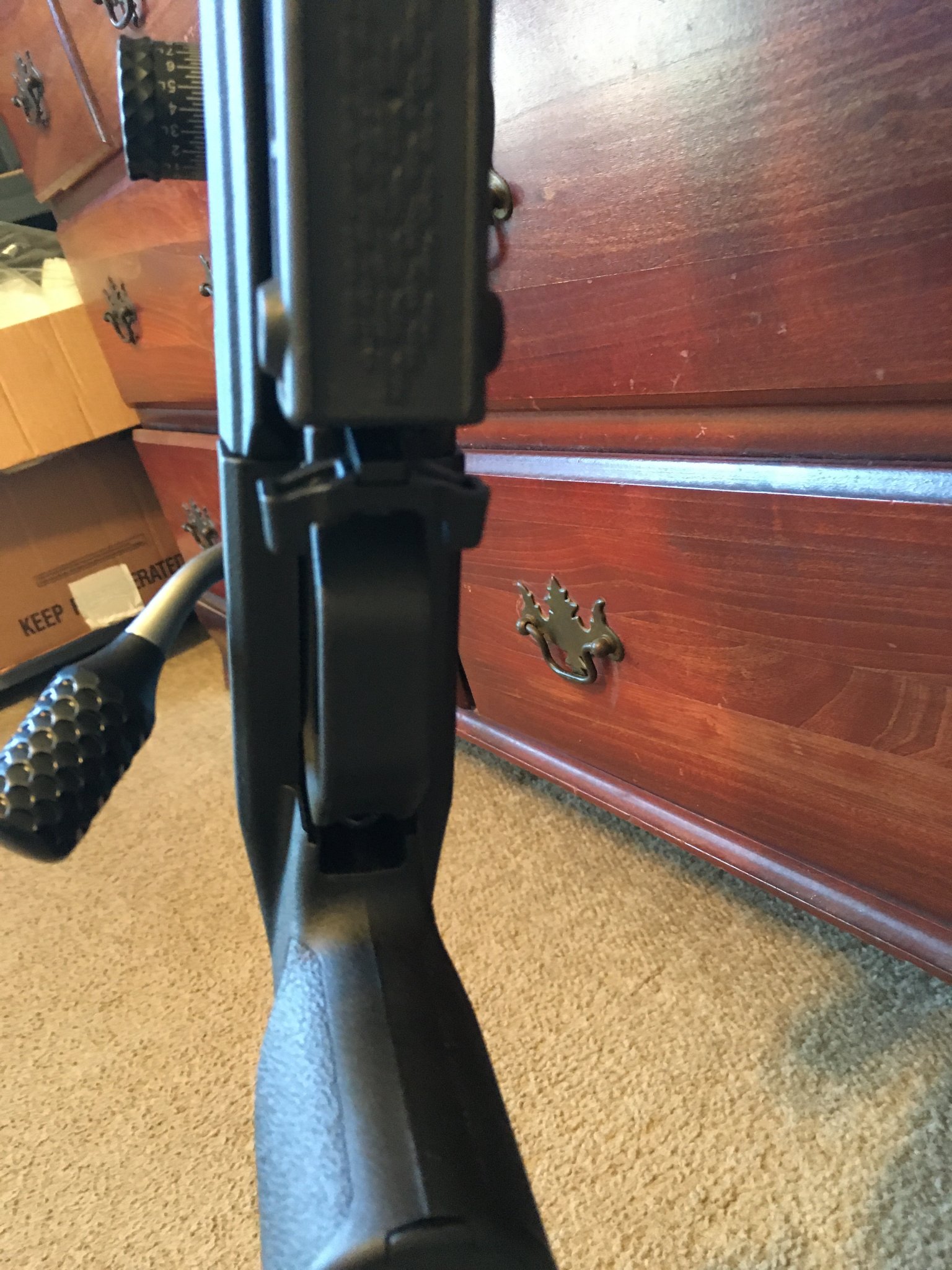

Yes the trigger guard is plastic, I don’t really see a down side to it though and the mag release is great.
Pictures of the trigger guard and mag release. I had to send these to krg because it wasn’t holding the mag in after the second round. It just came from the factory a little big, all I did was move the trigger guard forward and problem solved.

I have the 6.5 CTR in a bravo chassis, and it's a peach! Before buying the Yodave spring, try adjusting the factory trigger. It's an amazing piece!! Here's where mine measures on it's lightest adjustment
Exactly. I dont have a fancy spring in either of my rifles. The stock trigger is just fine for me at a c-hair under 2 pounds.
