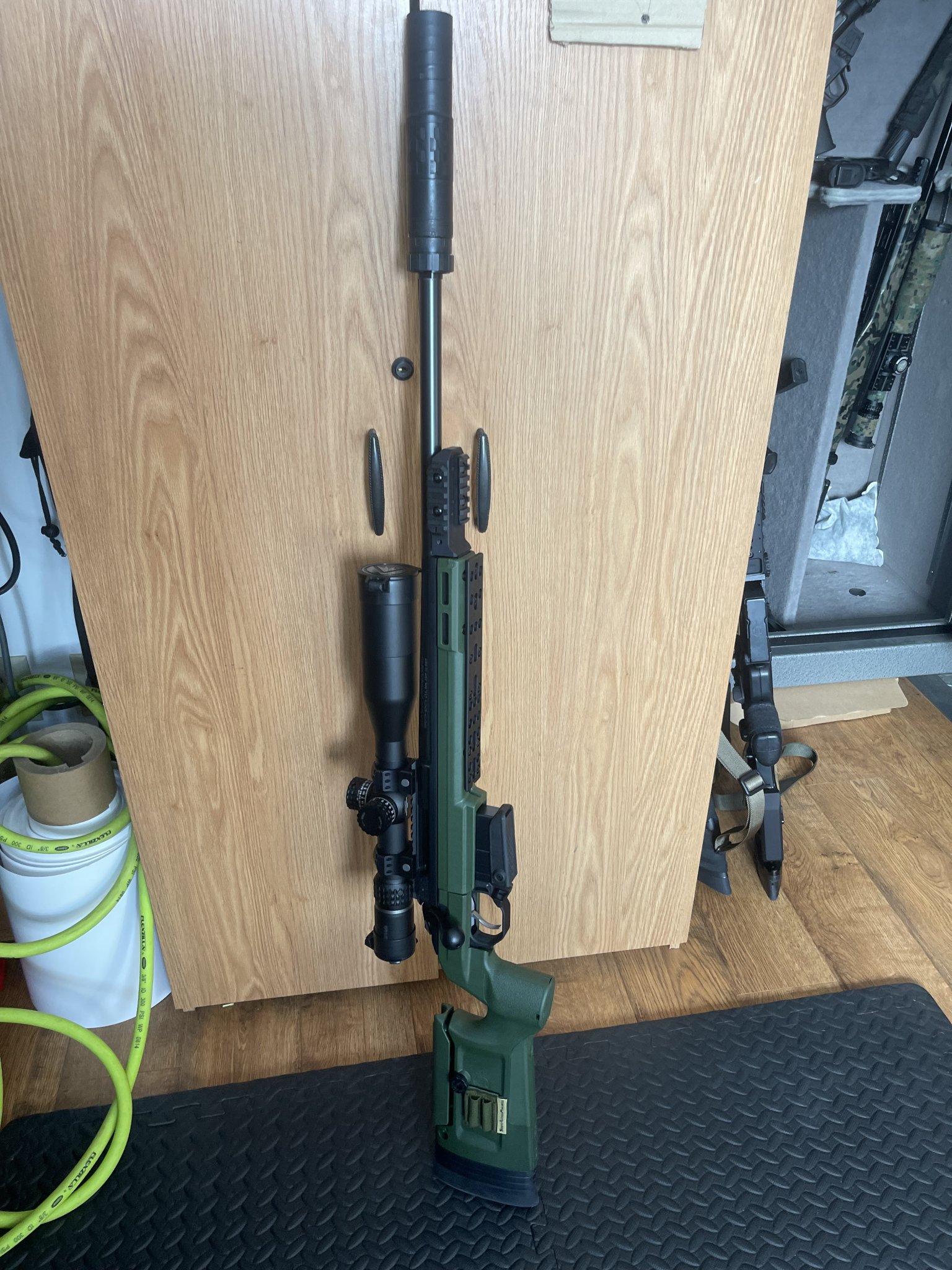

Tikka t3x in bravo chassis
Ryan Spivey
Jan 5, 2024
2
0
New Mexico
So I’m a bit dumb, when I got my tikka and stock it came with a CTR mag. But the chassis I ordered accepts AICS mags only. The chassis right handed but I milled out the left side cause I shoot lefty. I’ve read that the tikka can take both but I don’t know what mags work. I’ve tried 2 so far and the didn’t work/feed. If I could get help that’d be great

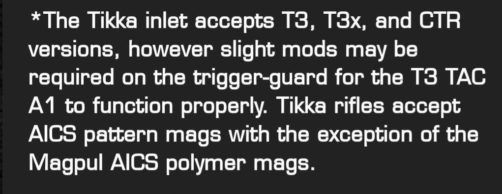

Reading is fundemental:
*The Tikka inlet accepts T3, T3x, and CTR versions, however slight mods may be required on the trigger-guard for the T3 TAC A1 to function properly. Tikka rifles accept AICS pattern mags with the exception of the Magpul AICS polymer mags.

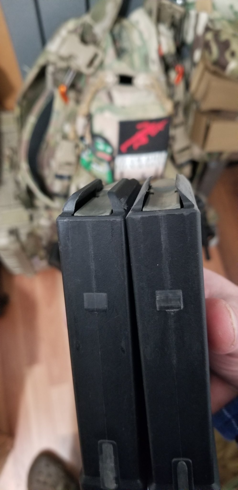

If you want the Magpul AICS mags to work in a Tikka KRG chassis, you have to do a considerable amount of grinding to the feed lips on the mag to get it to seat and feed properly. Still not the best approach in my opinion, but it does work...
Left is untouched, right is modified lips to fit in Tikka KRG.
After the mods, the mag still seats and feeds my Impact that sits in a Manners with PTG bottom metal.
