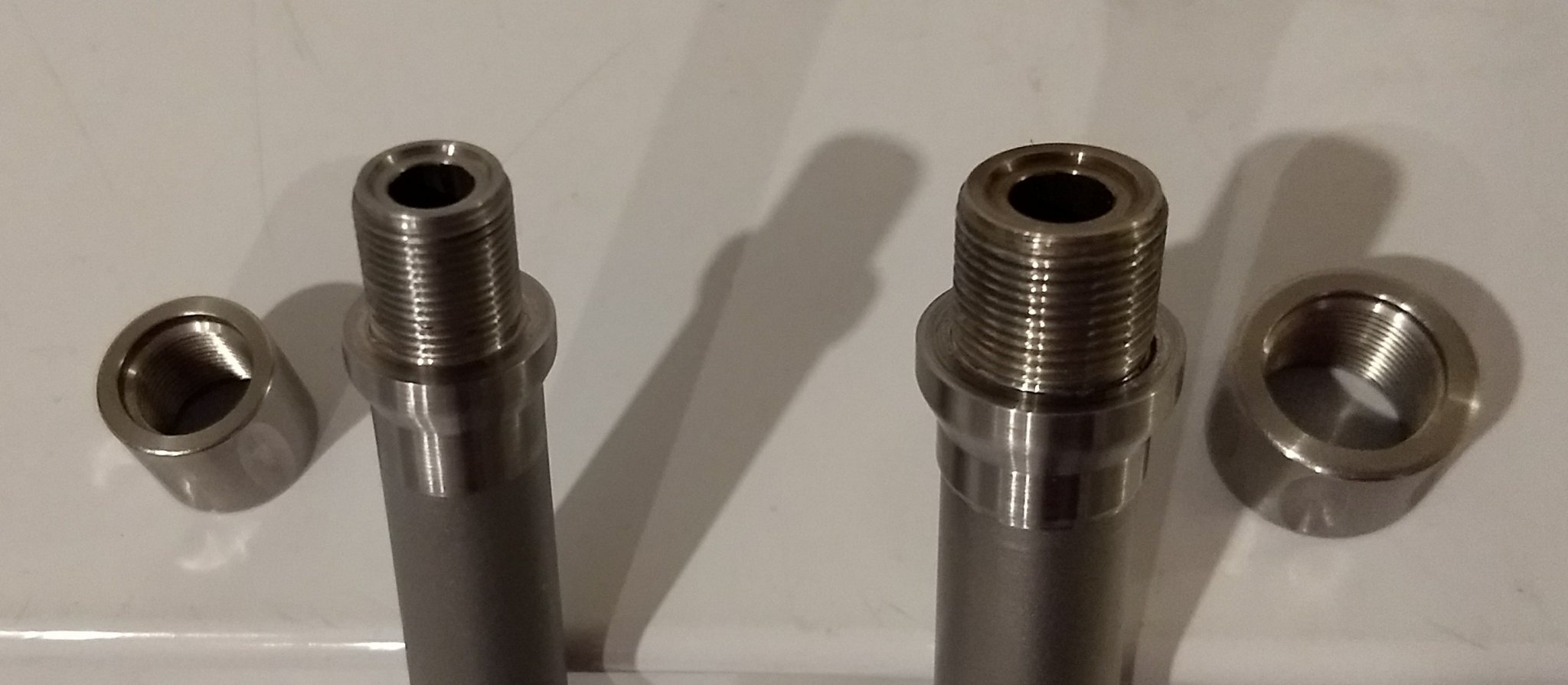

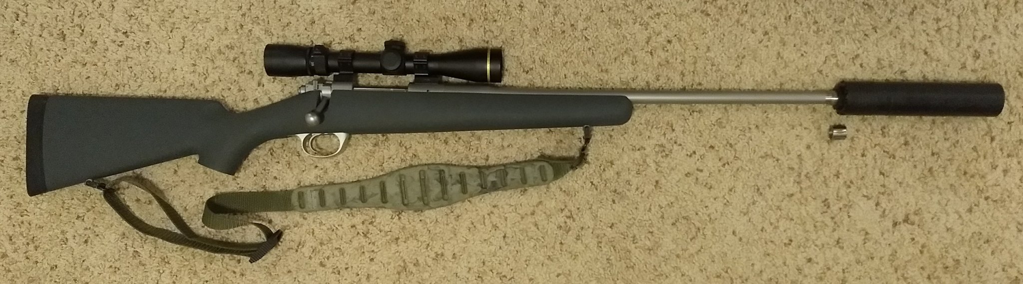

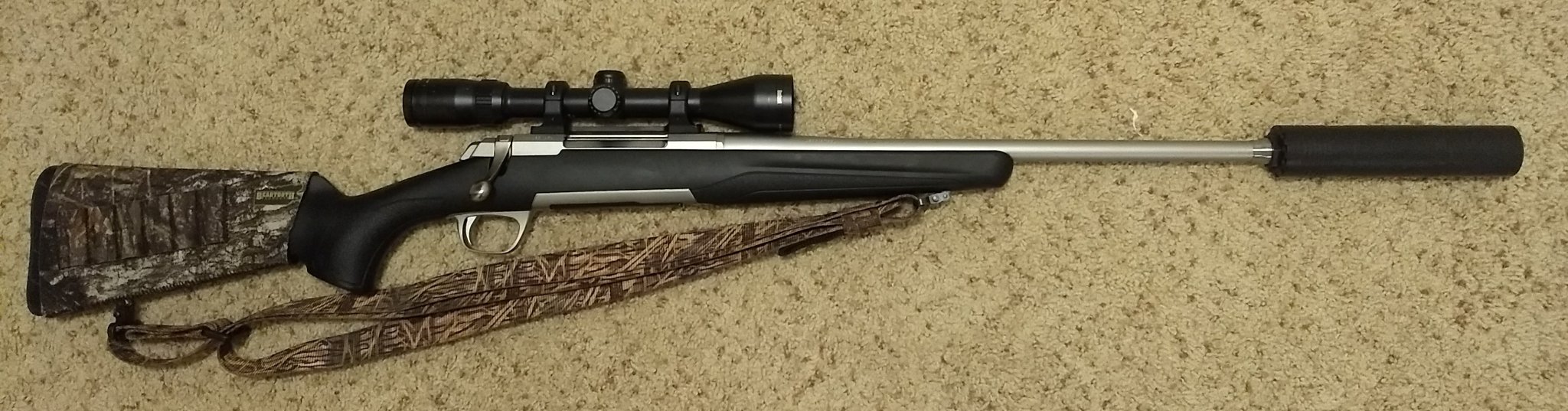

My .30-06 X-Bolt barrel was ~0.635" at 18", I had Ecco Machine chop it to 18.5" thread on and rocksett a collar, then turn it square to provide a generous shoulder. The 6.5 Kimber was similarly set up, but had to be threaded 1/2x28 due to the barrel profile. Works great and I plan on having the same thing done to any hunting rigs I pick up in the future. The generous shoulders keep DT cans snug, even through many miles of hiking. Might have my CTR done the same way, as they don't come with much of a shoulder and my cans have a tendency to loosen on that rifle.
6.5 on the left, .30-06 on the right.
18.5" barrel
20" barrel
The X-Bolt is a long action and the Kimber is a very compact short action, so they wound up being almost the exact same length overall.
