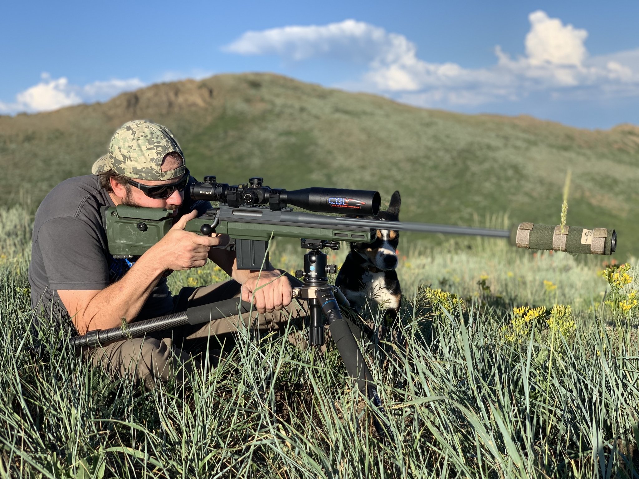

Stocks I considered when I built from a Tikka:
KRG Bravo/ W3. I ended up getting a Bravo and a W3 back end after seeing all of @viking78's work. They look like little Sako TRG's. I've been very happy with my W3 folder. The Bravo backbone and fore end is simpler than the W3 and the Gen 6 W3 folder is great. I also added a spigot and arca rail. This combo is a lb lighter than an MPA and a lb heavier than a bare Bravo. A bare Bravo weighs 3.5lbs.

I have been a Manners fan for the longest time; not a chassis fan ( just personal preference). I do however love the KRG Bravo. I have a custom action currently sitting in it. Yes, it is a chassis, but it feels more like a traditional stock to me. There are so many ways to customize the KRG Bravo and they continue to come out with new ideas.
As for barrels, you really cannot go wrong with any of the brands already recommended. I have a Proof stainless on my Tikka now (in a Manners T4A), a Proof stainless on my custom action, and a Bartlein on my other Tikka. I can’t shoot the name difference, they are all stupid accurate.
I will say this... my Tikka actions give up nothing to my $1400 custom action. Build with confidence, with Tikka.
My T3 in 25Creedmoor. Even with a 22" barrel it spanks most 6.5 CM's. The KRG Bravo is a great option.
