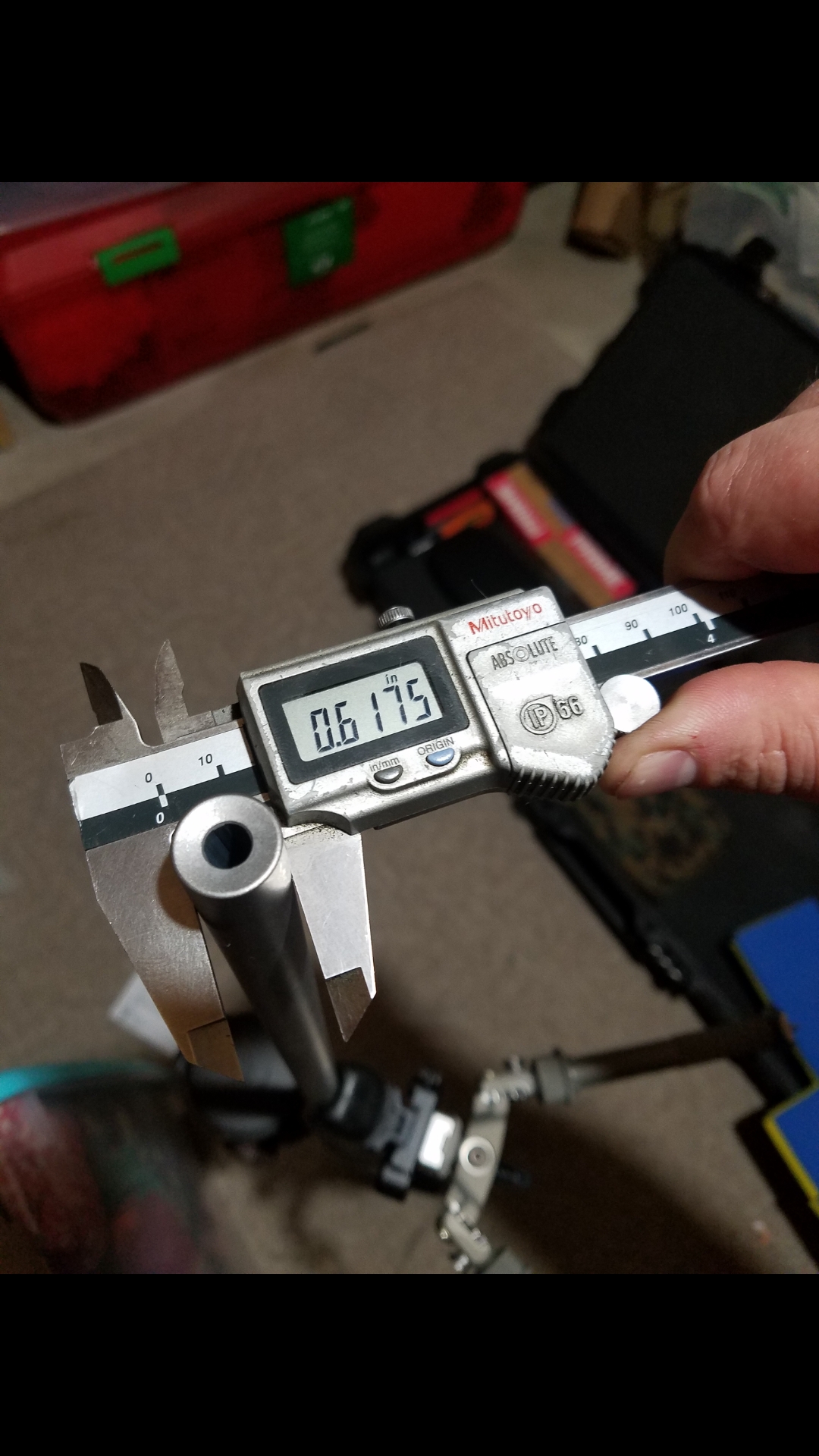

It matters if they make a face mount. Tikka lites with a 9/16 thread are a little small for a proper shoulder. Min recommended is 0.662 for shoulder.
To get that on my t3x lite stainless in 6.5 I would have to chop off at least 6". Measuring mine 0.600" back from muzzle I'm only getting 0.617".

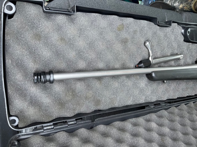

Ended up getting Griffin's 1/2-28 EZ Brake. They became available a couple weeks ago right as my tax stamp finally arrived at the dealer! This can was a super fast one with the exception of waiting on stamp back to the dealer. Purchased 7/13, check cashed 8/5, approved 12/15, stamp to dealer 2/5.
