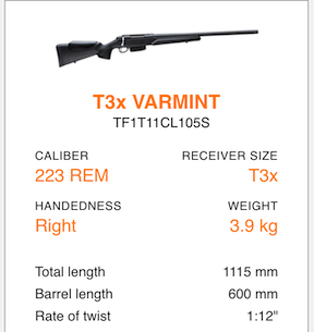

Its true in the sense that all fast-twist 223's are 8 not 7x ot 7.5x twist. TIkka does still make 12-twist Varmit models, eg

Tikka currently manufacture and sell 60 models chambered in .223 rem, and for many years imported 12 twist varmits to the USA. I think even in the super-varmit they may have originally imported 12 twist versions, since there are actual vamit hunters that want(ed) them.
Its very possible what they do in 2025 going forward is differnt than what they did historically, but a range of rifles is out in the fiels and on the used racks/gunbroker etc. Just something to keep in mind. There's no harm in caveating broad brush statements, that are a little too broad.
Neither of us (i'm sure) really want to read all to stupid TIkka p/ns to sort out the import/local SKUs...

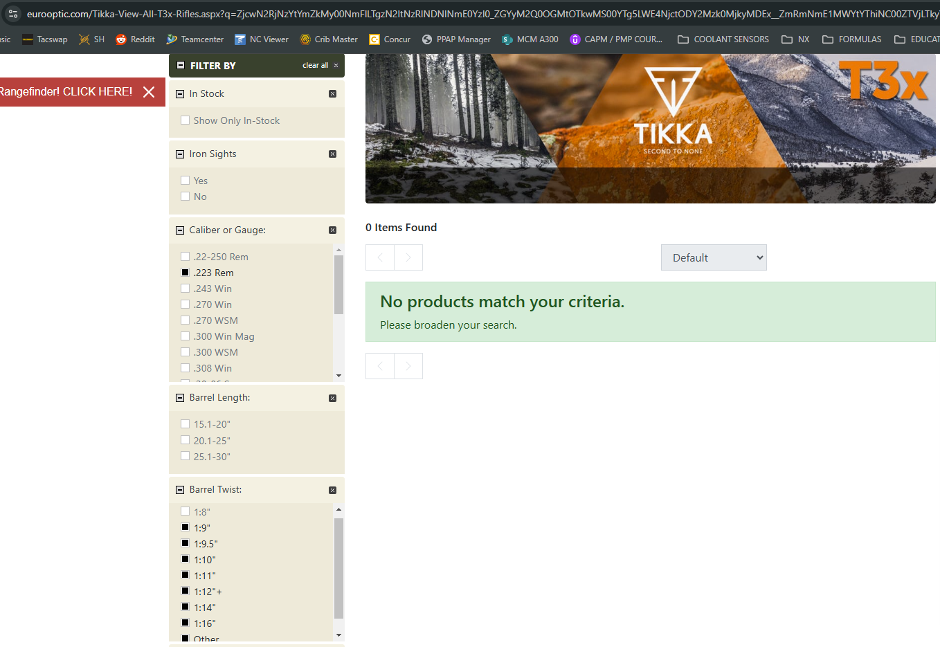

Well considering I’m looking at every Tikka sku as I type this I will disagree with you. Do you think I’m just pulling this info out of thin air? lol

I was just looking at EURO optic, Tikka Super Varmint, .223 … they look to be a 1-14. When I look on gun broker, they also look to be 1-14… so. I guess my knowledge of the Tikka sku is lacking. I own a CTR 223, 1-8, shoots great…. My other tikka 22-250 , 1-8. also shoots great,,, always good to learn..Thanks for the information, Charlie,,

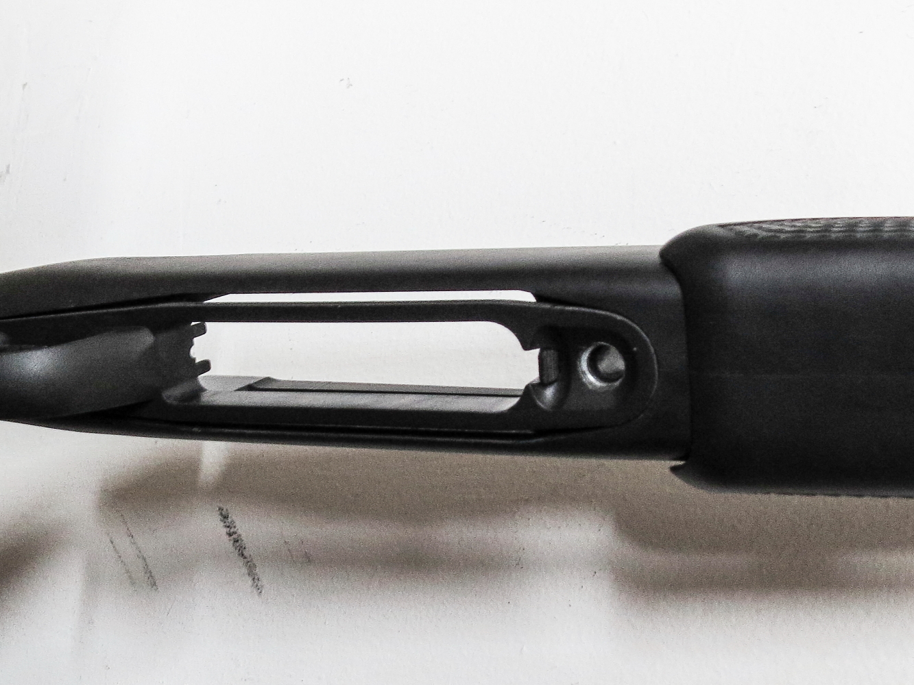

Unless Sako changed the design in the last year, the CTR and UPR bottom metal is wider than the Supervarmint. So you have to widen the recess of supervarmint, varmint and hunter stocks to fit the CTR bottom metal.
Getting a single-feed block sort of defeats the object of a magazine fed rifle. I do have one for when I'm sitting at a bench, but I would have loved the option to just drop an extra round in when the magazine empties. And the issue is only with the .223. I have no problem single feeding on the .308 supervarmint.

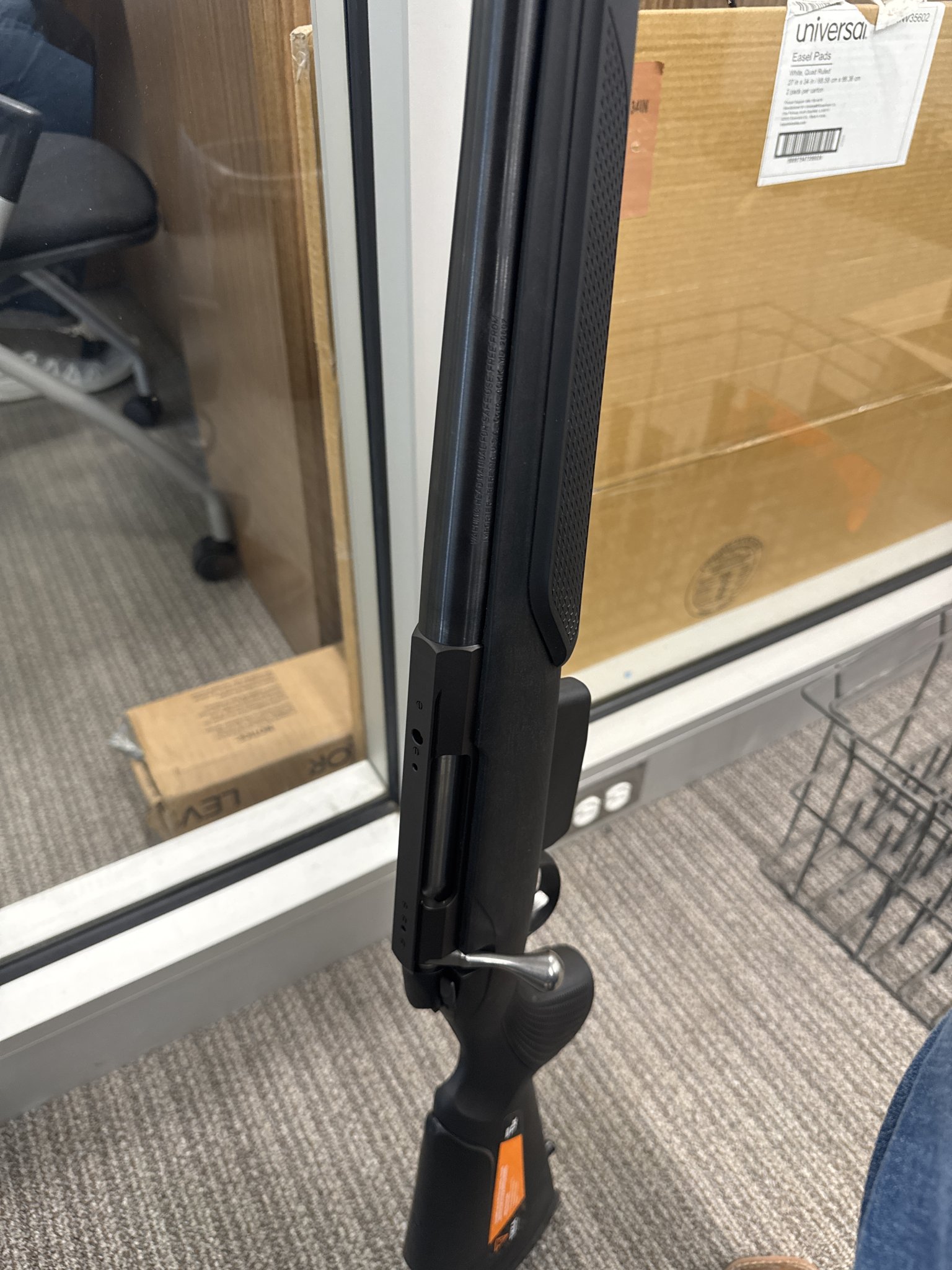

Well, again, the CTR and T3x and T1x use the EXACT same stock, so If you're having an issue its a one off. Tikka doesn't make a bunch of different parts for all of its guns. They use the same components over and over for different models. The CTR is literally just a different bottom metal, magazine and barrel profile than a T3x. Same triggers, same action, same bolt, same stock.
Listen, I'm not gonna continue arguing with you. People ask questions and I'm answering them with the factual information from Tikka/Sako because I KNOW as part of my job. But if you think you're right then so be it. Have a good one.
I said in the US. I have no visibility of Africa or any other nation.
Not sure why you would say something like this ? 100% the 22mm varmits wont fit in the t1x but they shoot fine from the CTR.

Unless the bottom metal design has changed recently, the Super Varmint vs CTR stock are different as the traditional Tikka bottom metal is a completely different shape than the CTR bottom metal.
Usually you can find someone selling a CTR stock with bottom metal on here easy enough, probably not likely to come with a 223 magazine though.
You can change over the adjustable cheek piece hardware if want, just need to drill a few holes in the butt.
Pretty sure I have a spare CTR stock with bottom metal if you want one
The t3x bottom metal will fit in a factory ctr stock with gaps on the sides but a ctr bottom metal absolutely 100% will not fit anything else with the standard t3/t3x plastic bottom metal
