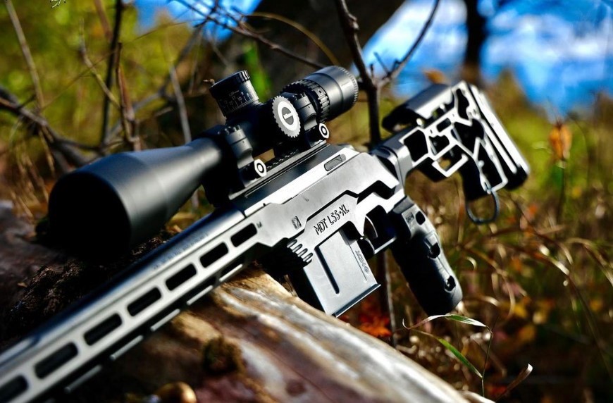

I have been shooting a Tikka T3X Roughtech chambered in 300WM and housed in an MDT LSS-XL chassis for a of couple seasons. I have used it on deer (overkill!) and moose. I love the accuracy in the chassis however it is 14lbs with scope. This lead me to the thought of trying the MDT HNT26 chassis. The HNT26 is quite pricey so I'd like to use it with multiple calibers which leads me to my ultimate goal; building a switch barrel Tikka in 6.5mm & 7mm PRC (and the original 300WM barrel).
My current plan is to spin on a prefit Proof CF Sendaro 24" 1:8T 7mm barrel (already ordered) and use that in my current MDT chassis with a 300WM 3.56" AICS MDT mag. I don't foresee any issues here as the bolt face is the same diameter and the case sizing is similar. Next will be to purchase a Proof CF Sendaro 22" 1:7.5T 6.5mm barrel (in stock) and try that out with my current mag and chassis. What I am concerned about is potential mag feeding issues when I spin on a 6.5mm barrel and try to use the same magazine. I intend to install a LRI Mag filler block for SA mag cartridges in the aforementioned MDT mag. This should prevent the round from getting stuck under the feed ramp of the action. I may have to modify the length and angle of the feed lips as well.

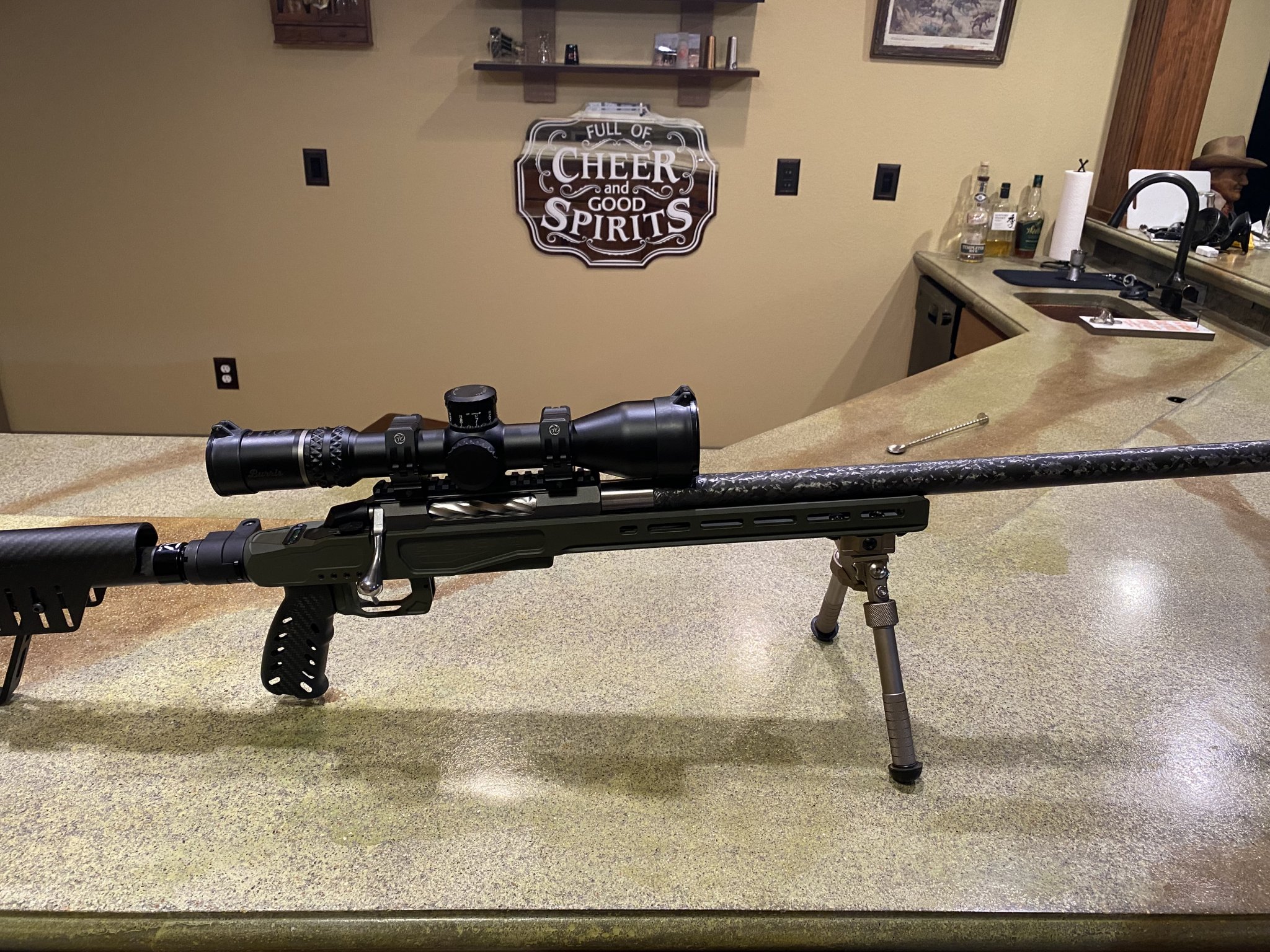

I’ve done this very thing other than I used XLR Element vs the HNT. The 6.5 prc feeds fine out of the 3.56” mdt mag. I’ll add that after spending time with the 7 prc the 6.5 seems kind of pointless.
That’s the exact information I wanted to know before pulling the trigger on a 6.5 barrel; thank you!

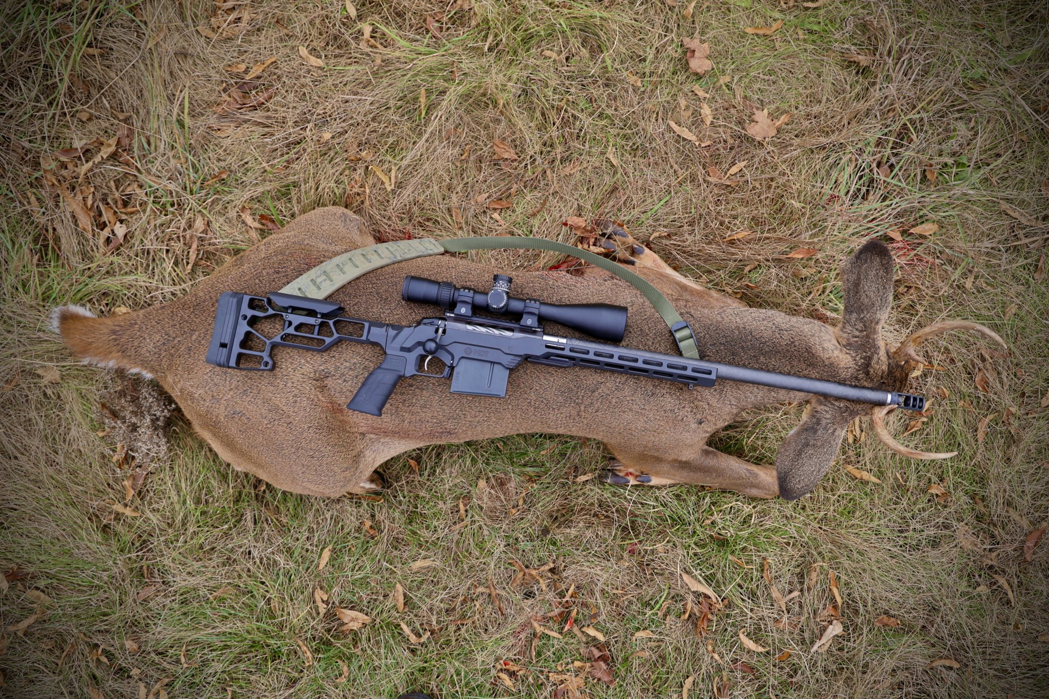

Thanks for all of the excellent input folks. I was able to spin on a 7PRC barrel and complete the Proof recommended barrel break in (regardless of if it‘s required or not) just prior to the local rifle season opener. It was instantly printing sub 0.5 MOA groups and I was confident enough to take it in the field. The 21st round down the barrel went through the boiler room of a small buck last week and I couldn’t be happier with the out of box accuracy. I have the 6.5 PRC barrel now too and can’t wait to give it a shot. If I get some time, I may try to make a short YouTube video about the simple build.
Here’s a picture of the setup:
