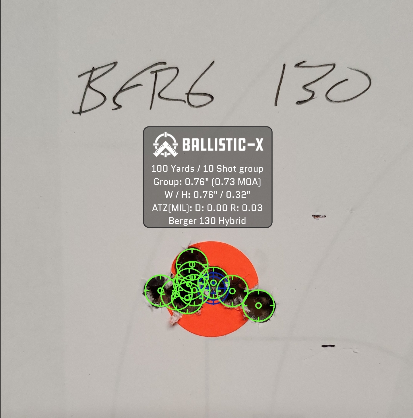

    For each brand of ammunition, I fired one group of ten shots with my magnetospeed attached to get all the good velocity data (avg. Velocity, SD, ES).

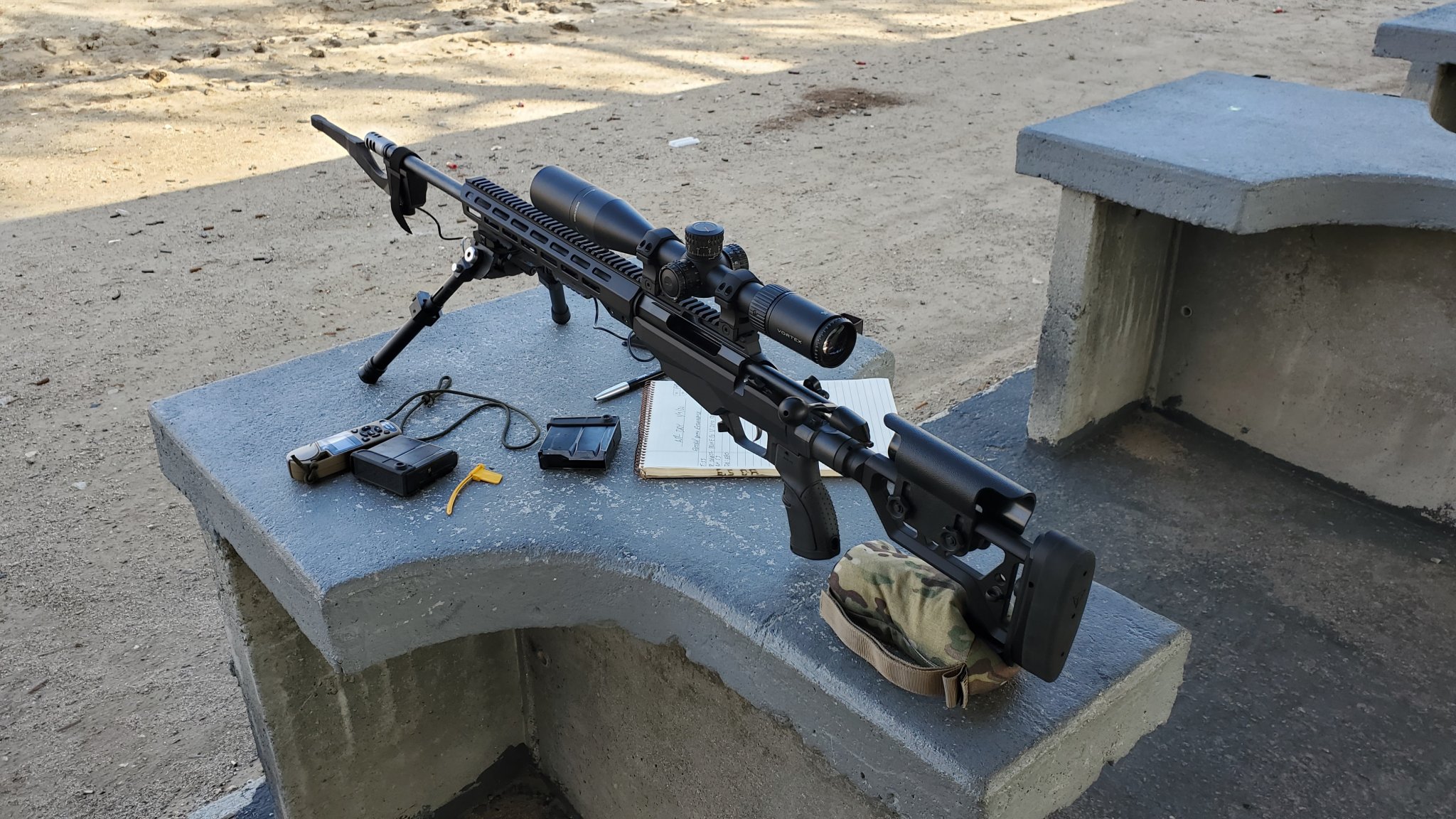

    Here's my setup: Tikka T3x Tac A1, 6.5 Creedmoor, Vortex Viper PST Gen II 3-16x44, EBR-2c Mil/Mil

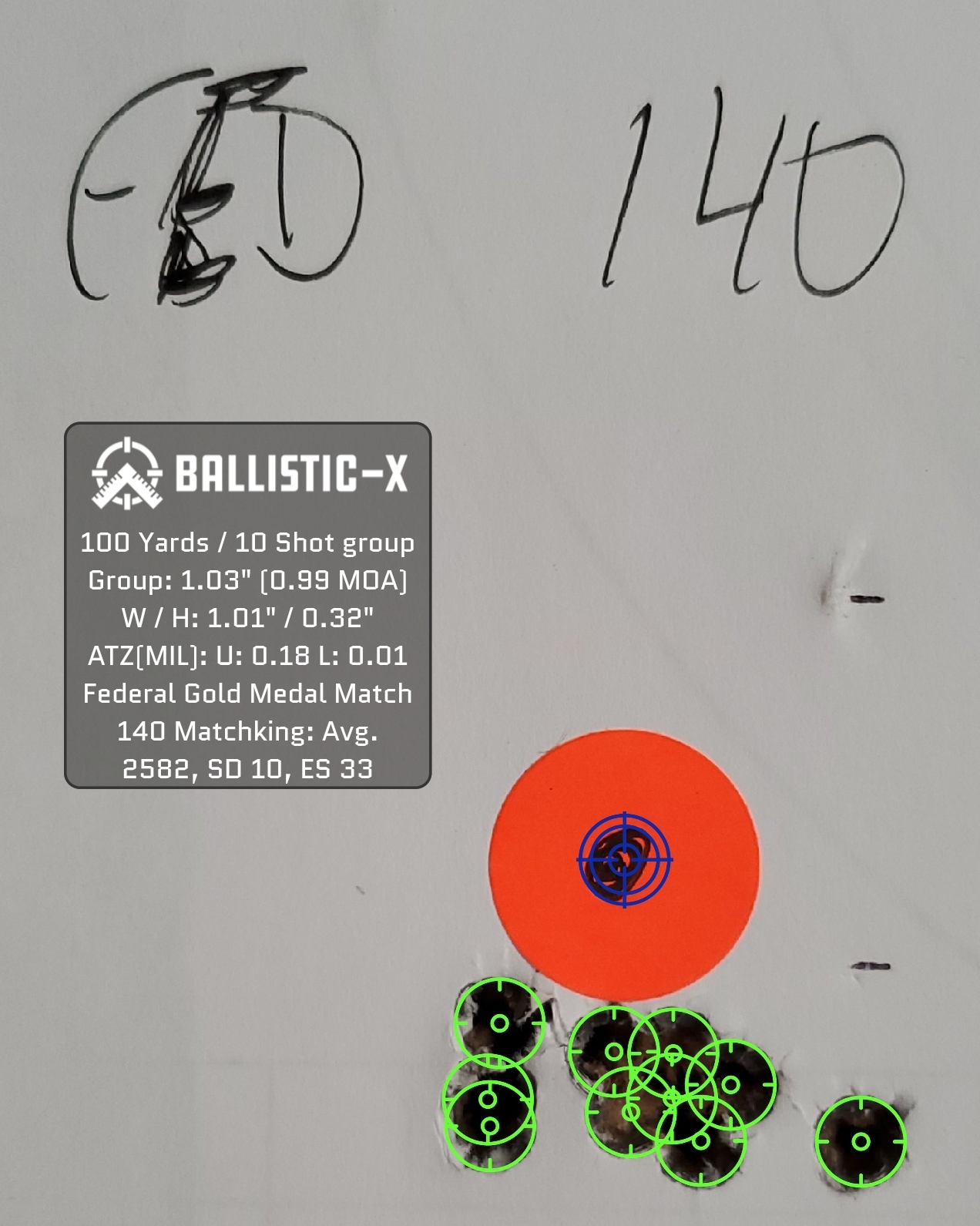

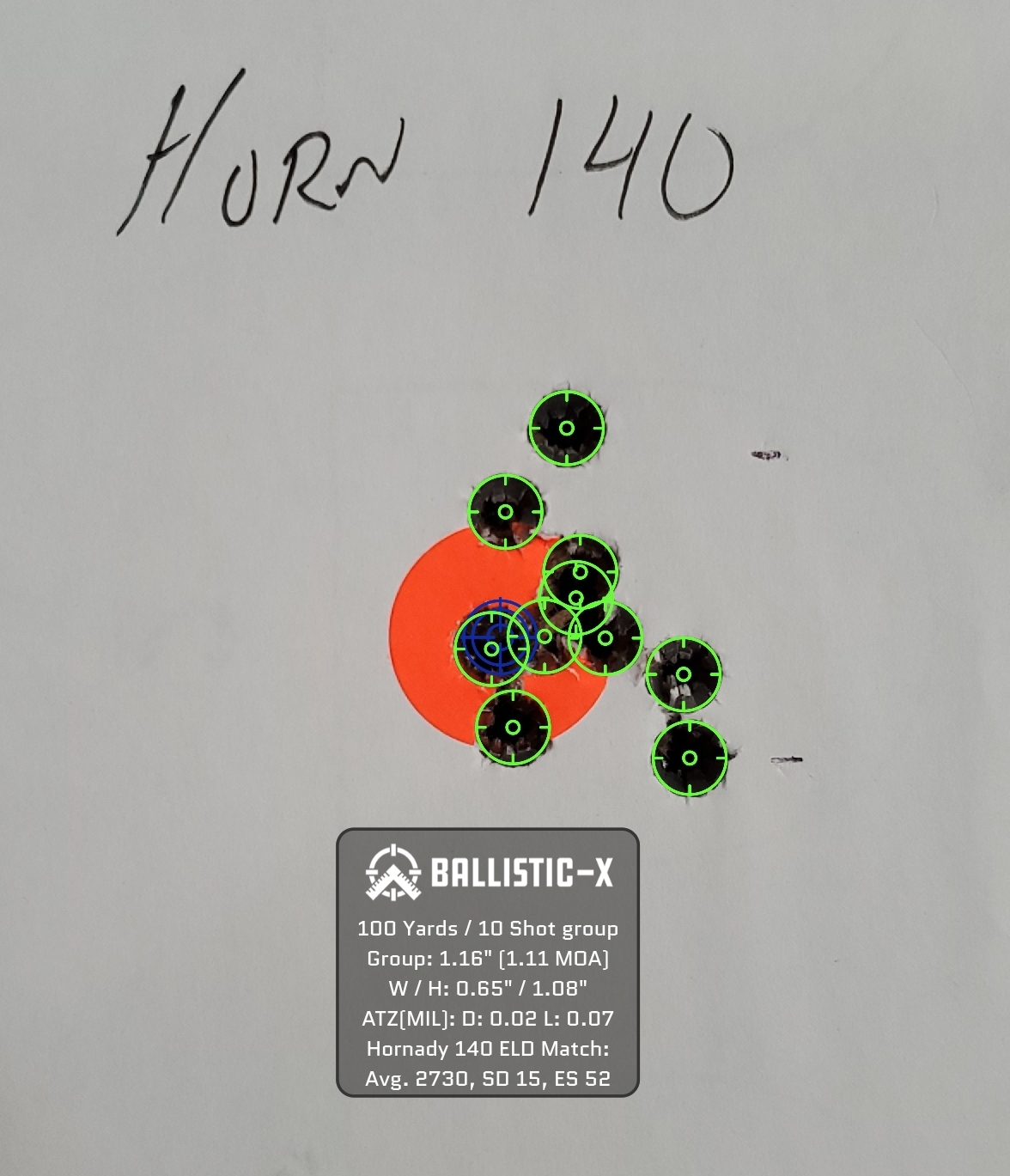

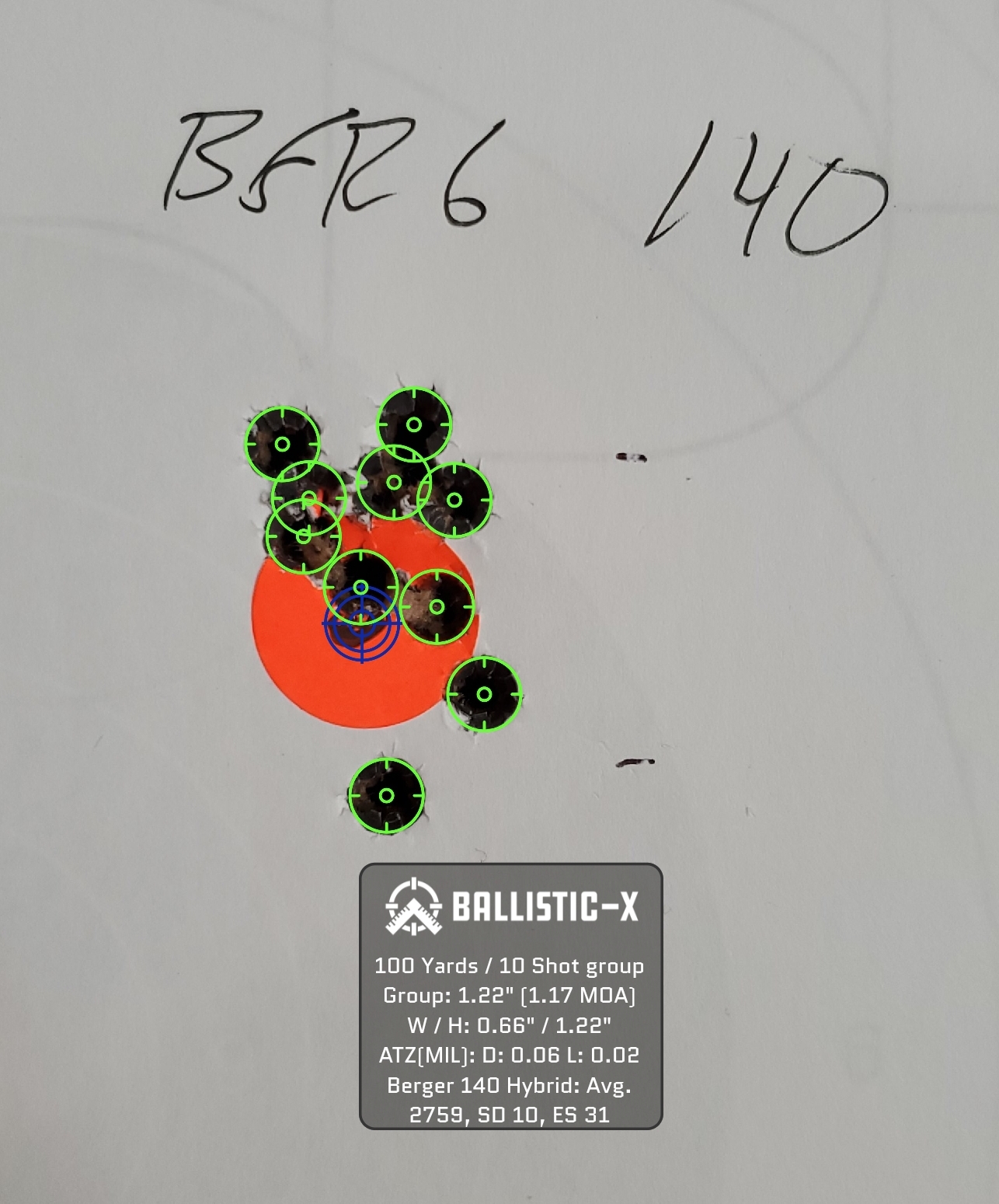

    One 10-shot group for each brand of ammo down the pipe. Velocity, SD's, and ES's are on the Ballistic-X label. Enjoy.

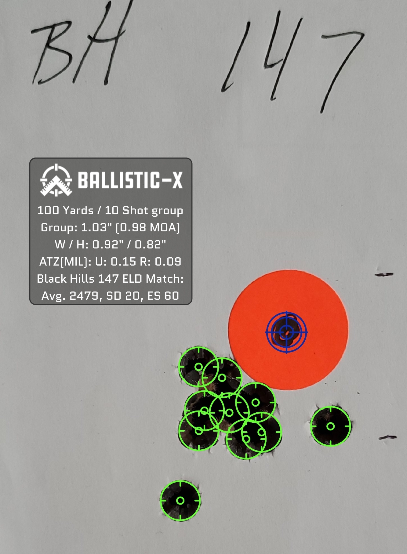

    Black Hills Gold Hornady 147 ELD-M:
    OAL: 2.772"
    Base to Ogive: 2.132"
    Powder: 41.42 (41.48, 41.54, 41.52, 41.42, 41.12)
    Large Rifle Primer (and crimped ? )

    2810, SD 13, ES 39. The BC on the box is absolutely correct. I transitioned immediately to 600 and everything was point of aim-point of impact. That's the first time that's ever happened to me with the BC provided by the manufacturer. Go Berger!

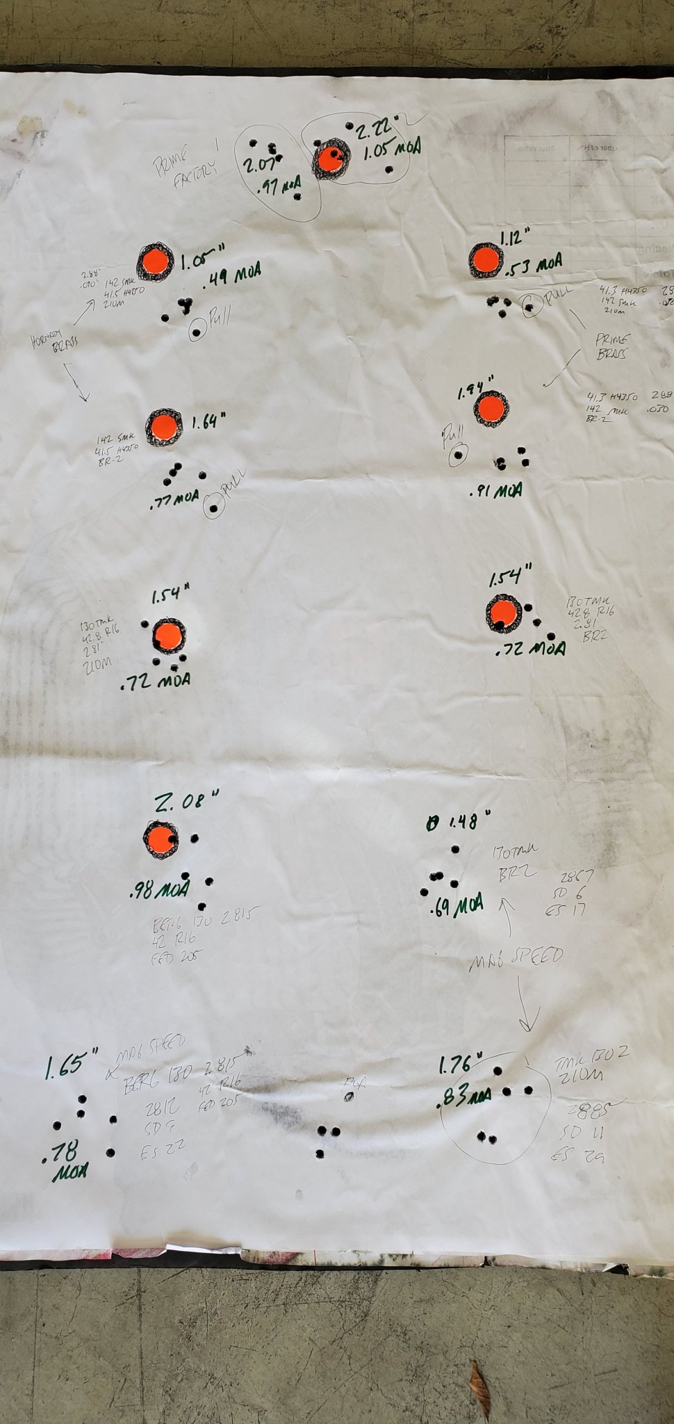

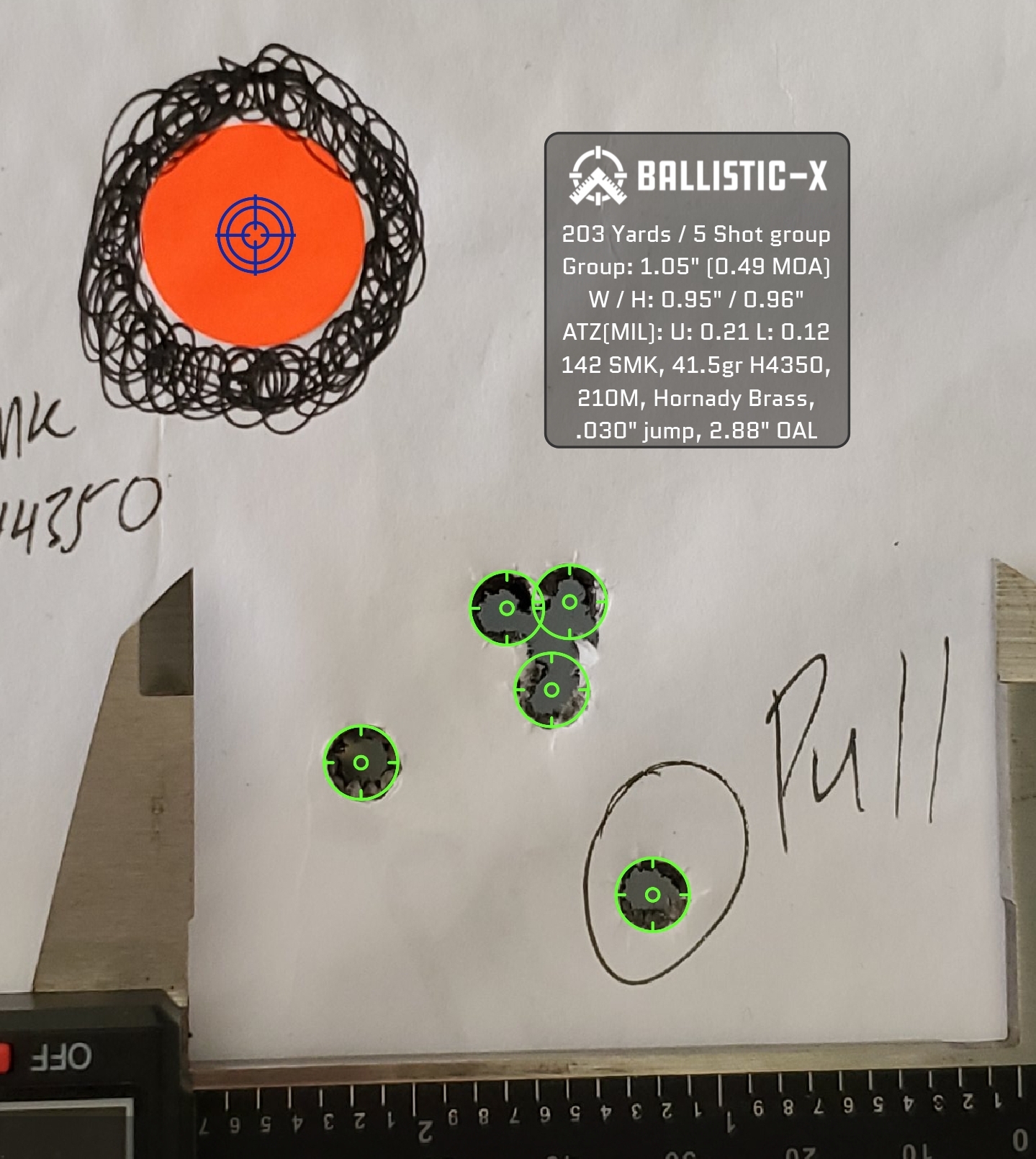

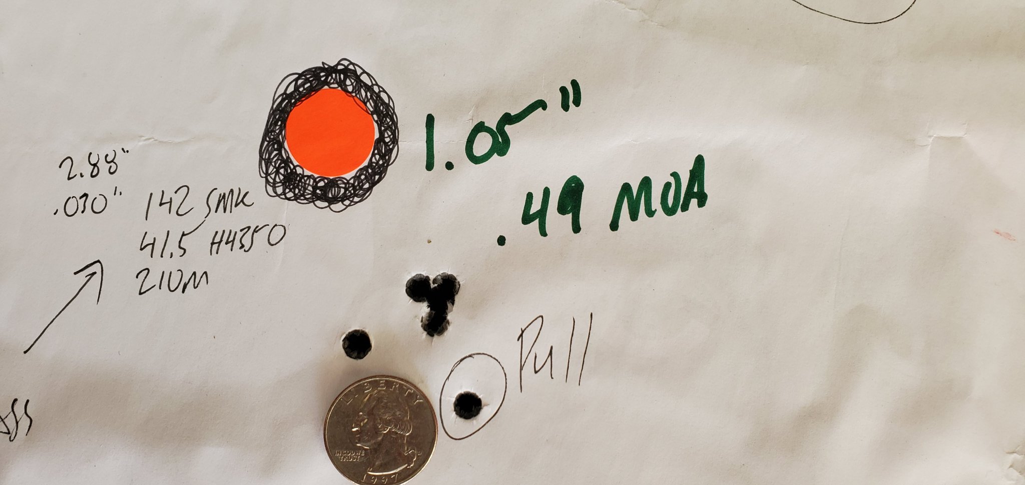

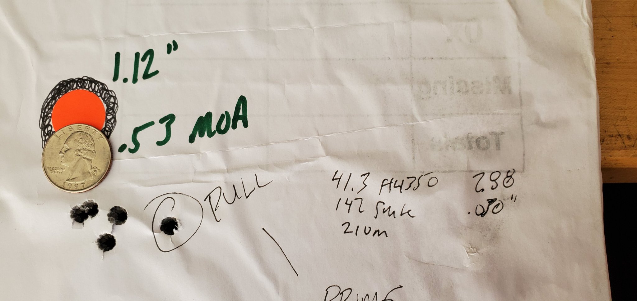

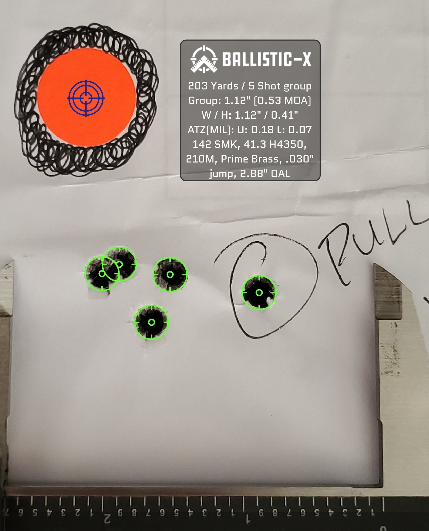

    Overall, a clear and sunny day. Ideal for poking holes in paper to see what my new shiny Sierra 142 grain pointed Matchkings, my 130 Berger Hybrid with 42 of Reloder 16, and Sierra 130 Tipped Matchkings would do....
    Looks like .030" jump (2.88" OAL) and 41.3 of H4350 on Prime/Norma brass, and 41.5 in Hornady brass does well with either Federal 210M or CCI BR-2 primers..... if I could just stop pulling that 1 shot per group, things would be just so much better!
    Got the seating depth test rounds loaded for... maybe tomorrow if I can swing it. 10 rounds of each depth. 5 for a group no magnetospeed, 5 with magnetospeed mounted to the barrel to see if there's a difference in group size (there's always a point of impact shift of 0.6 mils up with this rifle)....

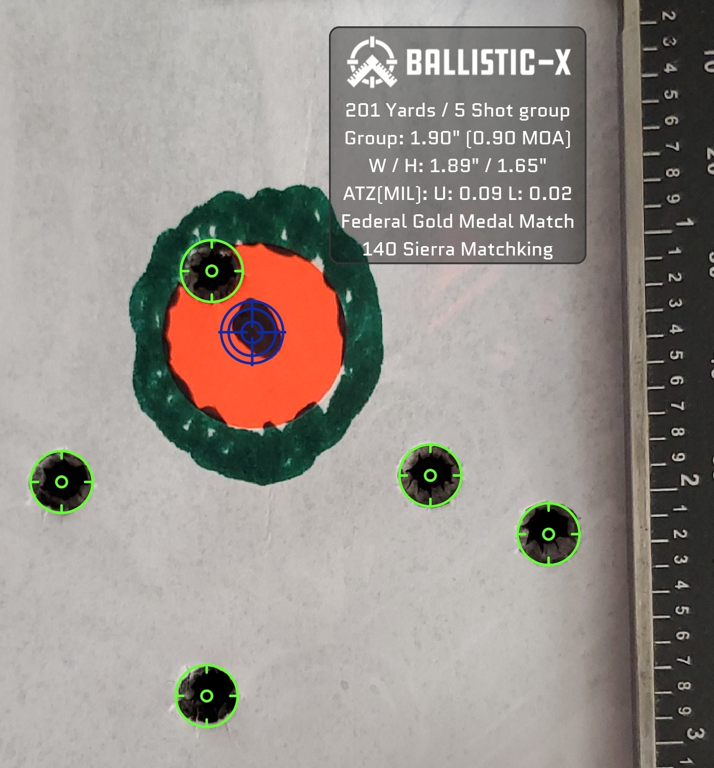

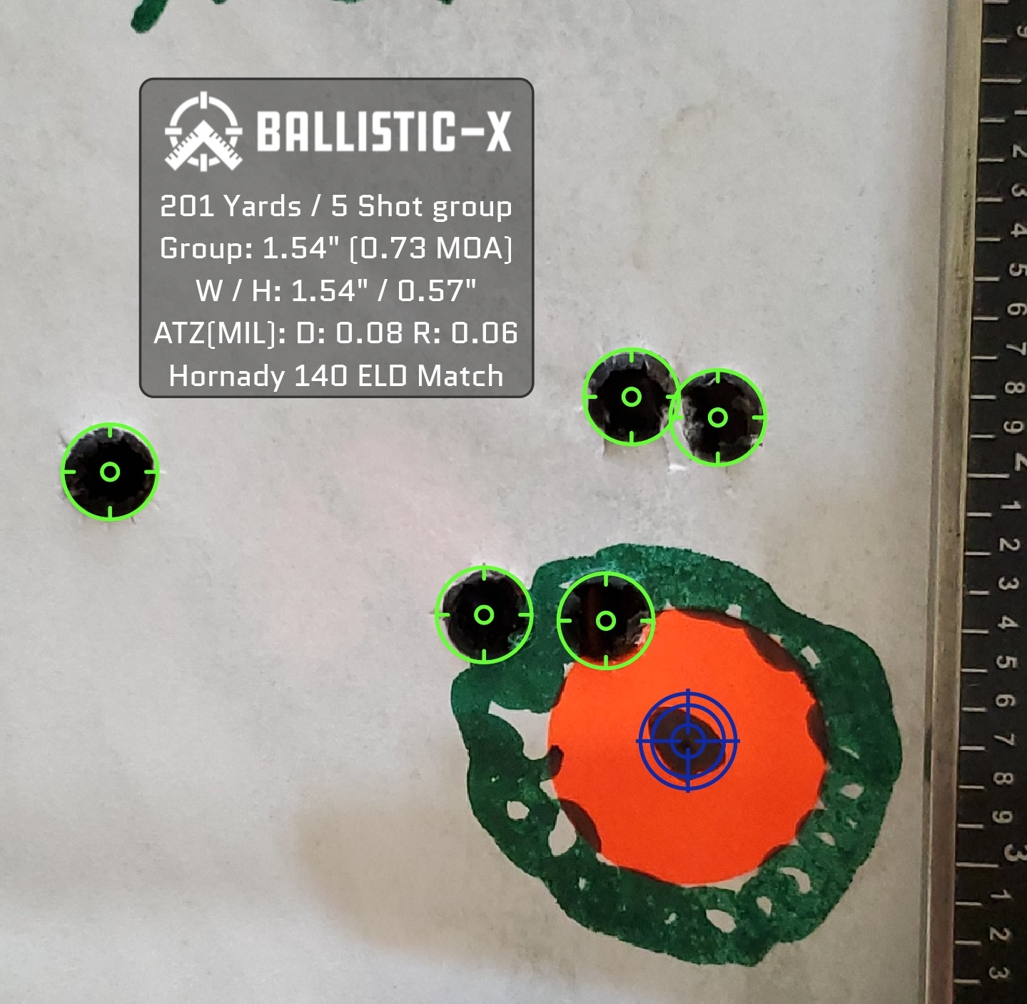

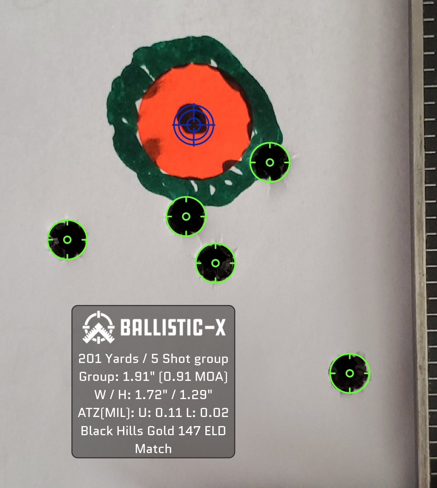

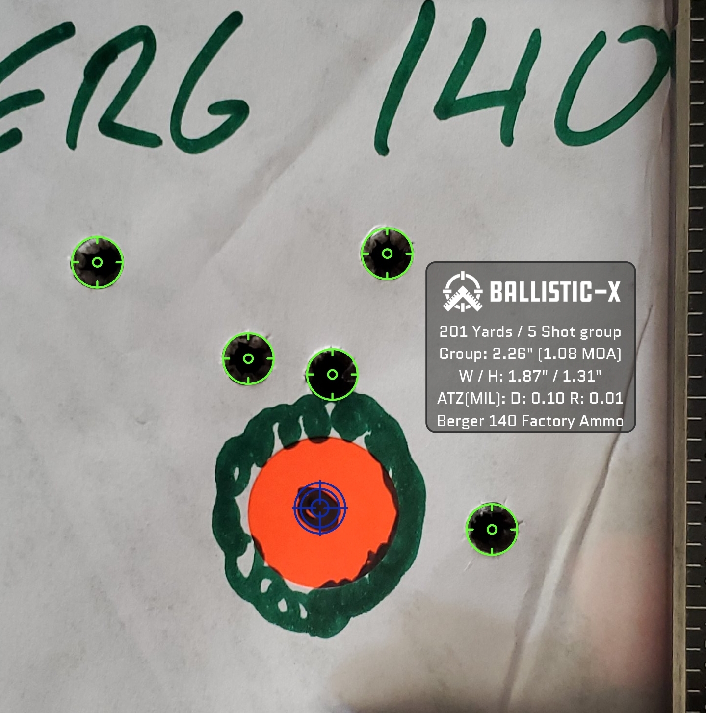

    Shot the Berger 140, Hornady 140 ELD Match, Federal Gold Medal 140 Matchking, and Black Hills Gold 147 at 201 yards today. No magnetospeed attached.
    Temperature: 51f
    Density Altitude: 4950
    Relative Humidity: 35%
    Station Pressure: 25.46
    Winds: 3-6mph, gusts up to 12 from 4-6 o'clock.
    Berger 140:
    Hornady 140:
    Federal Gold Medal 140 Matchking:
    Black Hills Gold 147 ELD Match:

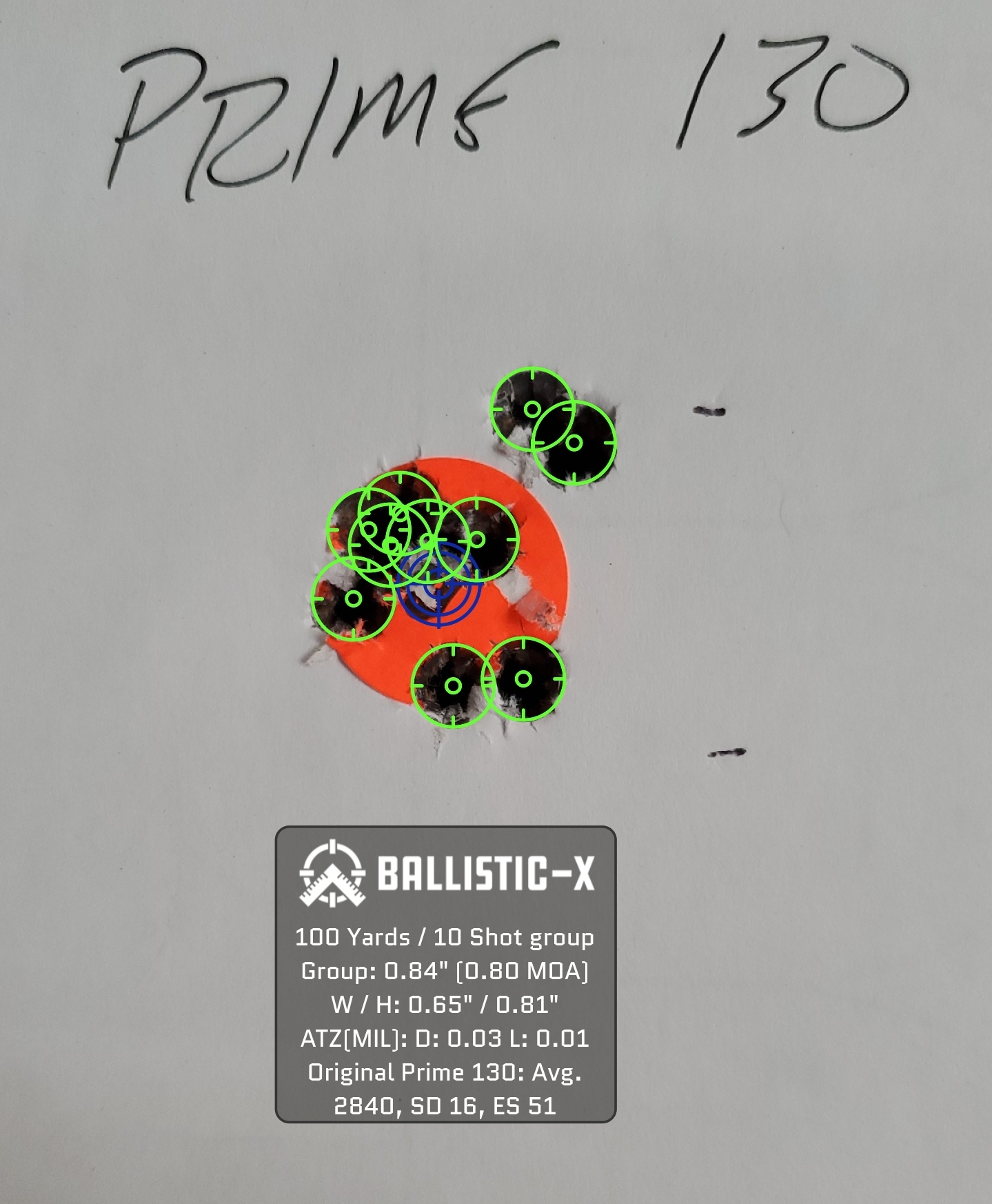

    What's interesting is all the factory stuff seems to be a little slow, but nothing too crazy. But my 142 SMK load with 41.5 H4350 was running at 2740 or so out of my Proof Research 24" barrel, and its running at 2725 out of this Tikka.
    Another example, original Prime 130 was usually about 2915 out of my Proof, but its 2840 out of this Tikka.
    @Cheeseburger1976 this is the old Prime Ammo from 3 or so years ago.
