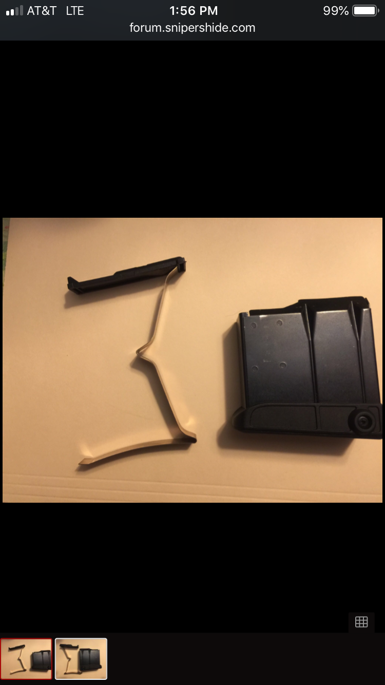

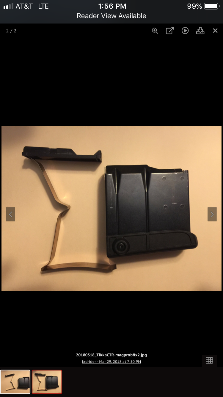

    Make your spring look like this. All your problems will go away. Use pliers and it takes 60 seconds. These pics are from another member here.

    Post a picture of yours. I have never seen them look like the picture. Its not necessarily a pressure thing in itself. The stock bend does not put pressure in the correct way.
    if they are bent like the photo I posted, they will work without fail.

    The bottom leaf and the follower need to be parallel to each other like the picture. All the mags I had, the follower was tilted at an angle not in relation to the bottom leaf. Needle nose Pliers make the adjustments easy. Pulling on the spring probably wont get it done.
