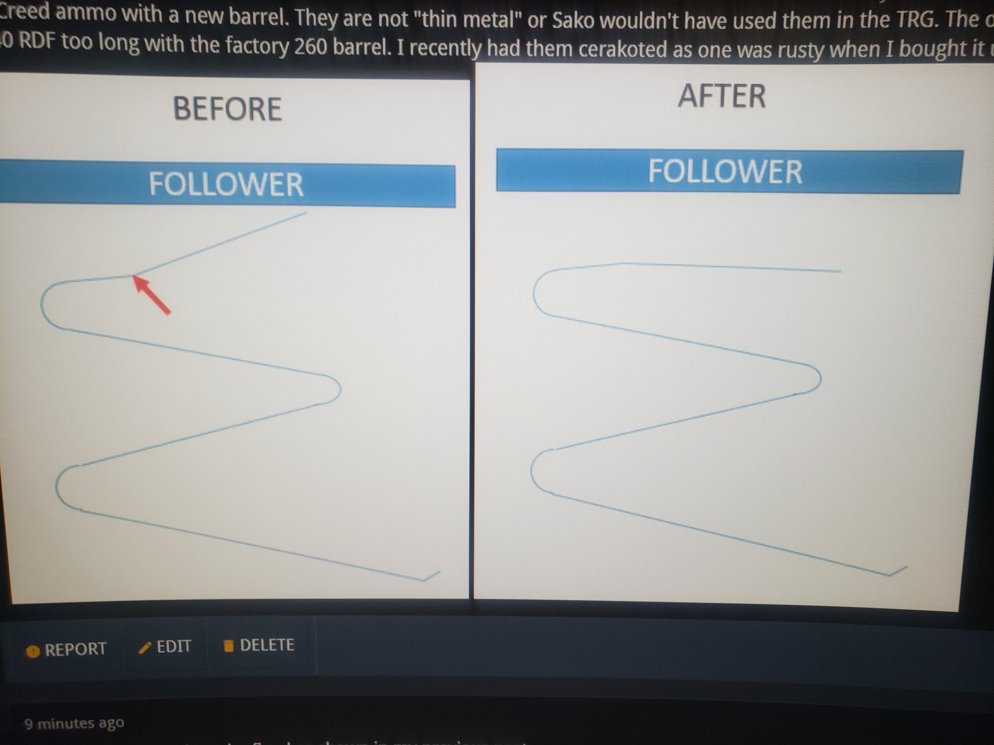

    Try this with the spring in your Tikka magazines before you give up on them.

    Thanks for the pic on the mag spring mod. I'll give it a try. A lot easier than buying a different chassis and new mags for it.

    I've been considering the same thing for my Tikka Tac A1 due to the magazine issue screwing me over on a few stages at my last 2 PRS matches. I tried the spring fix on all 3 of my magazines and I think it did the trick. I ran each mag fully loaded 2 or 3 times and didn't have any more failures to feed.
    My plan: I"m going to run my Tikka Tac A1 as it is for a few more matches and if the problem is solved I may just leave it as is, HOWEVER, if I run into more issues with the magazine system and feeding I think I'm going to go with a MPA chassis. They seem to have all the bells and whistles, folding stock option, not to mention that they're the most common chassis system in PRS.
    Just an update - I tried the Tikka CTR magazine spring fix that I found here on SnipersHide. After tweaking the springs on all my mags, I haven't had a single issue feeding. I decided to keep the Tac A1 chassis and added a 419 Arca rail and a few other upgrades and it ran like a champ the rest of the PRS season.
