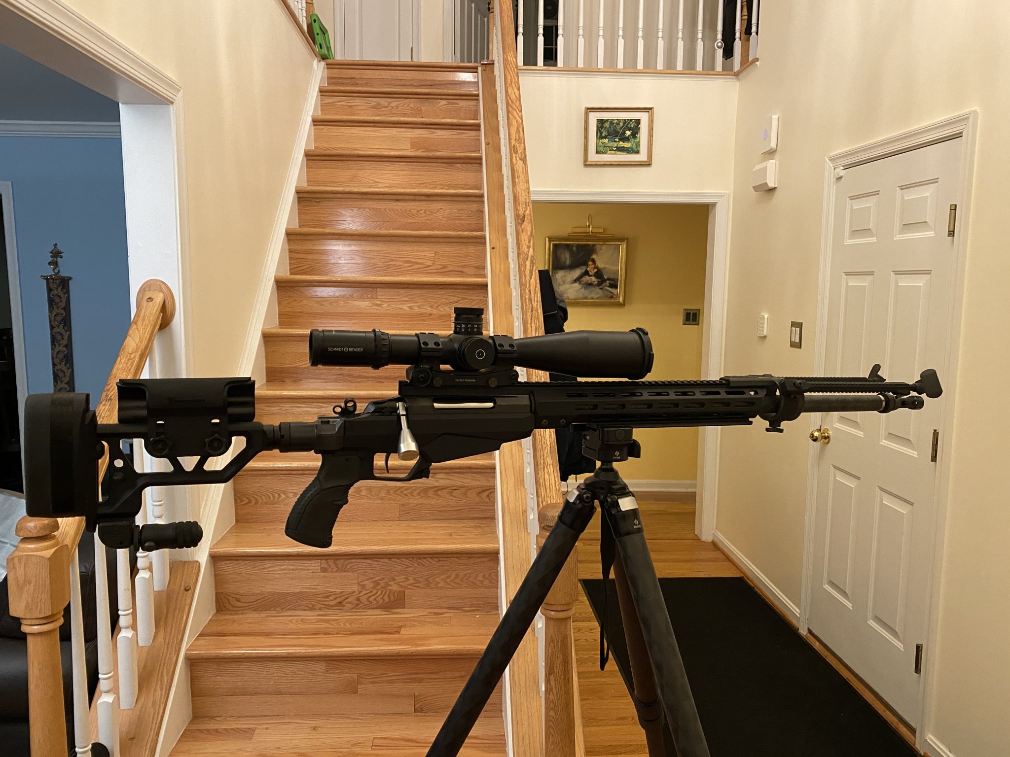

    Who here has experience with the Tikka T3X TAC A1?
    Strange issue:
    When to Frank's and Mark's PRS course in PA early in the week. (It was great and you should sign up it if you haven't taken it.)
    On the second day we shot 600-1000 yards, and my 6.5CM T3X TAC shots great. No shit, it was awesome.
    In the afternoon we were to shoot for correction data for our dope cards. However, I kept shooting the berm between the various 100 yard increments. (WTF?)
    I can not, for the life of me, figure out what the hell is going on!

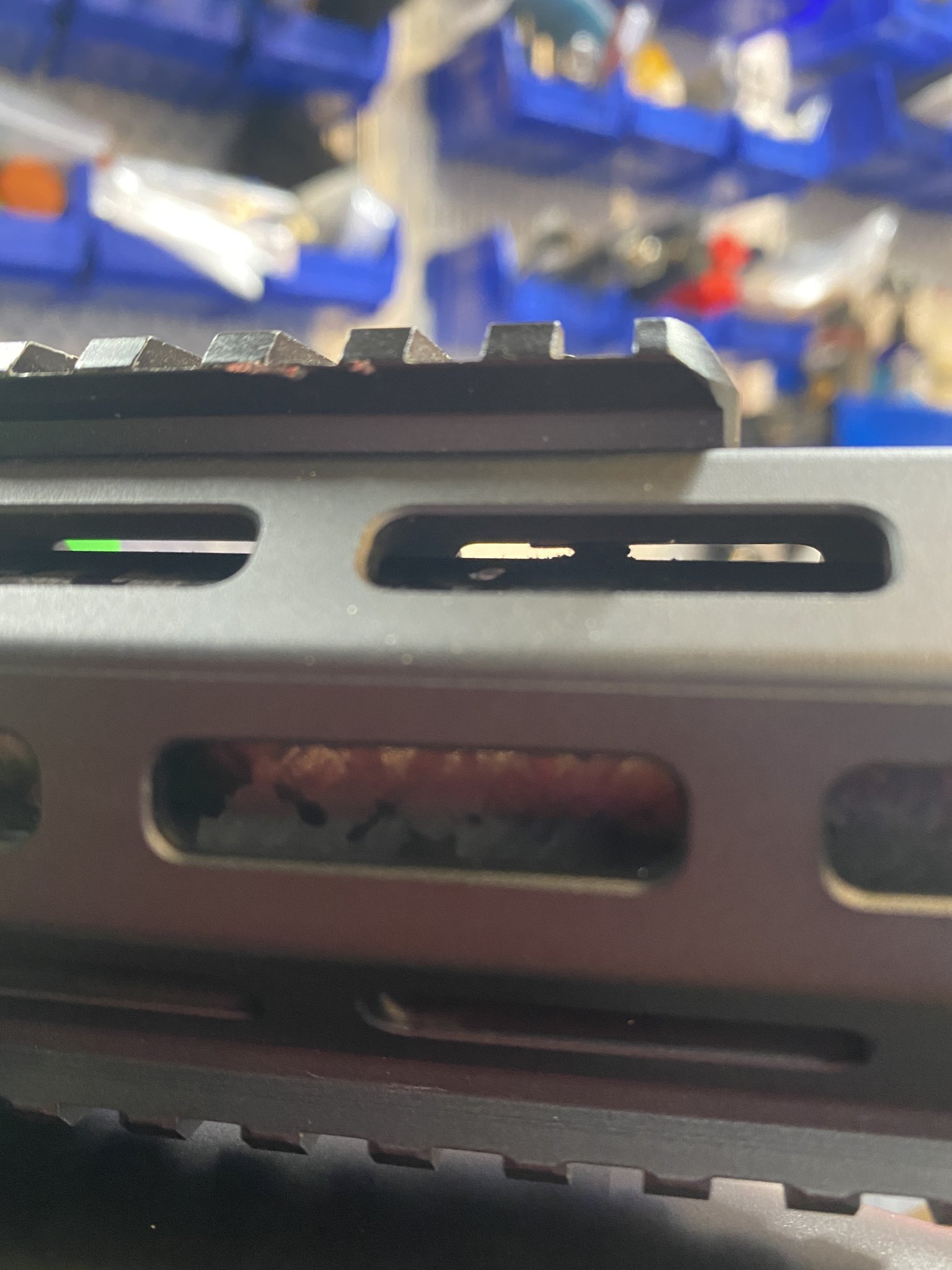

    I did resight the rifle today, and found out that it is 6 mils low. ...but there is NOTHING obviously wrong with it.
    Rifle configuration:
    - Tikka T3X TAC A1 in 6.5CM (gotta love the man bun)
    - S&B 5-25x566 PM II (backup 4-16x56 PM II UltraClear)
    - EGW 20 MOA rail
    - Proof CF drop in TAC A1 barrel (~220 rounds)
    - Elite Iron (pic rail)
    -YHM 30 cal phantom
    Testing performed:
    - Put on the backup scope and checked the zero. Shoots exactly like the primary - 6 mils low
    - Swapped out the suppressor with it's backup, shoots in exactly the same spot
    - Cleaned the carbon out of the barrel, and borescoped it - No signs of copper buildup
    - Windage had not really moved
    - Nothing on the rifle is obviously loose or moved
    Help!

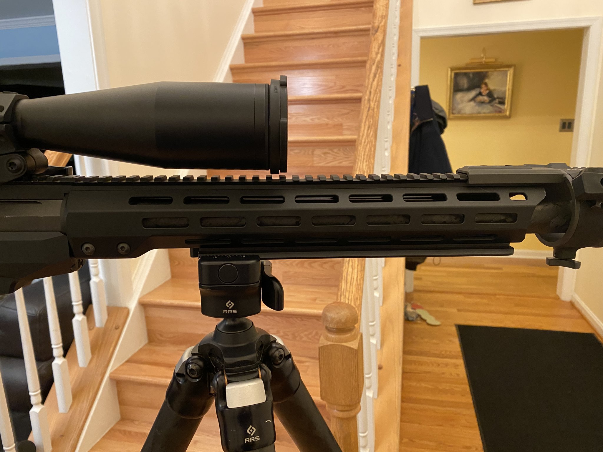

    Did that... and it's kinda odd. Zeros fine.
    I'd agree on the turret prank, but I used the backup scope to rezero... and they've both got the same issues.
    6 mils is alot.
    My first thought was that I'd left to zero stop too loose, but that doesn't seem to be the case. (Given that the backup scope had the same issue, and it was locked in my trunk! ;)
    Yeah man, I cant think of anything else. After you re-zero I'd probably re-check how much elevation you have left. Idk. I got nothin.
    I have 2 Tikkas. One has 20moa rail, one does not. The only issue is obviously moving a scope from one to another and being off by..... roughly 6 mils.
    Only thing I can think of would be somewhere between the reciever and the muzzle. Any chance the barrel got hit, action moved in chasis, pressure on the barrel somewhere, change to weight of suppressor or is it now mounting differently.
    If nothing changed between scope and reciever, it has to be the other side.

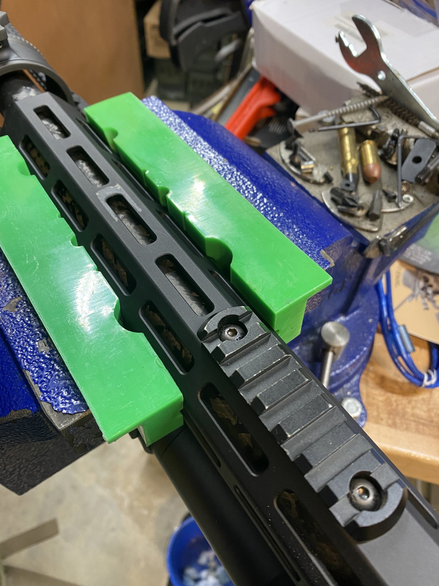

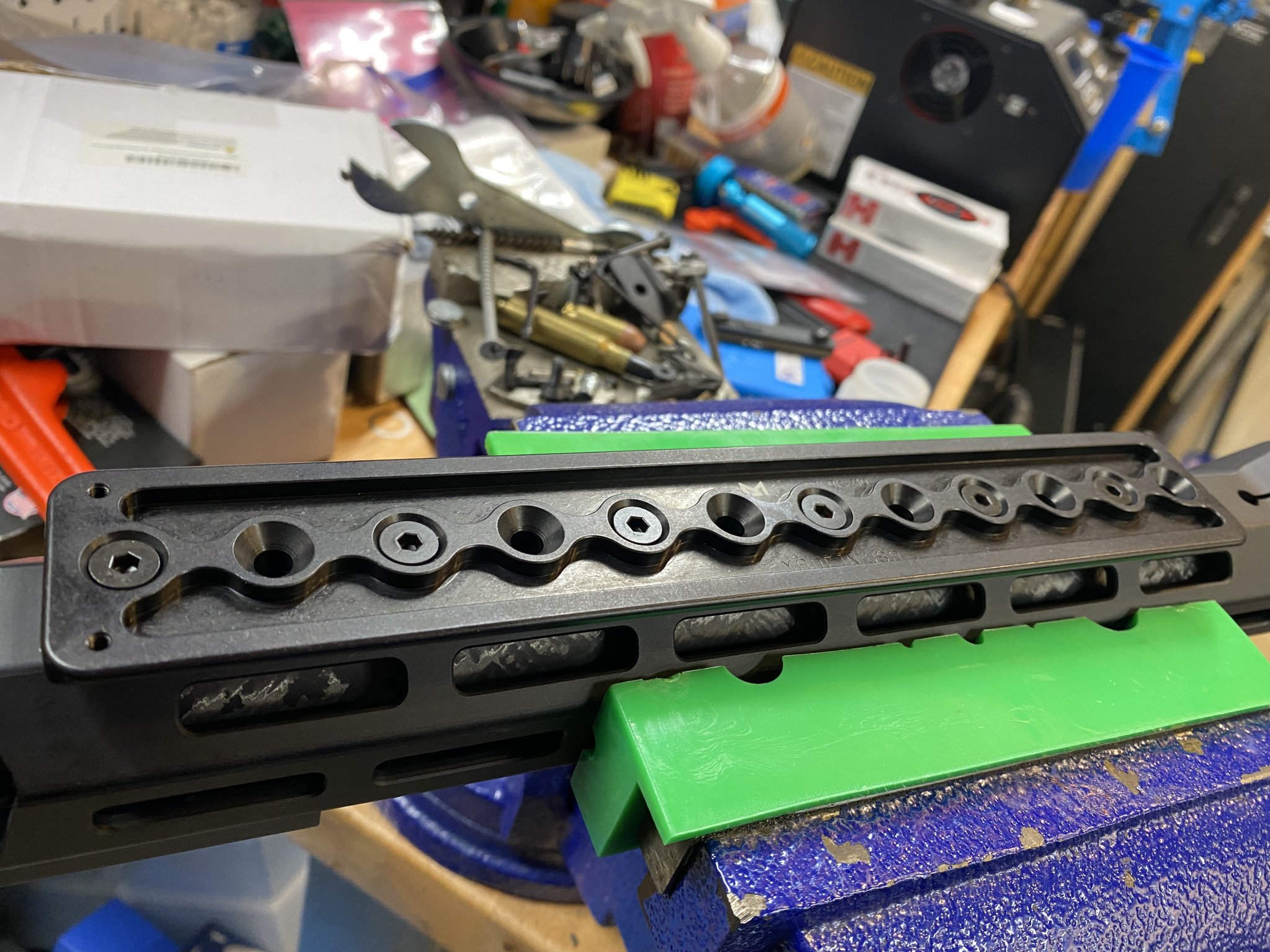

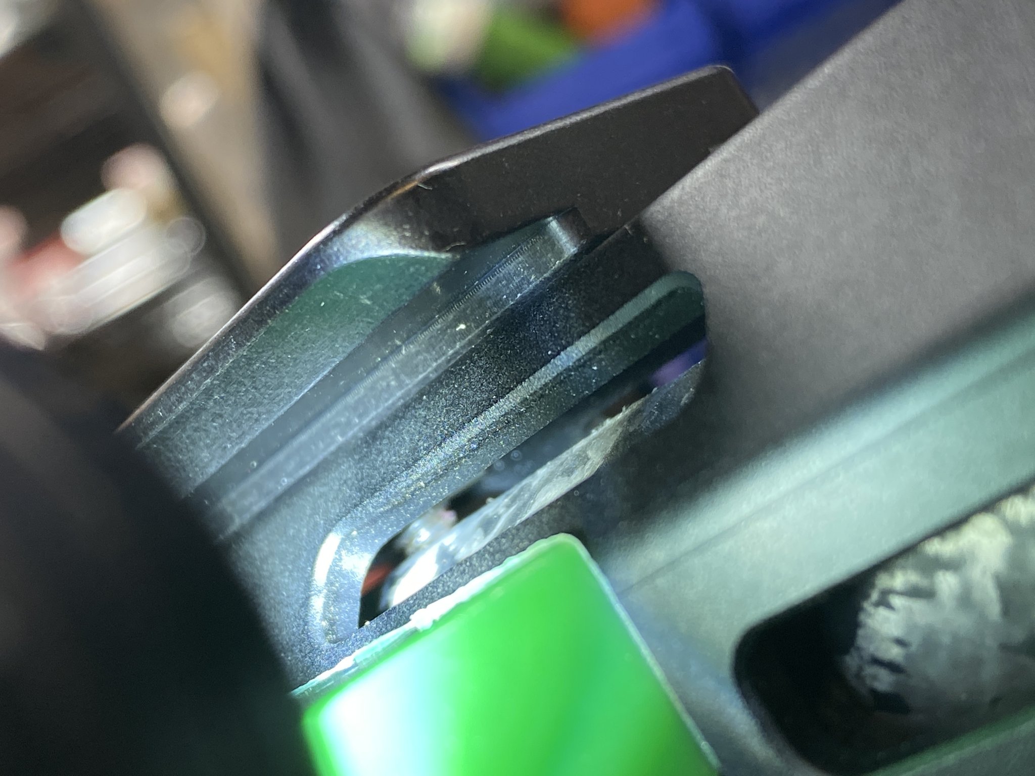

    I think that during one of the adjustment cycles I left the locking screws for the zero stop on the main scope to loose.
    Later on attempting to redo my dope and check everything I tighten them just enough.
    The back up scope is counter clockwise….

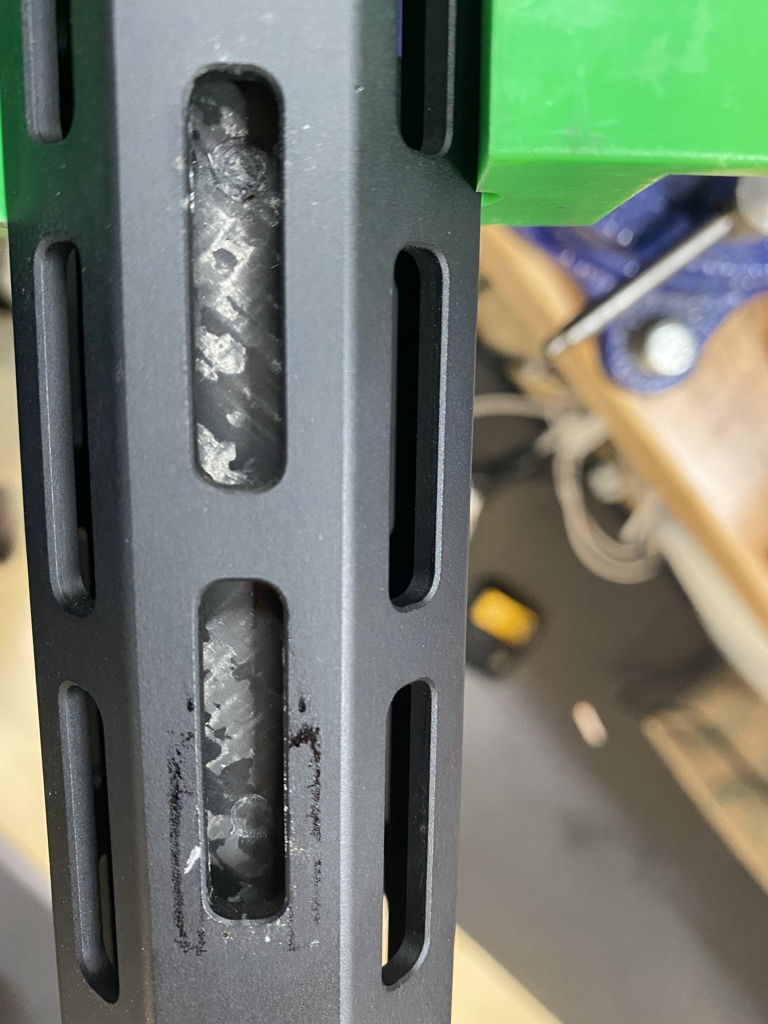

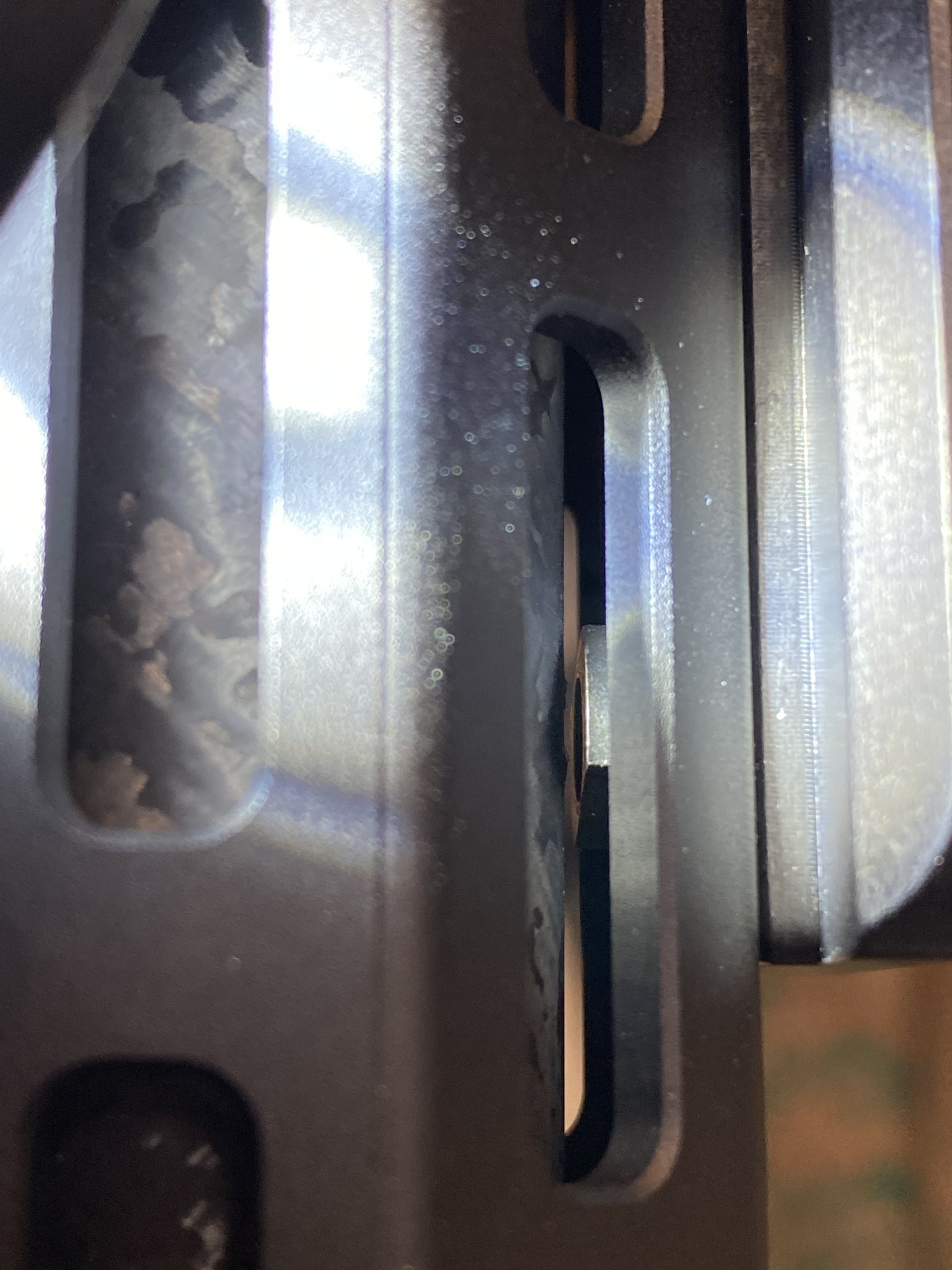

    I took the entire thing apart.

    I think I figured it out:
    What happens when m-lock screws are too long and actually press on your barrel?
    Your barrel points in a different direction….
    What you see here is what happens in a tikka T3 TAC A1 with a Proof carbon fiber barrel and no clearance to torque the bolts down because the bolts are too long.
    Turns out that the bolts Stubbs sticking out from the mlock device push on the barrel.
    What happened between rounds was that I moved the Picatinny rail closer to the action… changing how much the barrel was being pushed on, and therefore how much elevation was included in the system.
    Und, now for some German engineering….
    The bolts are approximately 14 mm tall as they come from RRS…
    In order to have sufficient clearance of the barrel they must be trimmed to 12.27 mm tall using a grinder.
    This causes them to precisely come flush with the mounting device…
    Not 12.26 or 12.28… 12.27!!!

    Dude, I completely forgot that during your class we moved the Picatinny rail on the front all the way to the back so I could put it on a tripod.
    Imagine my horror when after I got this great idea from some guy name “Frank” to put an arca on there for using tripod, andI saw all those little devits on the bottom of my carbon fiber barrel! 🥺
    It was funny because when I put the carbon fiber modified gun back together I noticed how incredibly stiff the barrel was in the action… which wasn’t the case with the original barrel and the action! “Damn, those carbon fiber barrels are super stiff! I’m impressed…”
