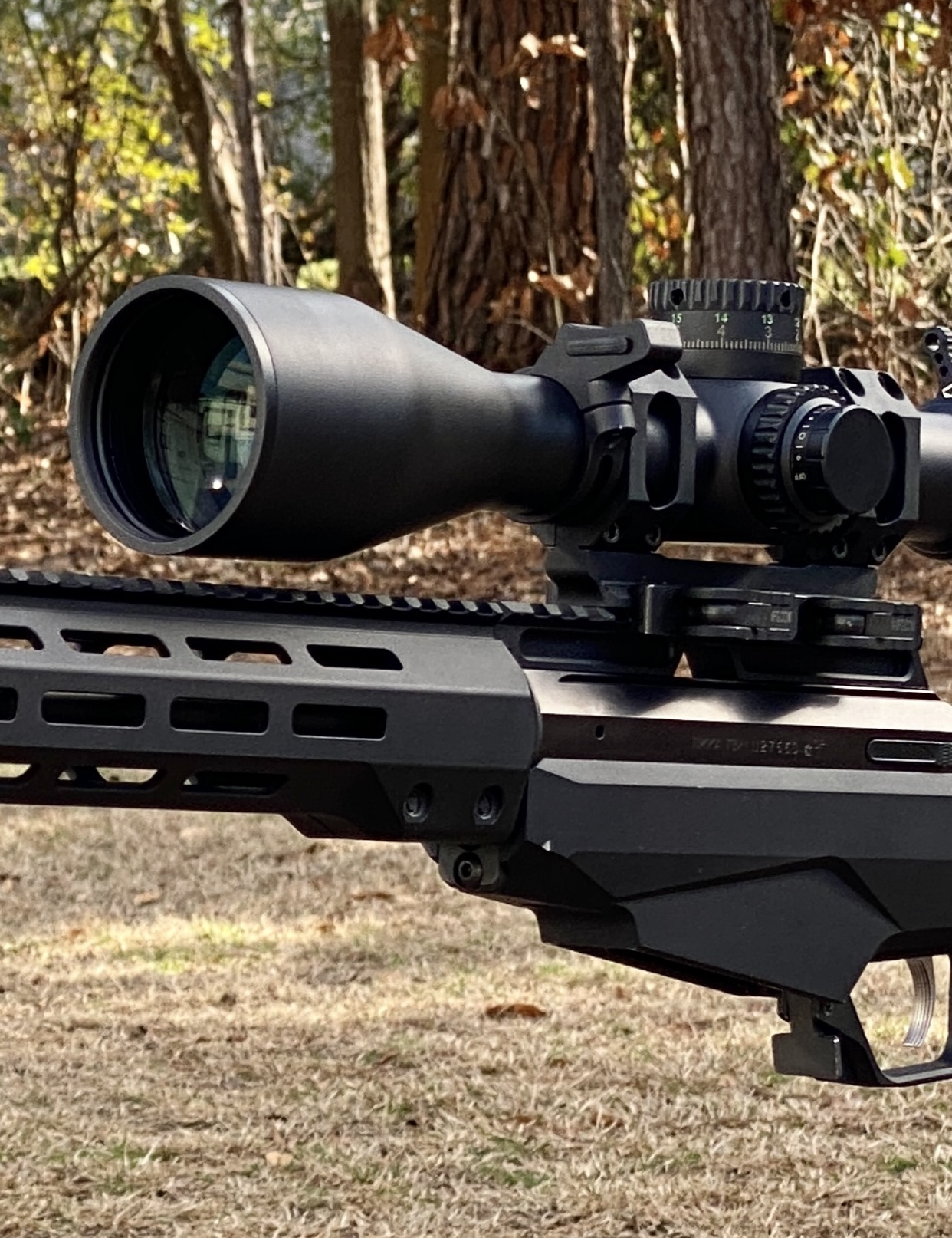

With 0 cant, clearance is fine. With a 20 MOA mount and Aadmount caps, it’s nearly touching the pic rail on the handguard.

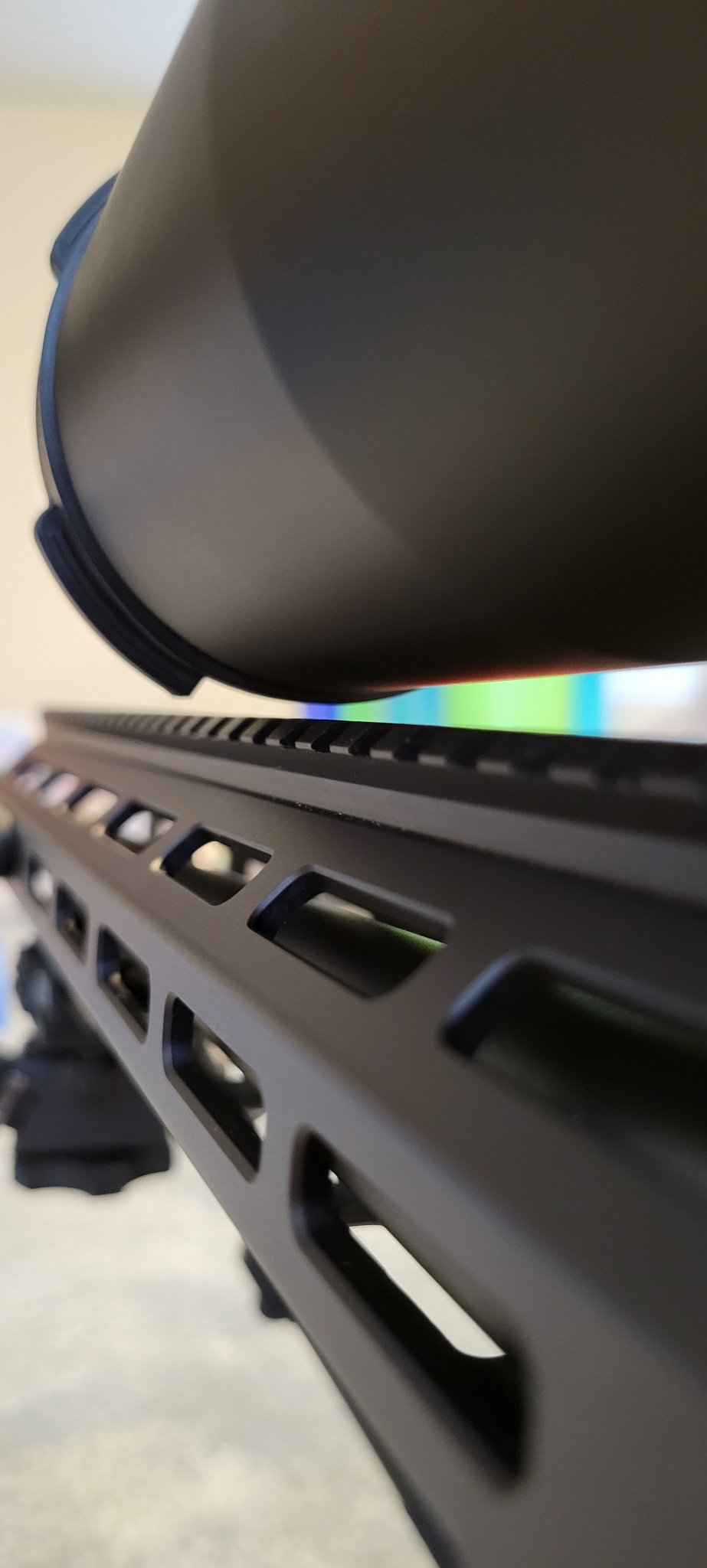

I just mounted a 56mm Athlon Midas Tac scope with sunshade on my Tikka Tac A1. I used high rings which I recommend, especially if you change from the 0 moa stock scope base to a 20 or 30 moa base for longer distance shooting. I used a 30 moa Egw canted scope rail which puts my sunshade very close to the top of the pic rail, like 1/8". Taller is better in my opinion

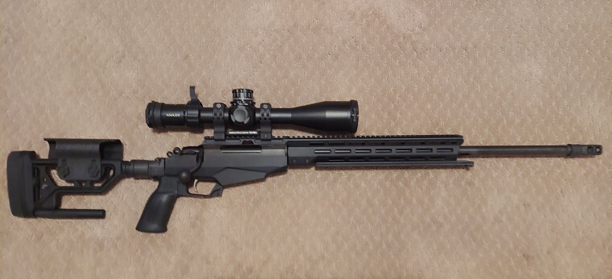

I didn't want to fight changing the included picatinny rail, so I'm using a Spuhr ISMS 34mm 6MIL/20MOA (SP-4602) Height 1.5" to mount a Vortex Razor HD Gen II 4.5-27x56. Without the sunshade I can use the Vortex Defender Objective (O-56) 56mm Flip Cap, no issues. With the sunshade it's a very tight fit. Not wanting to affect the scope alignment I remove the flip-cap if I want to use the sunshade.
