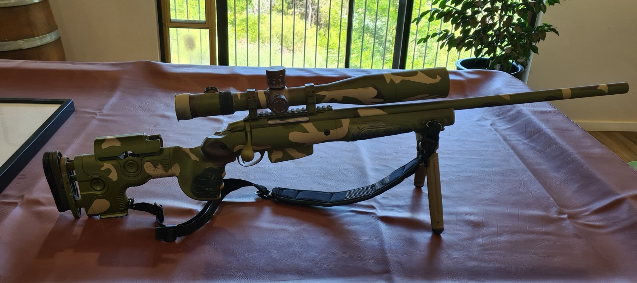

    ☝I am very happy with my GRS Bifrost stock.
    The rifle shot very well in it's factory stock, but the Bifrost is a joy to use.
    Very hard wearing, and so comfortable in every position.
    Money well spent.

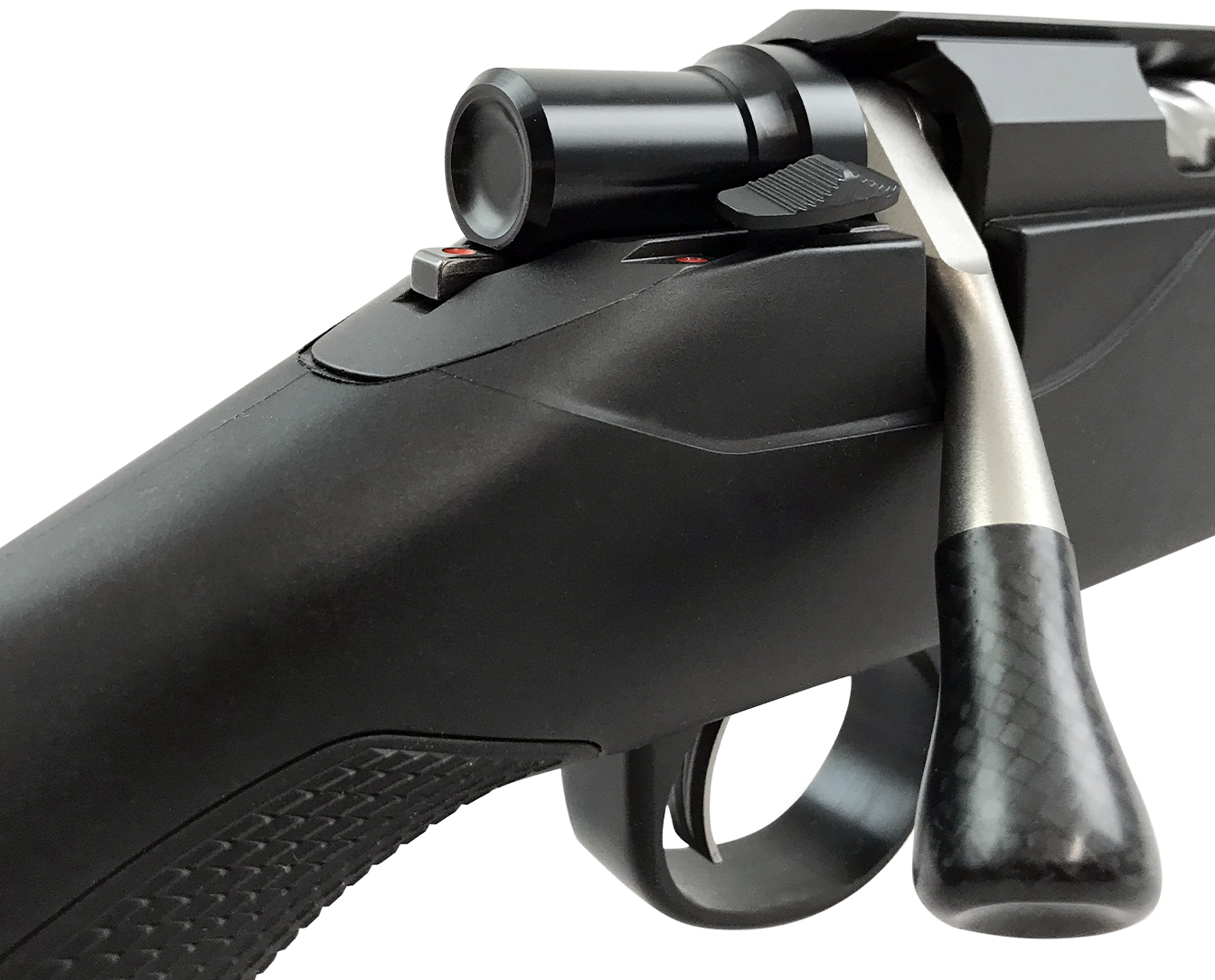

    Another vote for the Sterk swept bolt handle.
    Bar none, the best upgrade for the money on Tikka's. Yes, they're that good, and make the bolt cycling that much smooth(er).
    And easier.
    The added length give more leverage which also makes a huge difference.
    It's not possible to overstate how much of an improvement they make.
    The swept handle also places it in a position that is much quicker to grab and cycle the bolt.
