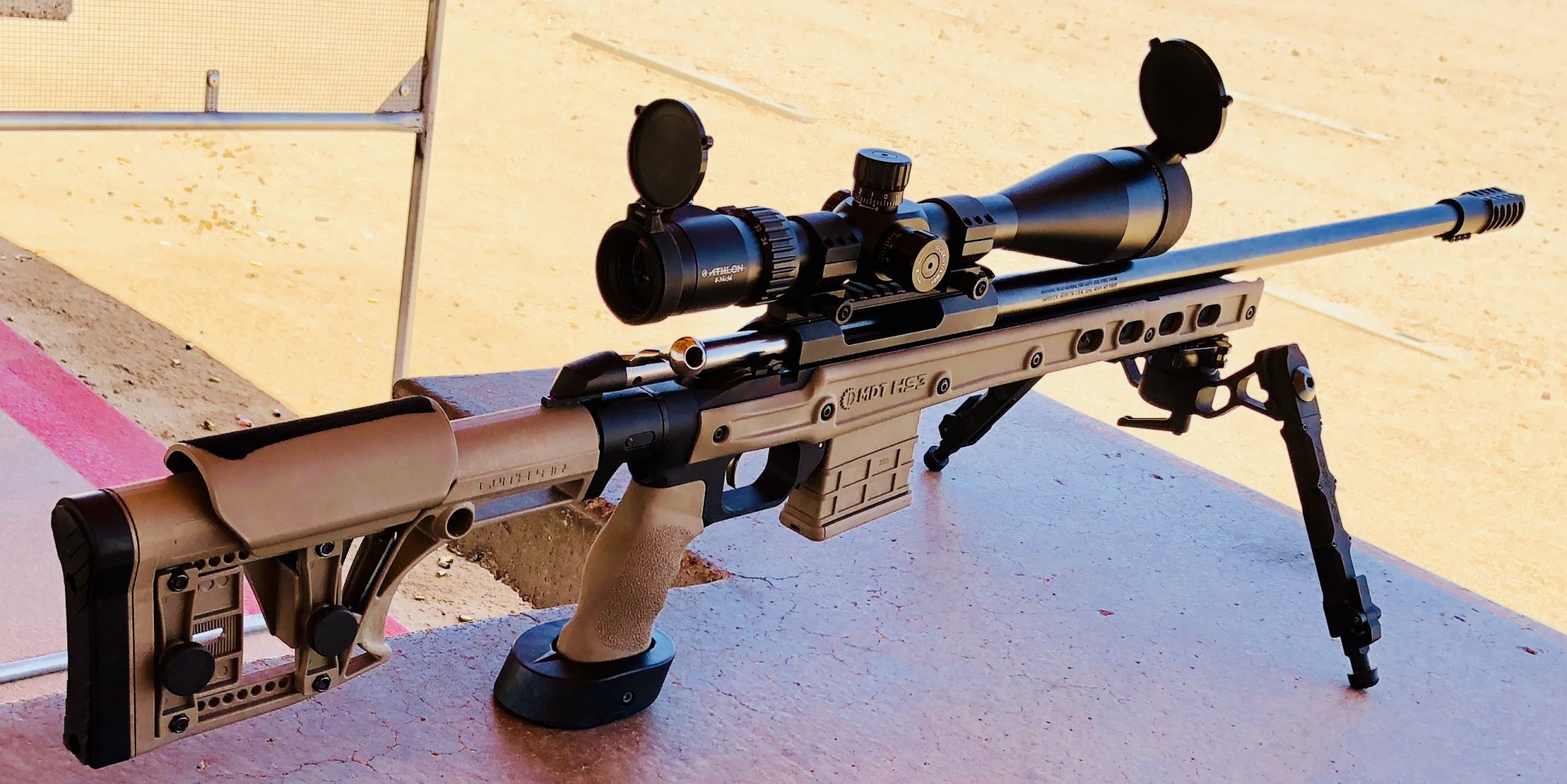

Hey guys,
I'm a new shooter, and just took delivery of my first rifle - a T3x .223 Varmint in Stainless barrel. As a new shooter, I was hoping for a little insight/advise on some ammo options I should start testing with? The rifle is a 1/8 twist - which I understand has something to do with the cartridge grains? (yeah I'm new). I know every rifle is different, but a baseline of options would be helpful.
Any suggestions on a handful of options to get me started? I'm literally in the dark.
Thanks in advance,
Colin
