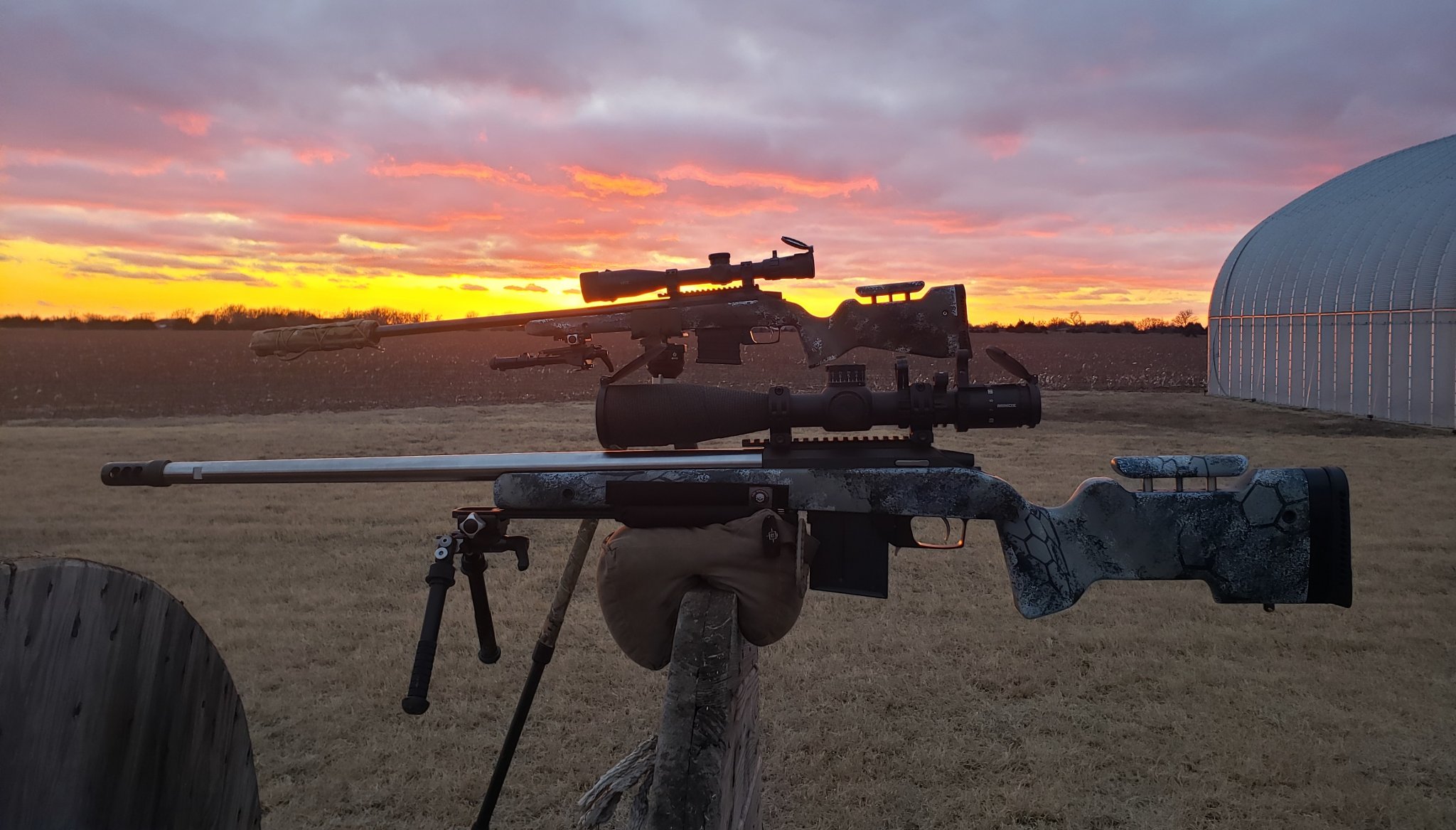

I have 3 German Gun Stocks that I ordered for the CTR inlet and I have two of the Mountain Tactical bottom metal for AICS magazines. I run the CTR bottom metal in one. MT and Atlasworks both make the CTR inlet for AICS magazines. I have one CTR and two T3 action based builds, they are all interchangeable as far as footprint.
The CTR mags feed smoother than the AISC mags do. I only went AICS on one rifle because it is a switch barrel 22BR/6.5 Creed and 22BR won't feed out of a CTR magazine. I use AICS on my 223 to load 2.5" COAL and longer.

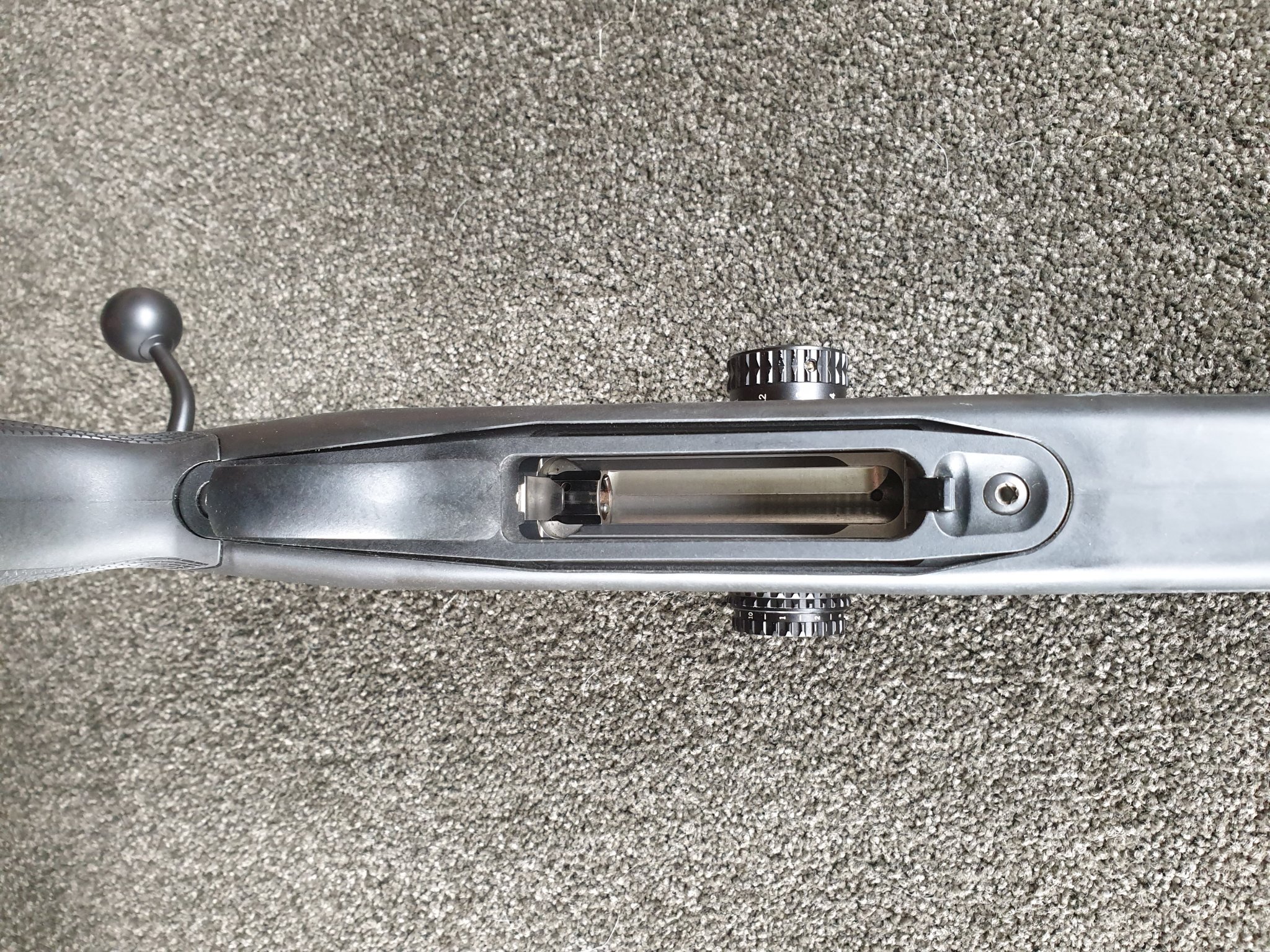

I didn’t quite see the answer I came here for but think we’re close. Can I convert my CTR back to standard tikka t3x bottom metal/flush mag and keep the same CTR stock? Bought the CTR for short length and thicker contour but cant stand the 10 round mag for hunting. Sounds like this is possible? Maybe not? Mountain tactical possibly?
Yes you can fit a standard T3 bottom metal/trigger guard.
The inlet for the CTR bottom metal is wider than the standard so there will be a gap around the edges but it will fit.
If you are happy with the standard T3 stock I imagine you can pick up a stock and trigger guard from the PX here relatively cheap.
A T3 Varmint stock wouldn't need any modifying but a T3 Lite would need the barrel channel opening up a bit.
