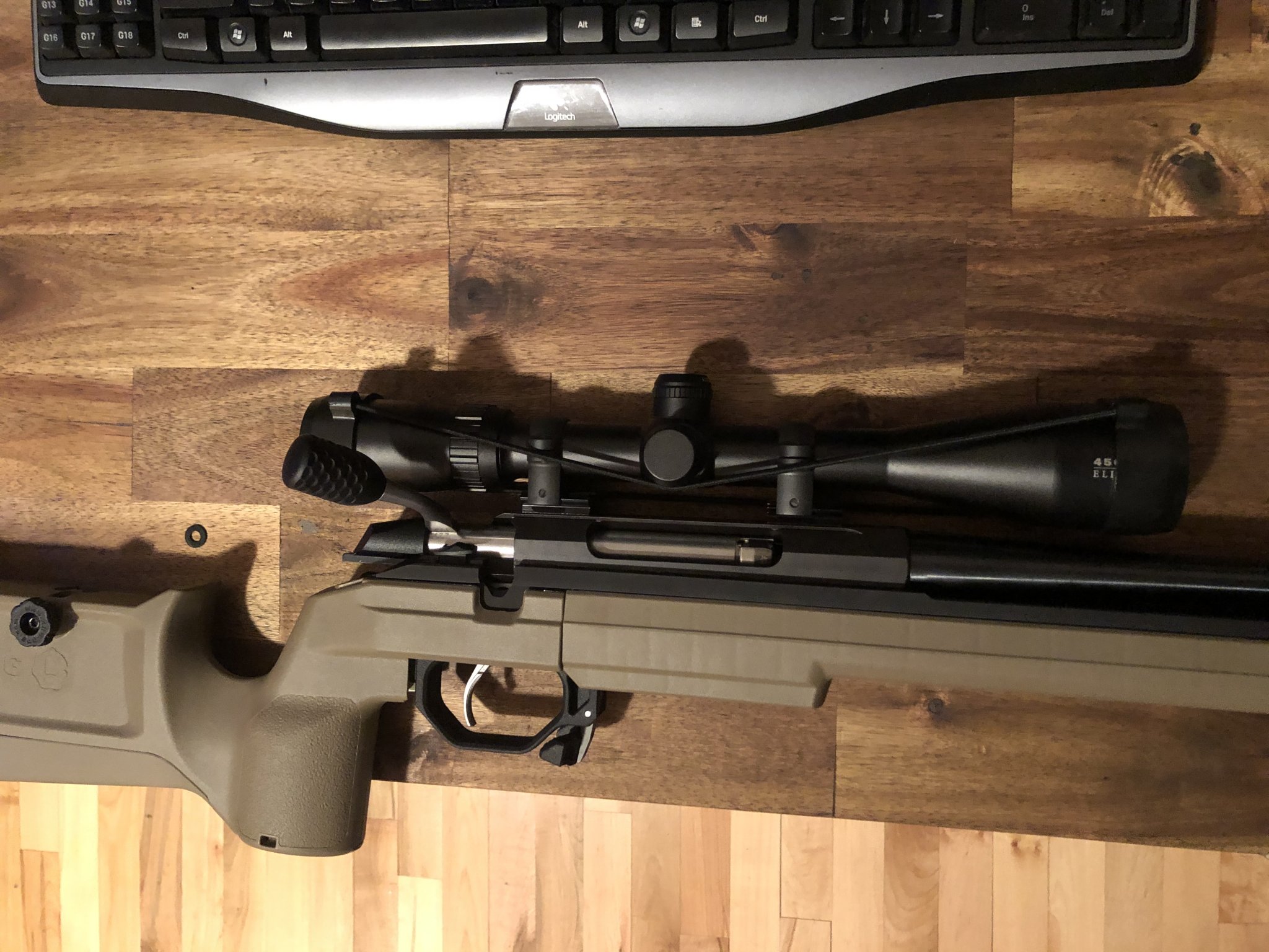

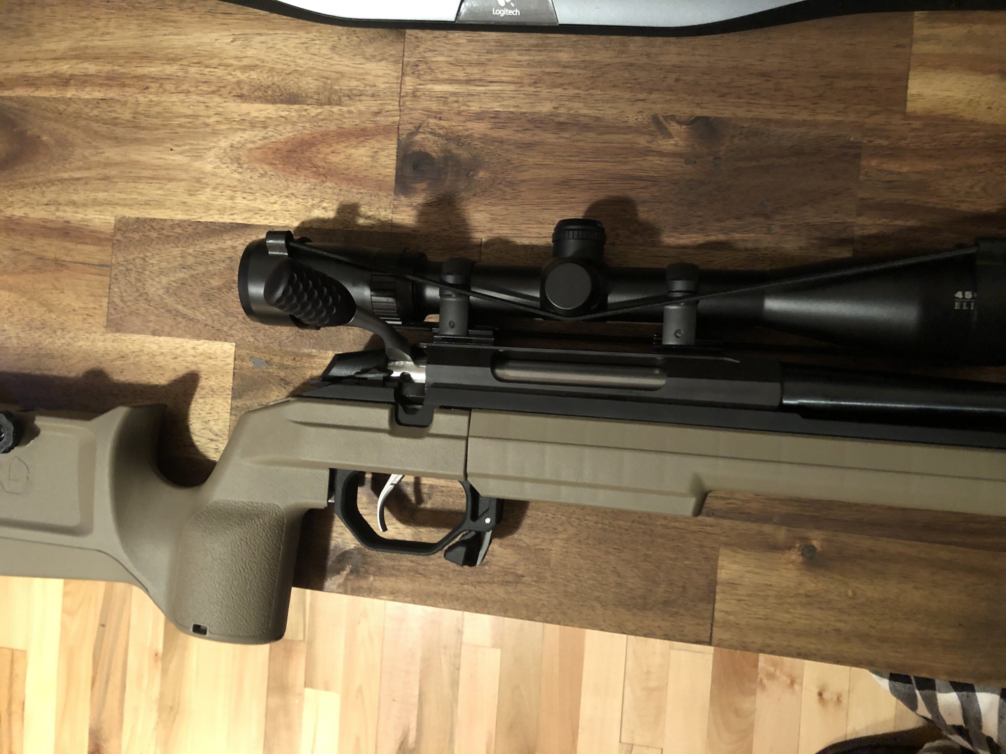

I tried dropping my T3X into my new Bravo today, but encountered some issues. Firstly I noticed that the washer doesn't fit over my rear action screw. It's just big enough to start to thread onto, then get stuck right at the bottom.
Other than that everything fit together. However I noticed that once I tighten my rear action screw (i.e. as soon as I have to apply any pressure to tighten -right on the cusp of finger tight-) my bolt gets stuck.
This photo is of how far I can get the bolt to come out once I tighten it while the action is forward (it feels like it slowly gets tighter as I try to pull it out, not a hard stop).
And this photo is of how far I can get it forward, before it hits a sudden, hard stop.
Is there something wrong? Am I right in assuming it has something to do with the rear plastic washer not being able to fit?
Thanks for any help!

Something is definitely going on with the front of the action, though. It's not sitting in the chassis as it should.
Is the recoil lug not aligned properly?
Did you take the metal tab off the front of the trigger?
I hade similar issues about getting the action seated. Make sure the rifle is on the lug. Then tighten each screw accordingly
I'm a huge idiot. I saw it, then got distracted and forgot. Unfortunately someone hid my allen key multitool, and one of the half dozen I have sitting around don't fit. So once I get that off hopefully that will solve the issue. Then I assume I can just pick up any M6 Washer and throw it on?

It came with action screws. I've taken it out and ensured that it's aligned. Maybe it was off in that photo. Like said above I forgot to take off the metal clip on my trigger, so I could easily see that being the issue. Once I can get an allen key of the right size, I'll try it out.
