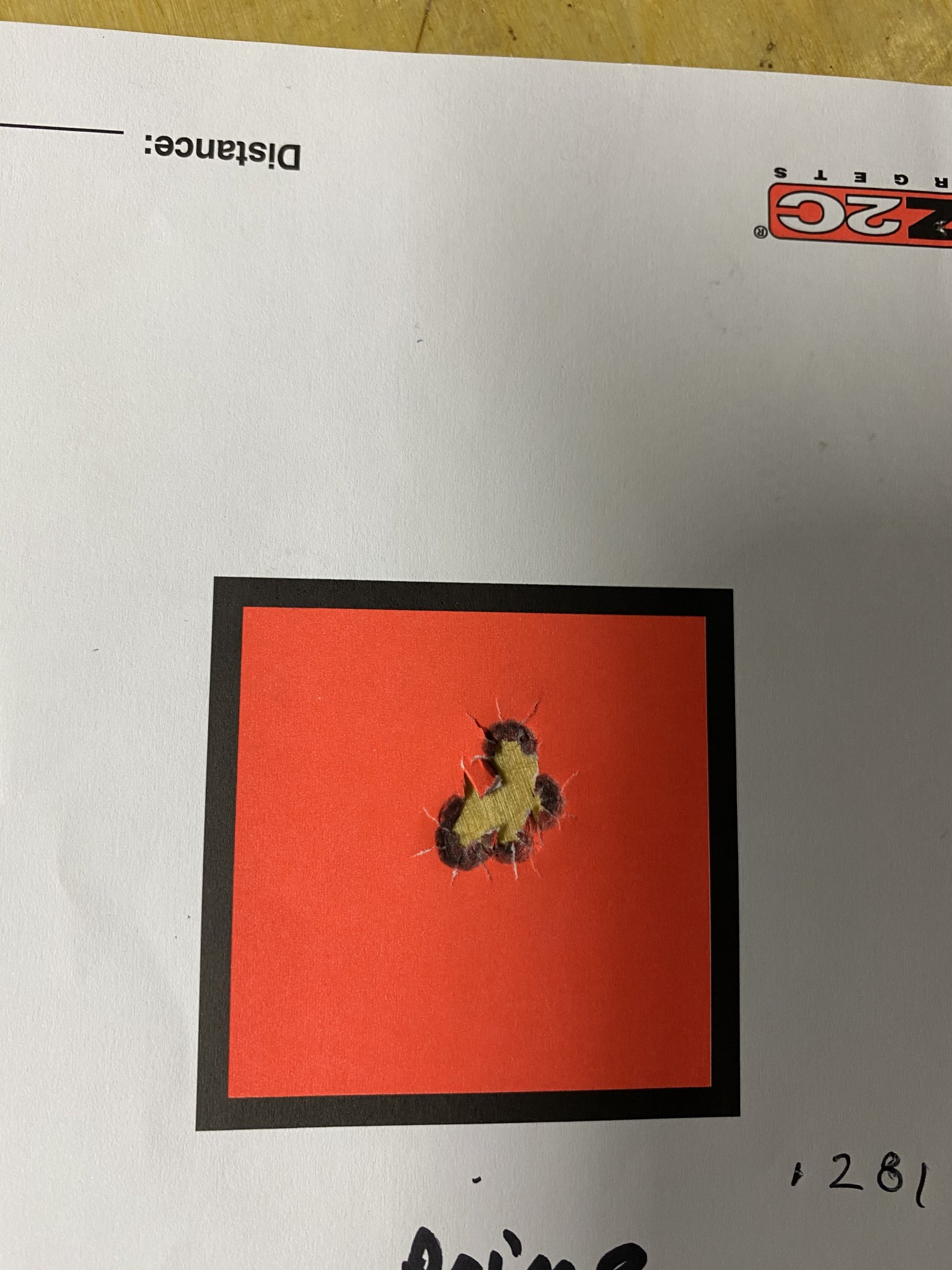

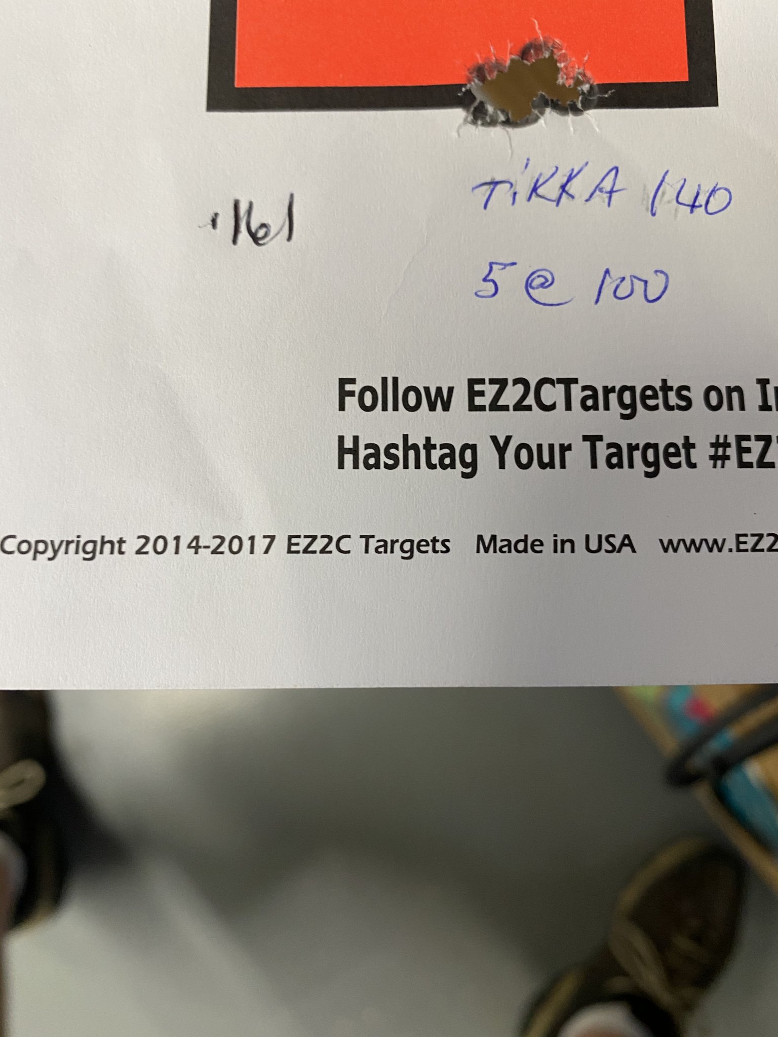

Hi all,I have had a tikka tac a1 for a little over a year now.since i do not reload i found hornady 147 eld works great.sub .5 moa all day with some .25 groups.following tikka’s reccomandation and i find cleaning the rifle after every range trip works best.about 600 rds through it now and out of the blue it has become very inconsistant.it shoots 2 sub .50 groups,then one or two 1.5 groups(see pics below).i have had 2 good shooters try it with same results,although it loves the 147 eld,i tried 4 other ammo’s,i made sure the recoil lug is seated and also tried tightening the receiver bolts from 35 lbs to 62lbs(tikka recc)in 5lb intervals.i removed the optic and remounted(athlon cronus & seekins rings)i am out of ideas and would appreciate any input or ideas,thanks all

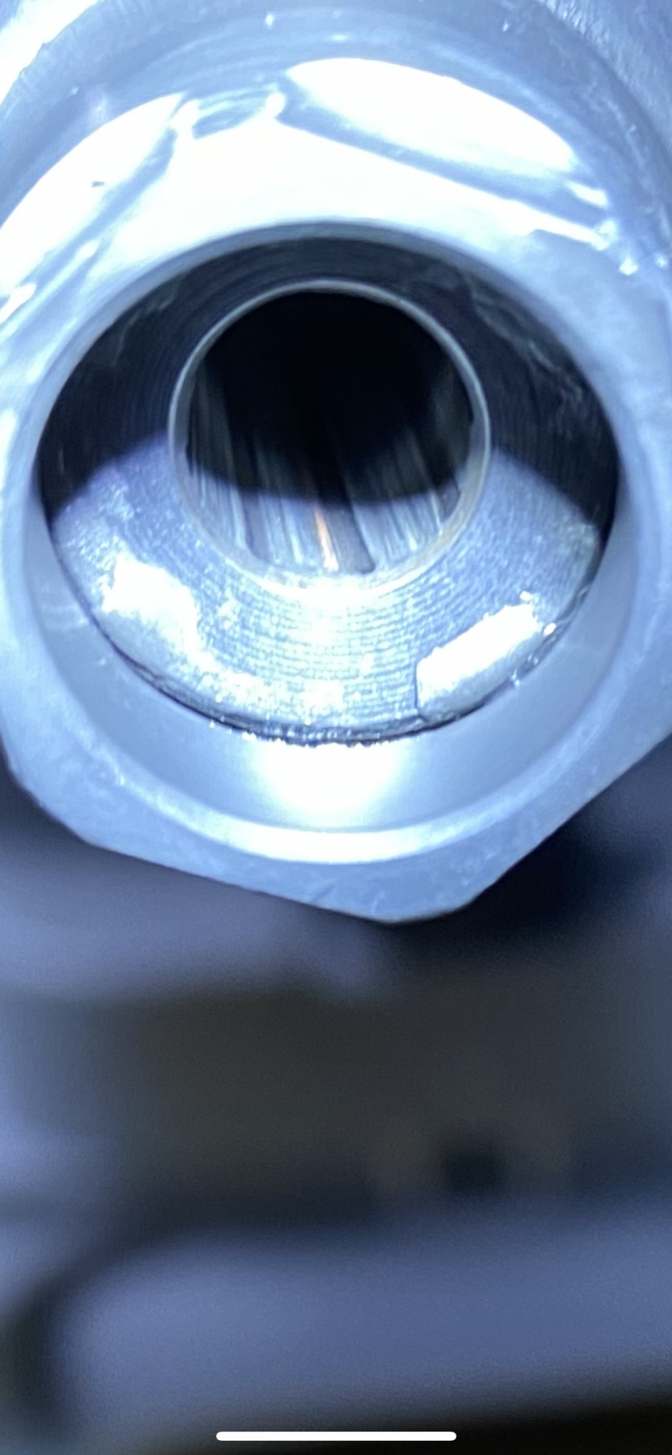

Check the muzzle crown? maybe it's gotta "nick" and how clean is the chamber? Did this start before or after you took the action out of the stock? or you didn't and just re-tightened the stock screws?

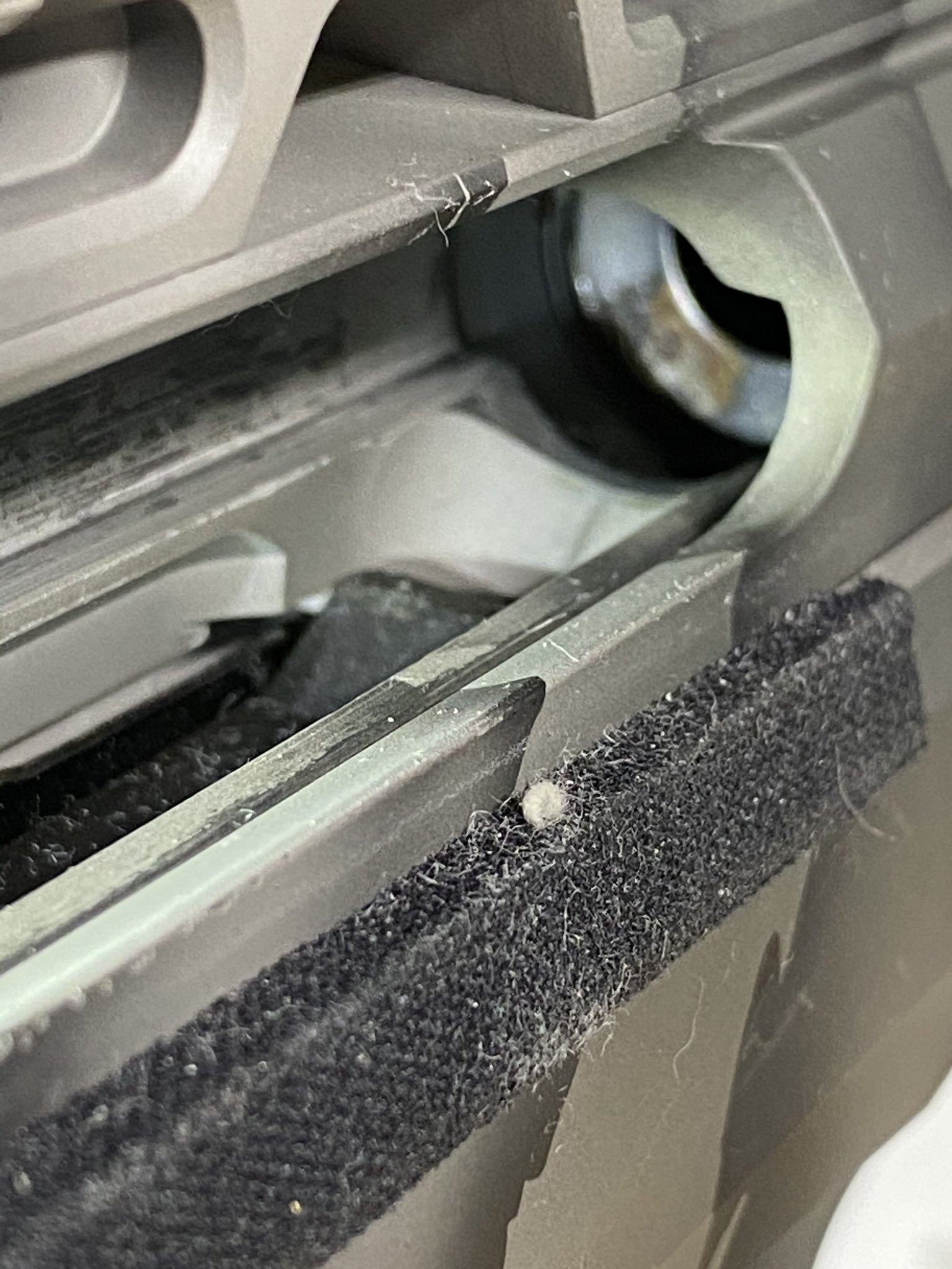

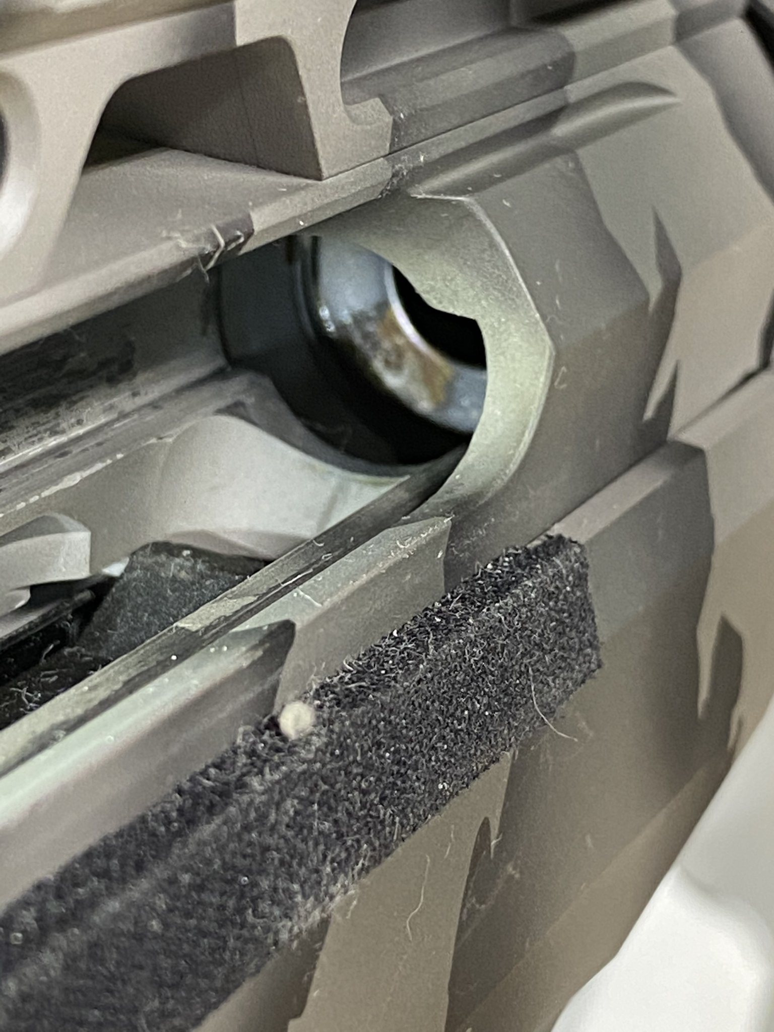

Dont see any nicks in crown(pic added below)chamber clean,this started prior to removing action from stock(i removed to make sure recoil lug was seated)
Unfortunately i dont have another 34mm optic to try.i have 30mm optics on my hunting rigs but with the season coming up dont want to start swapping them(if nothing else works i would do that after hunting)when you say carbon ring,are you refering to the crown?
I would do a thorough cleaning. Have you checked with a bore scope? Since you have tightened everything that would be my next step. Good luck as they are great rifles.
Intermittent problems are a PITA. Other tikkas with the same problem appear to be few and far between. A couple of guys on the web said bedding corrected the problem with their rifles. I would fiddle with it a bit more then send it in. Once its been repaired and determined to be safe I’d sell it. You shouldn’t have any problems getting most of your money back. Once I lose faith in one I get rid of it. Sometimes they make a bad one and throwing money at it is just sending good money after bad.
2 things i would also like to get opinions on.tikka manual says use a copper brush and use a push-pull motion 12-15 times.i have always been told never pull the brush backwards towards the action & i usually use nylon brushes.maybe my cleaning method is not good enough,whats everyones input on push-pull opposed to push only?

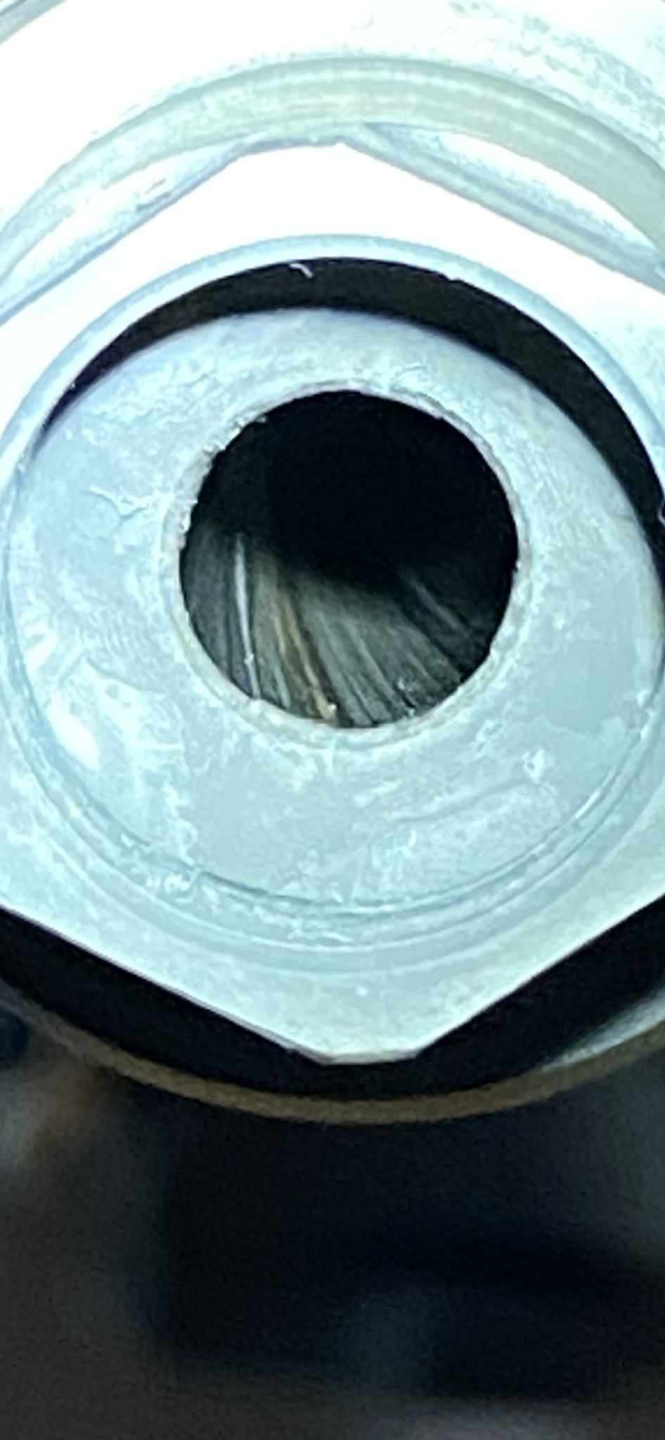

Pic crown
You can see copper from the muzzle. Not that that matters all the time but if it’s acting funny I’d be cleaning ALL copper out and trying again. You’d be surprised at how long it can take to get it all out. Use boretech eliminator. Brush, soak, brush, patch and repeat until you think it’s clean. Then do it all over again. Without a borescope you are guessing when it’s clean. I’d grab one of the teslong scopes so you know when the copper is gone. Well worth the $50.

The recoil lug, or scope/ scope mount seems more likely to me.

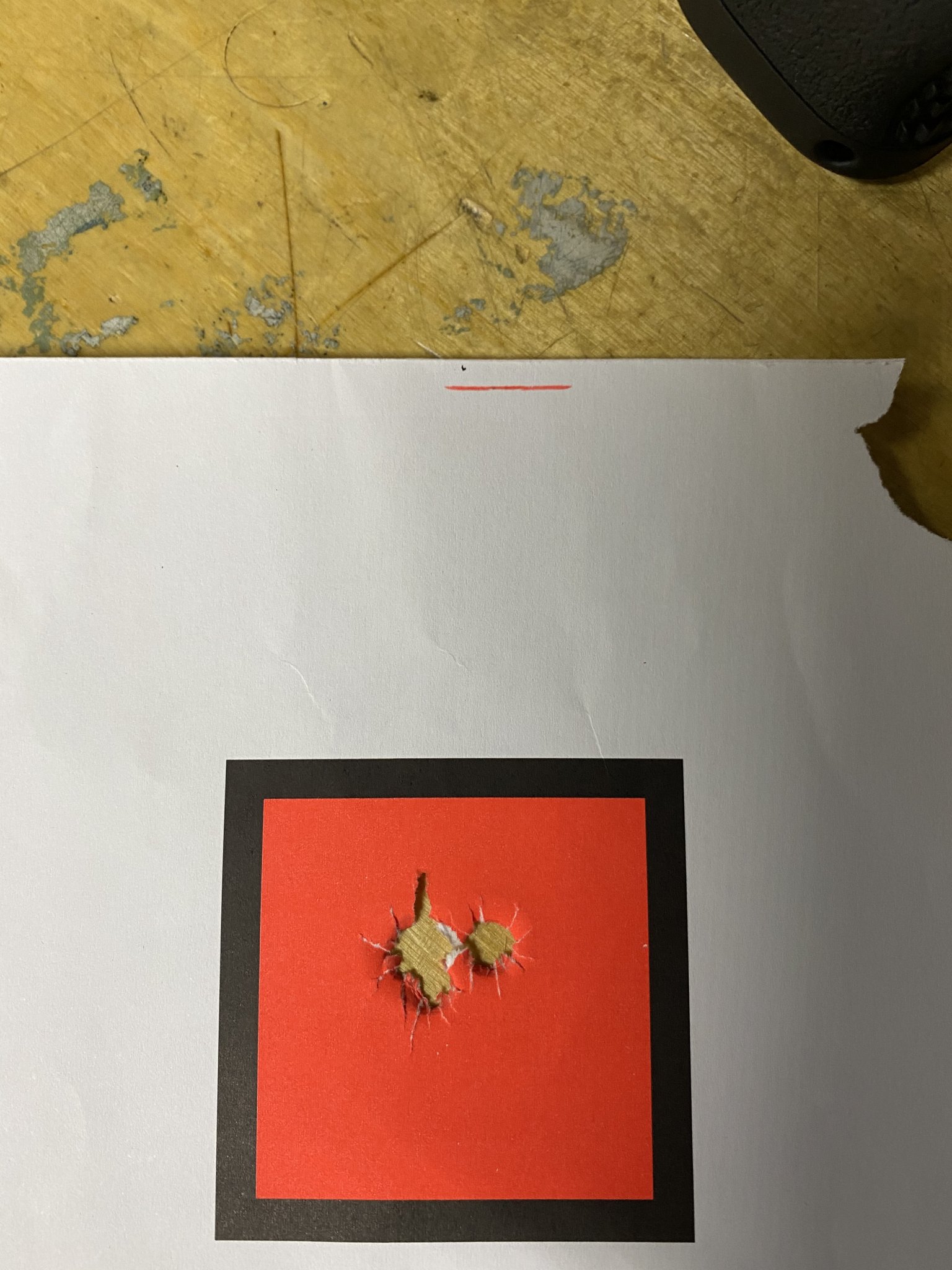

Finished a thorough cleaning,going to range and my next option is to try a different scope
I found some rust on the barrel lip where it meets the action(pic below)dont think that has anything to do with the problem but any ideas how to remove it?i tried a few barrel cleaners and a q tip but no luck
On my Tikka Tac A 1 I found the lands eroded rather quickly on the original barrel. Since your not reloading, chasing lands, you may be out of the sweet spot. A good cleaning could also fix the problem.
