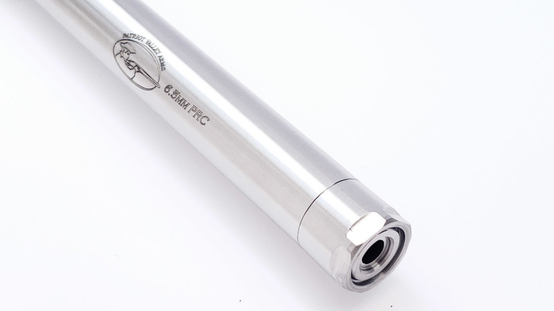

I've been wondering about this myself so I spoke to Josh at Patriot Valley Arms. He said he has to modify the flange on the chassis that the hand guard bolts to. He said it's a straight forward modification and he just needs the one part, not the entire chassis to be sent in.
He also sells Tikka prefit barrels with barrel nuts and does great work.

I'm part of a facebook group for Tikka Tac A1 owners and a few of the guys have installed PVAs prefit barrels with the barrel nut and they fit just fine. One of the guys has a MTU contour with a barrel nut.
Personally, I just installed a 26-inch m24 shouldered prefit on my Tac A1 and it's working out just fine.

I took it apart yesterday- it seems the handguard clamps to a little faux nut thing that really isn't a nut at all- just a bracket that attaches via hex nuts.
The rest appears to be standard Tikka shoulder.
Yep they’ll work just fine. I’ve used profits from PVA and Straight Jacket Armory. If you’re still using the TAC-A1 chassis you can’t go heavier than m24 contour. Even with m24 I had to file down screws on my pic rail attachment for my bipod so screws wouldn’t touch the barrel
