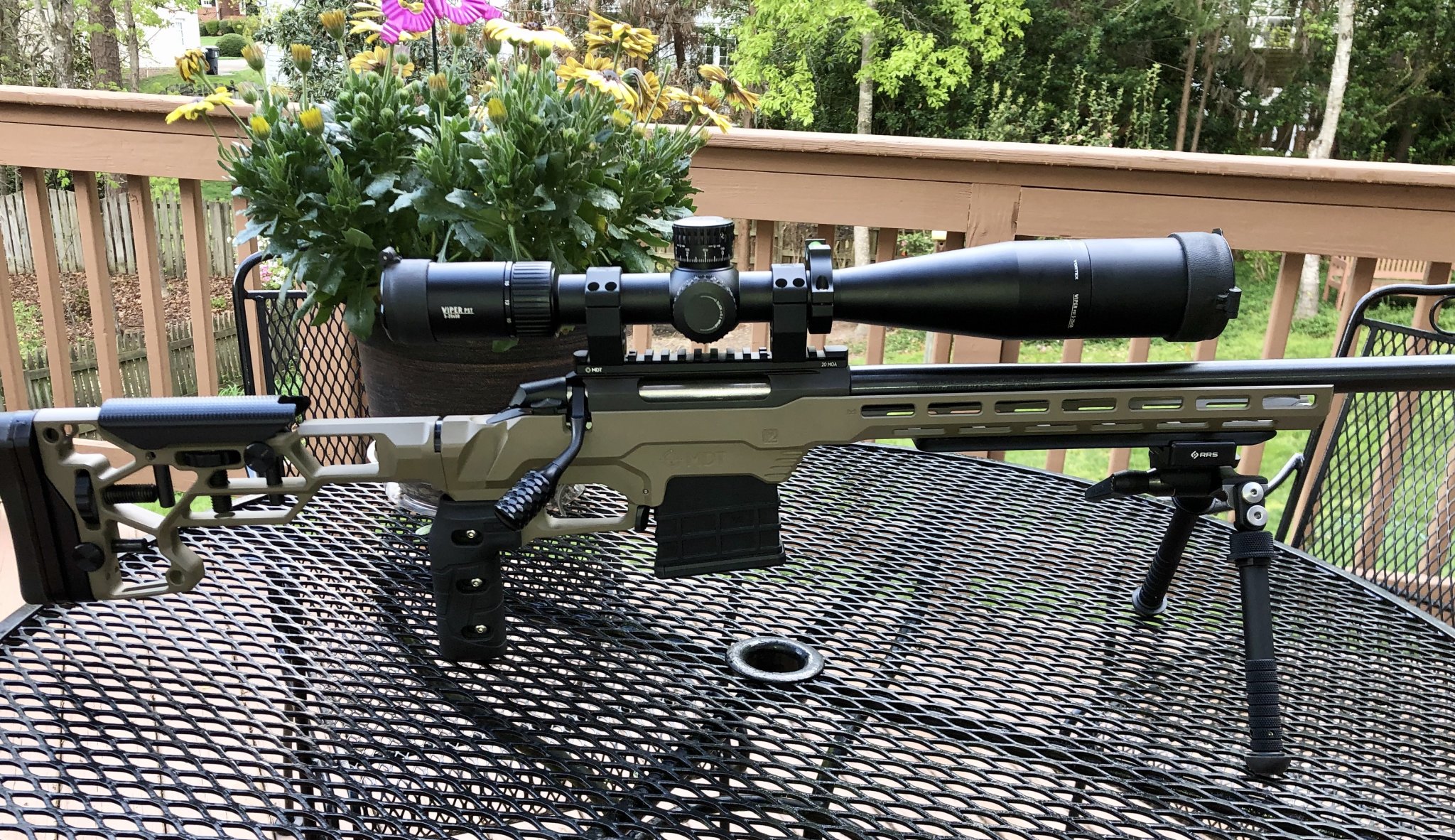

Here is my old T3X Varmint in an MDT LSS-XL chassis with what MIGHT have been an Anarchy Outdoors bolt handle (it's been years; fuzzy memory) to replace the puny little nub the Tikka insisted on using. Also had to add a pic rail for the scope - standard Varmint varient didn't have one - and later I stuck a piece of MDT ARCA rail on for best bipod functionality. Sold it all after I picked up a Terminus action cert off a prize table, MDT ACC chassis on Black Friday, and built a full-blown custom.

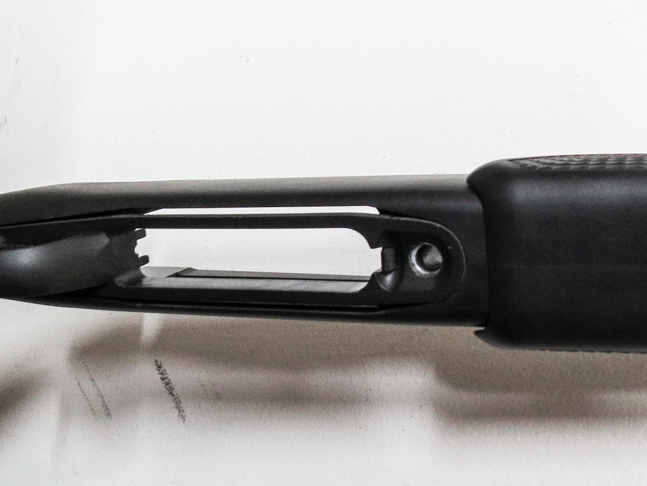

You are asking 3 questions at once.
Will the barreled action fit? Yes. Hence viking78's response above.
Will the ctr magazine fit into the bottom metal of the super varmint? No. Pic is lite bottom metal in a ctr stock.
Can you feed the ctr barreled action with the super varmint bottom metal and 308 magazine? Yes.
Now you have info so you can make your own decision.
