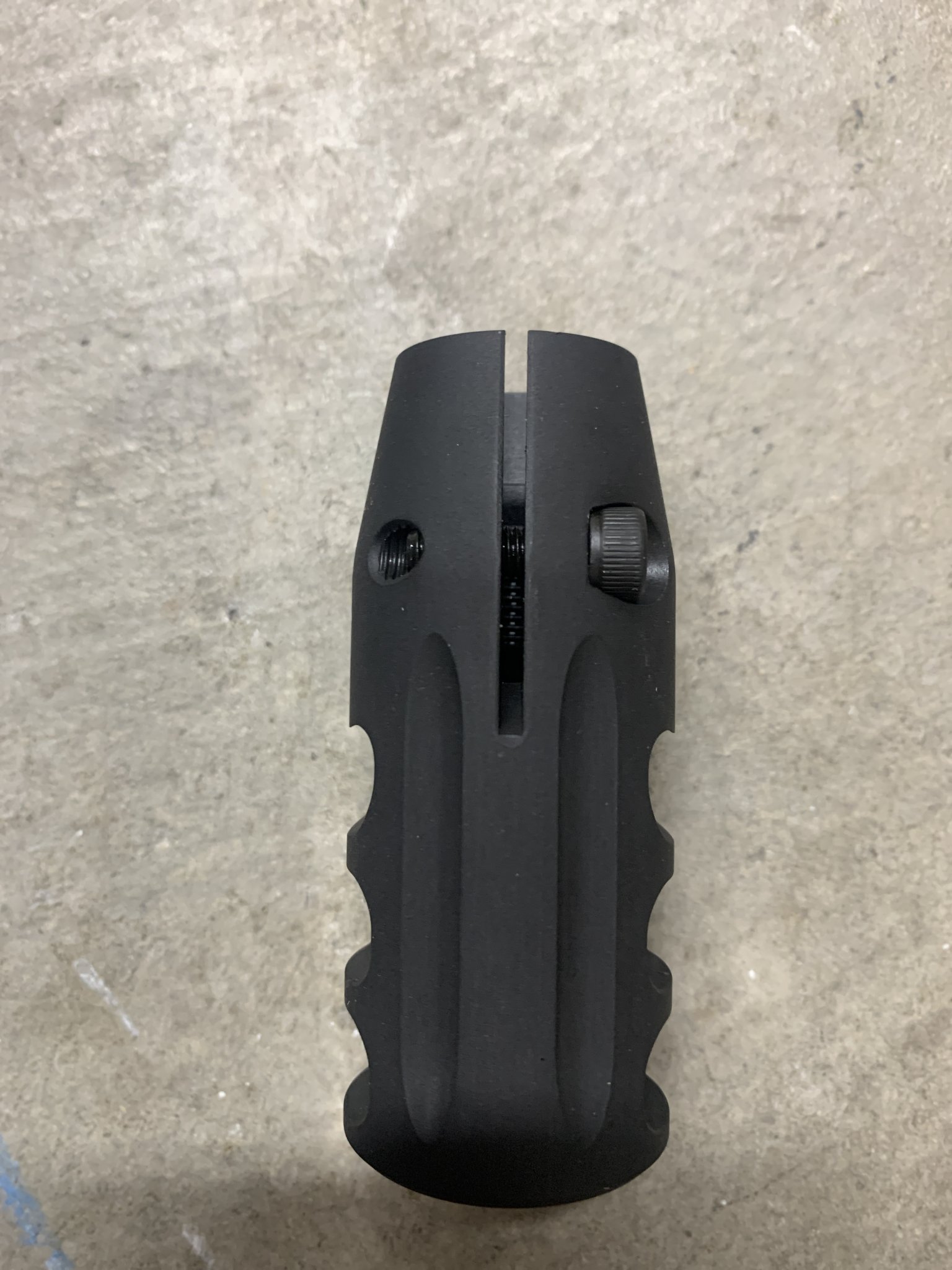

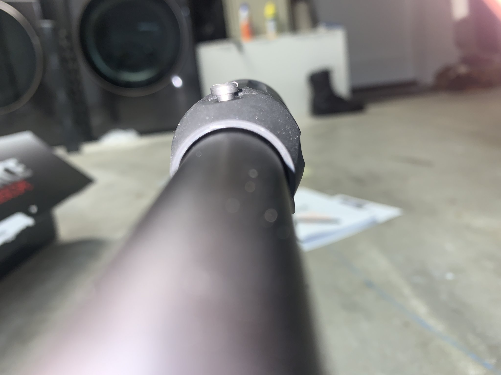

Here’s some pictures. First one shows that only a minimal amount of torque should be required for it to bite. In other words it’s not designed for the surfaces to meet in my opinion. Second shows the gap between the barrel and brake.
When it’s fully threaded on, it doesn’t jiggle at all but it isn’t aligned. When I back it off about an eighth of a turn to align the ports correctly, it jiggles and tightening the allen screw doesn’t help.
I tried giving it a little more pressure when I threaded it on to see if there was a dried factory bead of loctite or a spur on one of the threads I had to overcome but that wasn’t the case.
FYI That top screw is just for a mirage strap and doesn’t lock it down at all

This is just odd. I can't think of any reason why you couldn't wind several turns of plumber's teflon thread tape onto the threads to give you temporary use of this brake until the new one shows up... although I guess it could make a mess.
There's also the option of a 3rd-party brake, but if I recall correctly the thread pitch used on the Finnish Tikka is different from the usual 5/8x24 US pitch for the mid-caliber barrels.

I had the same issue. I had to back off the muzzle device by almost 3/4 of the final turn - felt like one full rotation. I used a Husky 1/4in torque wrench with a hex socket to torque down the screw. Torquing down this screw needed some strength. Provided Allen key are pretty useless for take level of torque.
Reactions: PTCX3
^^^ What he said. When I read your response (" I torqued it down until the allen key bent..."), I misinterpreted to understand the bolt head itself deformed or stripped.
Yeah, I used a ratchet wrench with a 1/4" hex socket to tighten the allen bolt.
