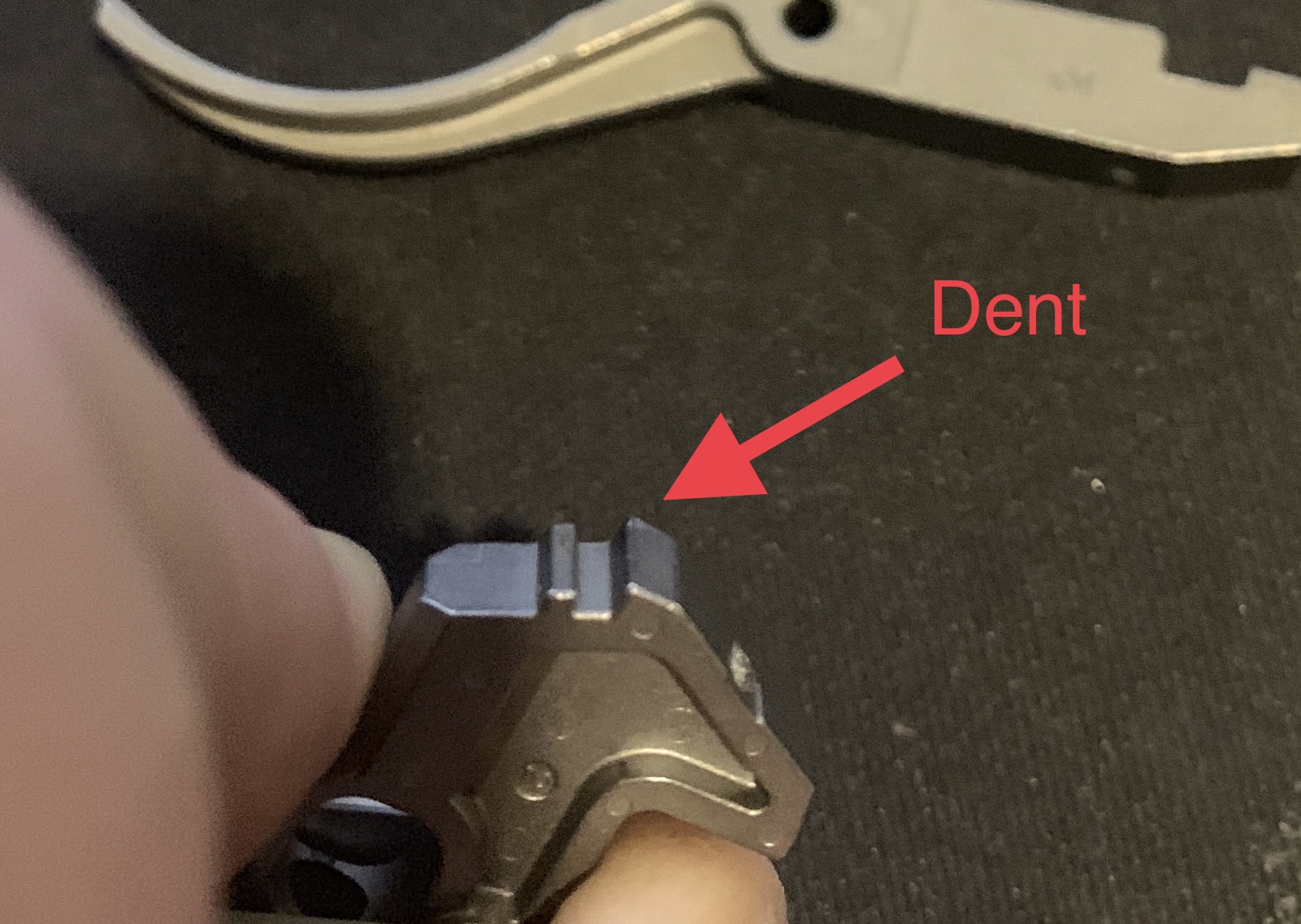

Not just for you but for others that might have a tikka trigger that isn’t the best. I had one of my 4 tikka triggers that had a deformation on the corner of the trigger that caused me some issues.
That trigger would never get down below about 2 pounds even when I put it in another gun with the same aftermarket spring/plunger that would go down to ~1lb. I ended up having to take this one to a real stone to resquare it. I then polished it and it will hold down to that 12oz range now.
Not sure how the MIM will hold an edge on that one but it is now at least useable. I say this because people say that MIM is not able to be reshaped because it is only hard for a very small amount of depth.
That being said if anyone that changed triggers and doesn’t want it anymore I would love to section one and test hardness and depth of hardness. I would do it on one of my triggers but I don’t think I am gonna change them out now that I have taken the time to polish them. PM me if you are willing to donate one.
