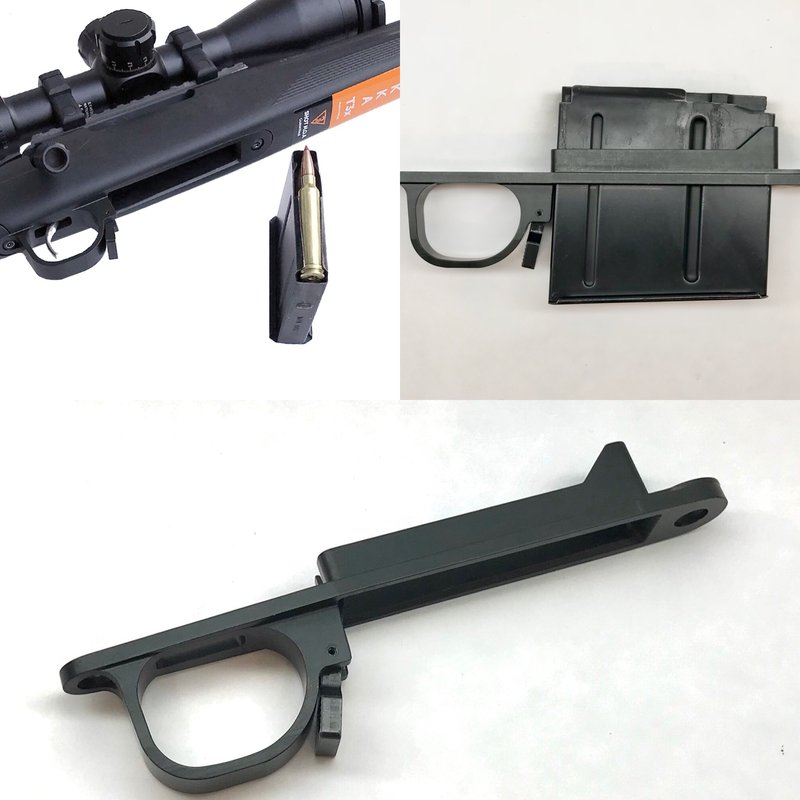

We have just released our new patent pending bottom metal for long action Tikkas that allow an OAL of 3.500+ It’s AICS Magazine compatible with OEM stock or aftermarket stocks with factory DBM inlet
Could you expound on this a bit? CDI has had bottom metal for some time now. It sounds like you are introducing a new aspect to the system somehow, maybe you can elaborate. Is it that it doesn't need a special inlet?
Thank you,
Justin
