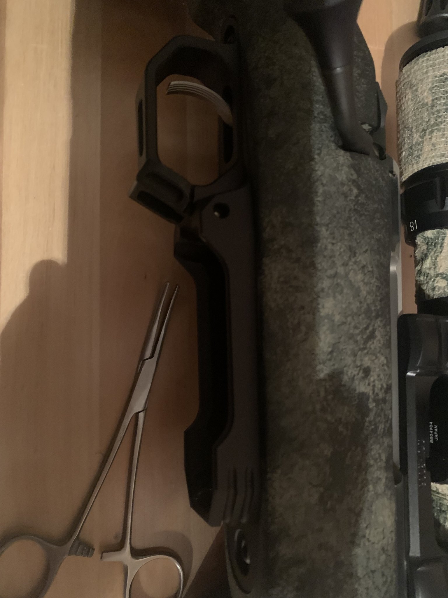

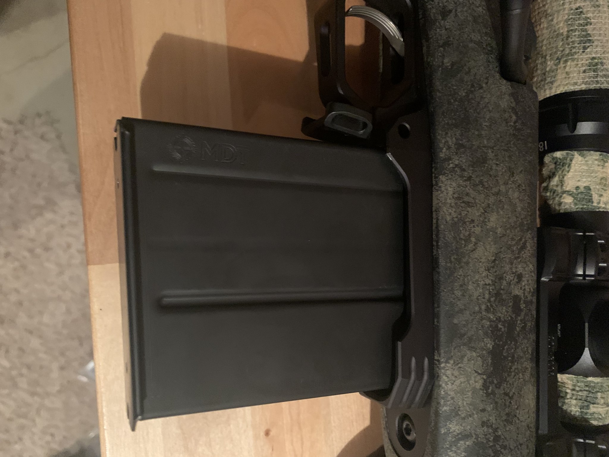

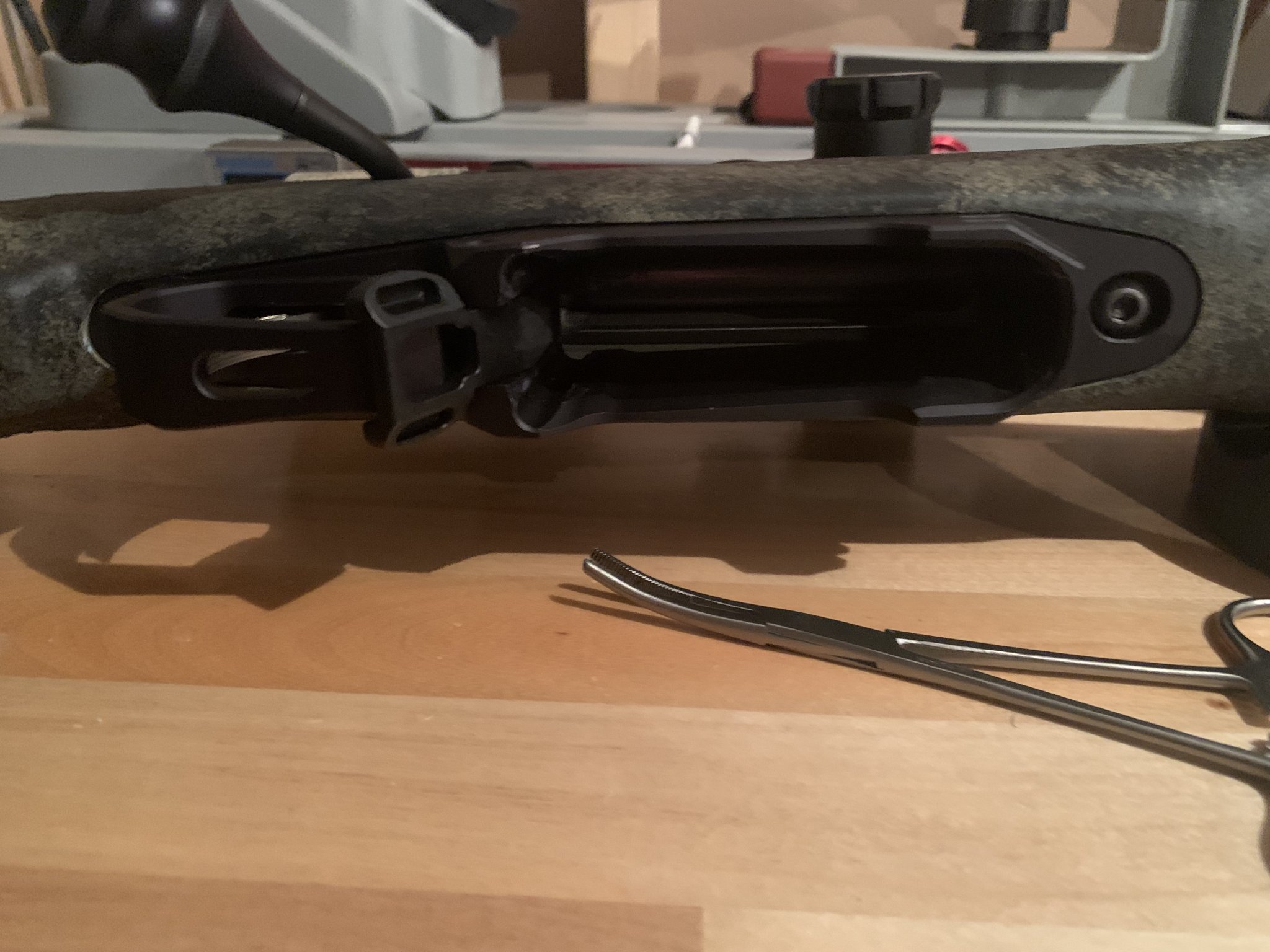

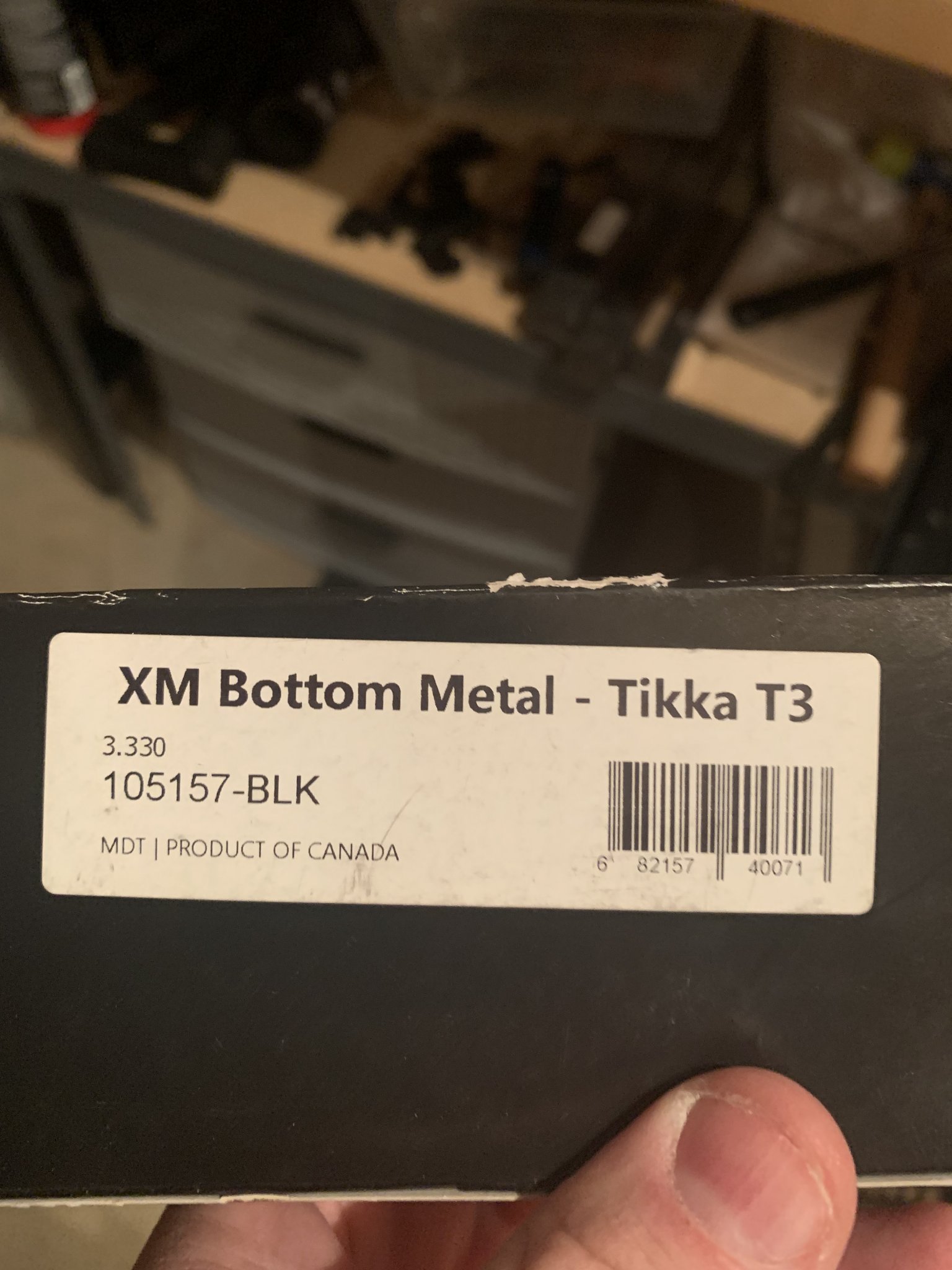

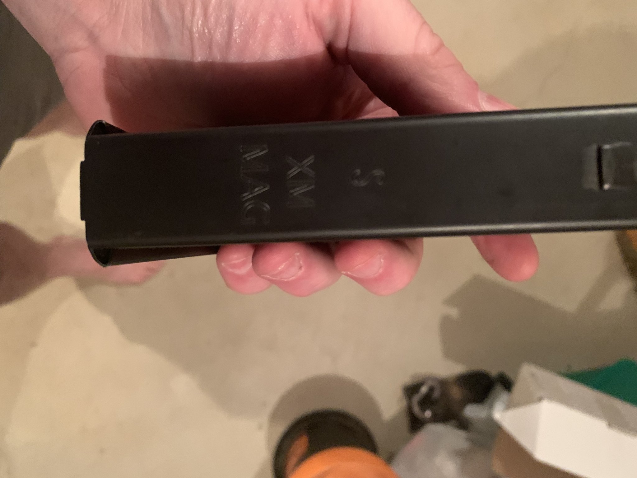

Can you take a picture of the bottom metal made by MDT for xm tikka mags?
No it’s a standard xm magnum magazine have 4-5 of them purchased at different times all feed well. The 284 has a wider body diameter so does well in magnum magazines. That is a bit long of a mag but actually holds 13 though it is a 10 rounder. That’s why I will try either shortening one or the um one I mentioned.
Reactions: DKN83 and Raffy
There is one it’s just hard to find for whatever reason at least here in the US. Mdt makes a bottom metal and you use xm pattern magazines which mdt has as well. It fits into a tikka ctr pattern inlet stock, have one in a McMillan long range hunter version. It is a good option for saum, wsm, 6.5x55, or 284 variants.

They had advertised it but then took it down(it was on their website). I can't find the email, but when I asked about it they either said it was discontinued or they scrapped the idea. I assumed they scrapped the idea due to the XM length being associated with Defiance and there was some sort of legal issue over it.
That's a nice looking BM, I'd like it if they made it for the 3.56 mags. Truthfully, the difference between the two is really small.
