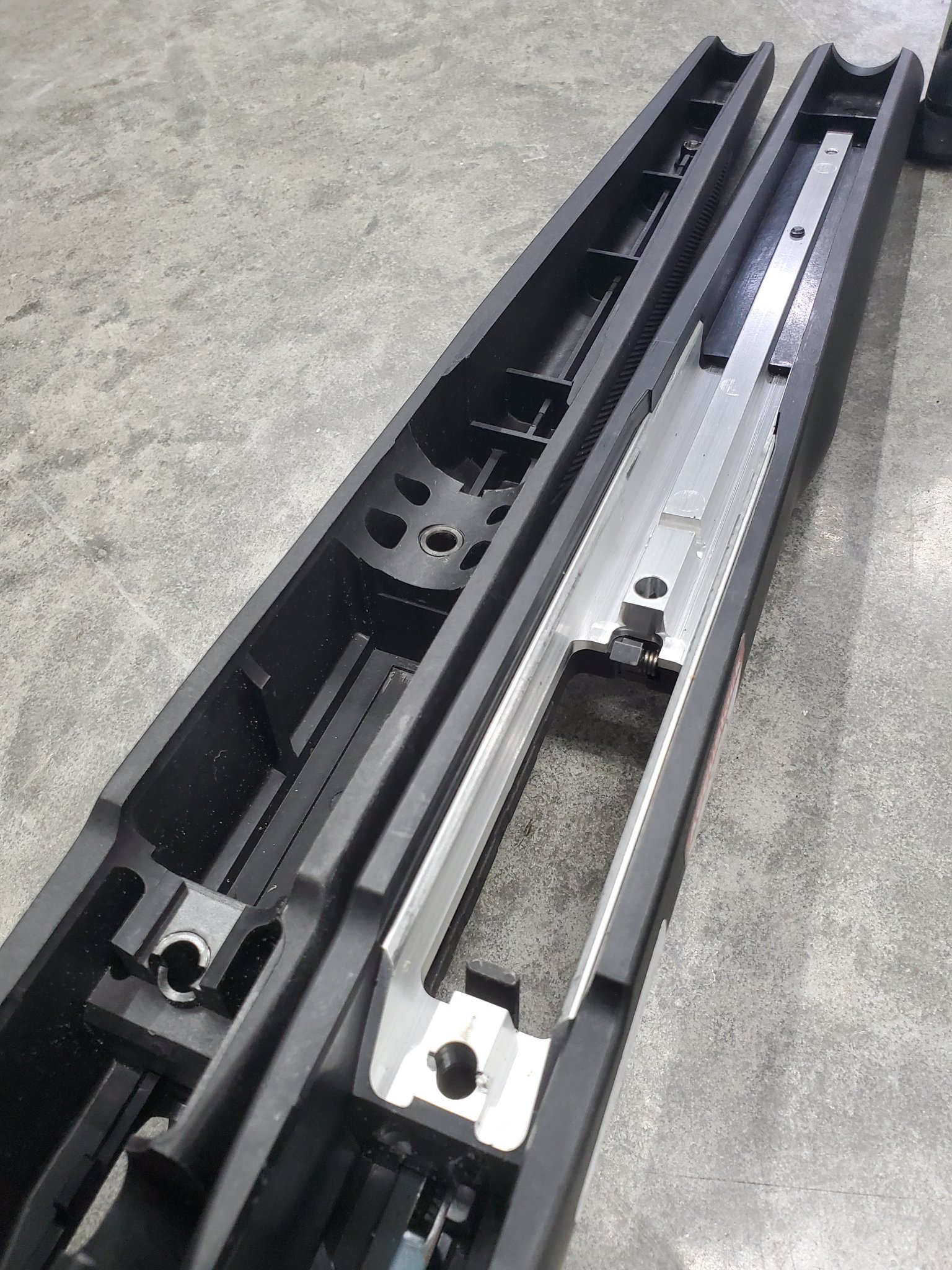

The new savage accustock is not all plastic and has an aluminum bedding system.

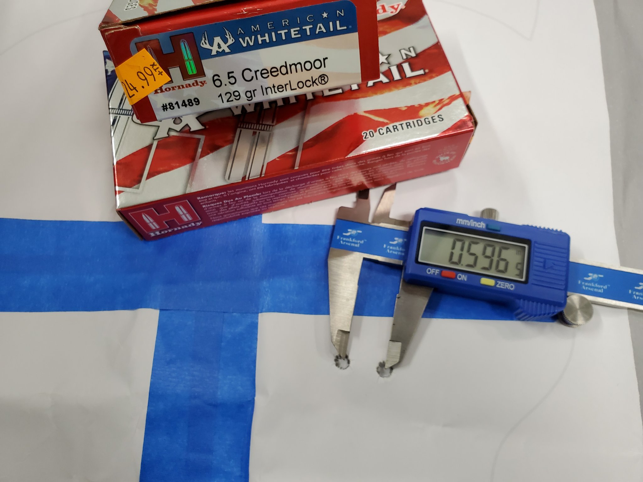

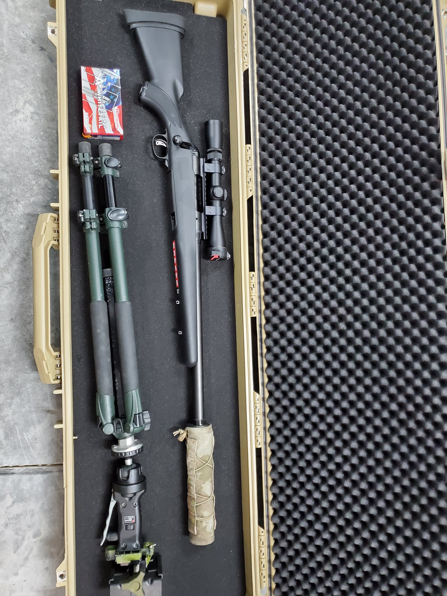

I just built a shorty 16.5 in rifle for my son. I had a factory savage 24 inch 6.5CM barrel cut and rethreaded by @toygunner .
Light weight was not a priority on this build. It comes in at 11.4 pounds scoped, suppressed, mag, 5 rounds of 6.5CM and has a stock pack not seen in pic.
Factory 129 grain Hornady American Whitetail
Only 2 shot groups because I was running low on ammo
The form1 can is almost 2lbs if I remember correctly and also has a muzzle brake. So that gets it down to 9lbs scoped, mag and ammo.
With carbon goodies and not counting scope I think it's doable.
Tikkas seem to have a very good reputation as well but I have no experience.
Good luck in your build. This build was assembled and zeroed Wednesday and dropped a buck Saturday.

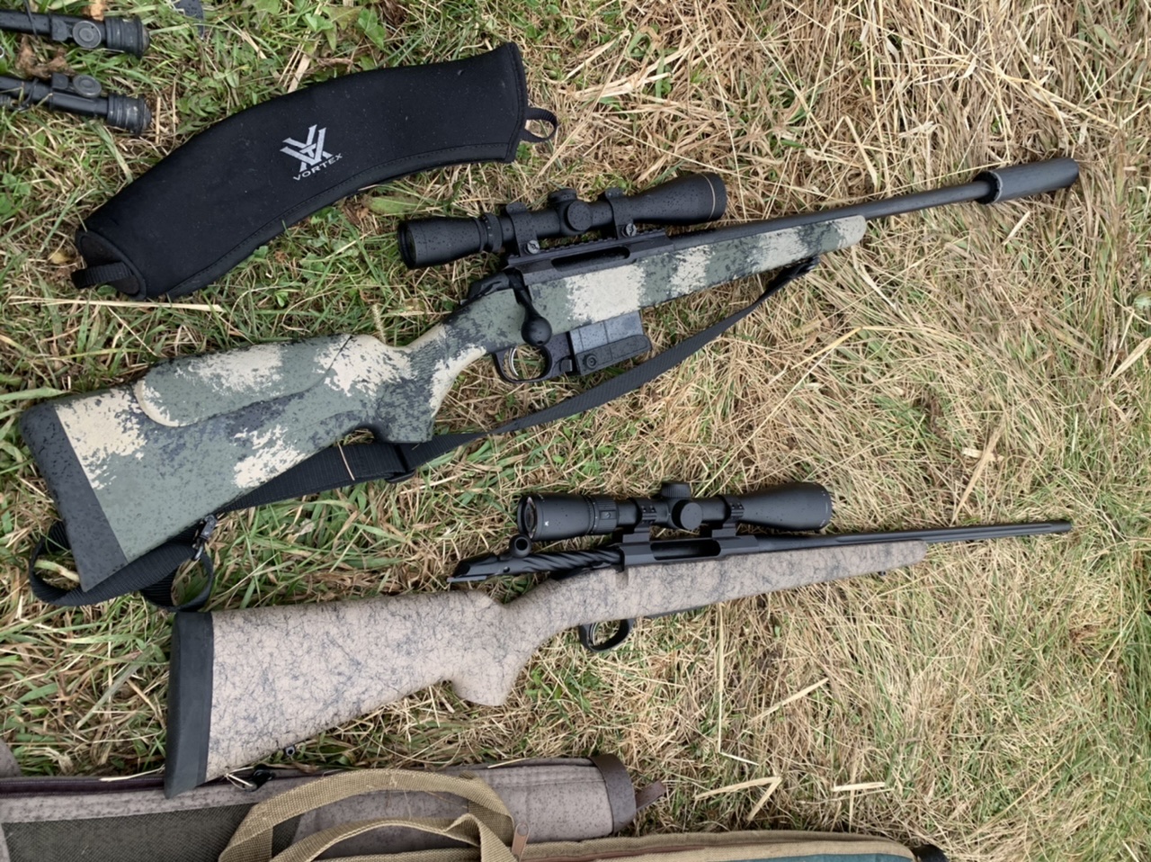

For your budget buy a Tikka Superlite and throw it in an aftermarket stock. That’s what I did twice now. 300wm and 270. Both will hold .5-.6moa 3 shot groups. Last year the 270 shown below went on a backpack antelope hunt. It got warm and I brought my camp and goat out all at once. I was glad for the light rifle.

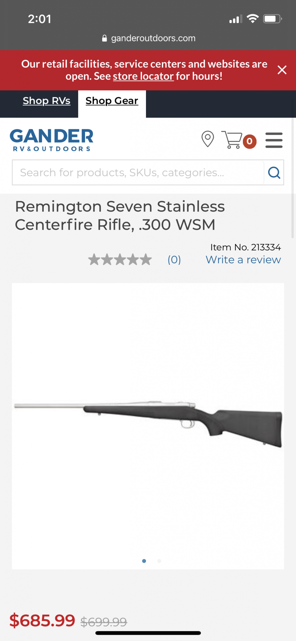

I bought my nephew a used Remington model 7 scout rifle in 260 Remington. It weighs a little over 6 lbs.
Get one in 300 wsm and rebarrel it.

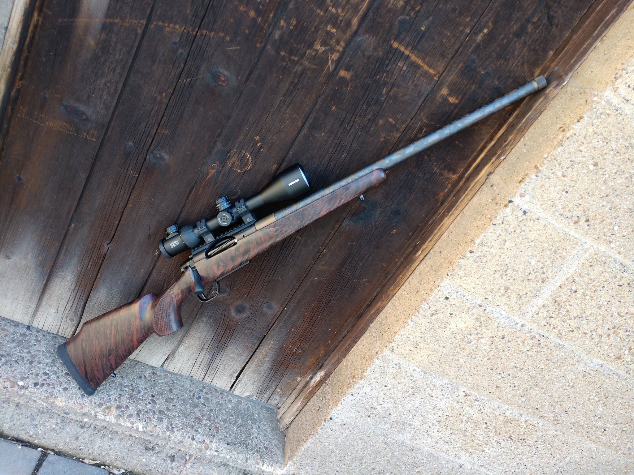

@Vandy321 I've been looking at similar rifles lately.
Over the course of the last 18month I bought bits and pieces from the PX and assembled a Bighorn SR3, a PVA chambered 6.5 PRC carbon fiber Proof Research barrel, McMillan Rem Hunter stock in McWoody, Wyatts 6.5PRC extended box, and Hawkins M5 BDL bottom metal. I just grabbed a spare scope off the shelf - an old second focal plane Minox 3-15 x 50mm and Weaver skeletonized "tactical" rings. It shoots amazing. Without a brake I have no issues getting consistent 1/2 MOA groups at 100yds and about 5/8MOA groups at 300yds.
My problem is that it is heavier that I thought it would be. My old tried and true Remington 700 Mountain Rifle weighs 7lbs 2oz fully equipped. This new 6.5PRC weighs 8lbs 5oz. It doesn't seem like much, but when you put on 6-8miles a day up and down western PA hills with the gun in your hands the entire time it gets heavy. This evening I'm probably going to pull the scope/rings/mount off and see what it weights. I know that I could shave some weight by using lighter rings and a lighter scope.
I had the chance to stop at Sportsman's Warehouse today and I handled several guns.
  1. Tikka Superlite in 300win mag and 7mm Rem Mag - nice light weight, heavier bolt lift than my SR3.
  2. Christenson Ridgeline in 6.5 PRC - about the same weight as Tikka, smoother/lighter bolt lift, great feeling trigger (trigger tech?)
  3. Bergara B14 Wilderness Ridge in 6.5 PRC - Nice rifle, smooth action - heavy.
  4. Bergara B14 Hunter in 7mm Rem Mag - slightly lighter than the Wilderness ridge, but still heavy.
  5. Montana Rifle Co X2 in 6.5 PRC - nice light weight, nice trigger, hideous muzzle brake, bolt issues (probably specific to this gun) it had a lot of cock on close compared to my pre-64 Winchesters and FN's, shiny spots in odd places, etc. If it didn't have this weird bolt issue I would have purchased it....in fact, I asked for a steep discount which they denied or I would have bought this one.
  6. Kimber Mountain Assent in .280 Ack Imp - Light weight, smooth action, decent trigger,
Again, realize that for the type of hunting I prefer to do, I want a really light weight gun...if it was just carrying it to a stand to hold on my lap or lean against the blind wall it wouldn't matter to me.
