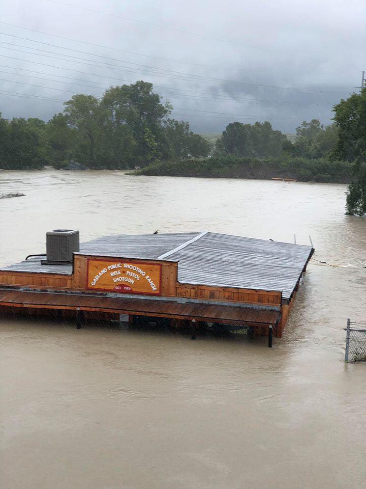

Love the idea---I may have to choose another "Severe Weather" offering, I think I might have issues
