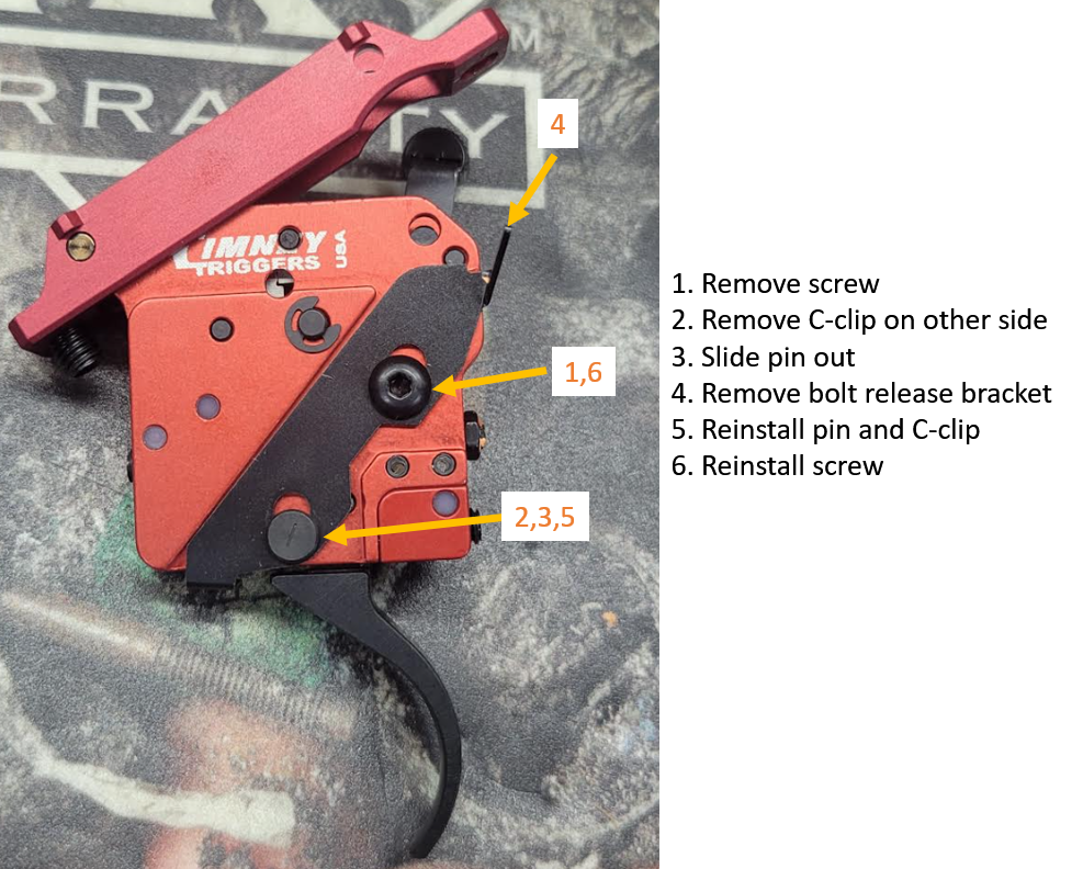

    When I remove it to install in my terminus, do I need to put the screw that held the little plate back in to run properly or just sit it to the side if I ever need it again. It’s the Timney Calvin elite 2 stage, the blue one. Thank you in Advance
    So this right?
    Pretty much.
    Just WRT #3 I use a punch of similar diameter to follow the pin out. Keeps the trigger and housing holes aligned.
    Then its easy to slide the pin back in pushing the punch out for step #5.
    But you have the right idea.
