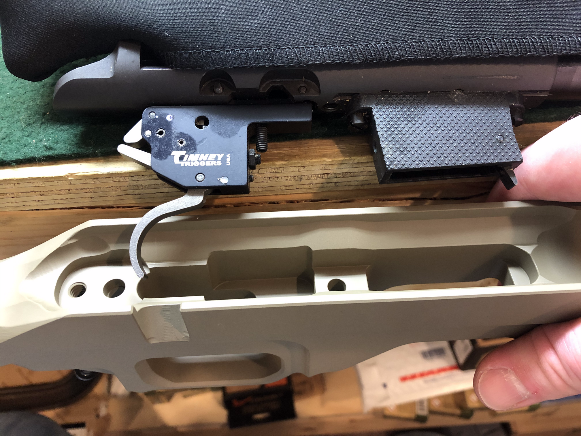

    I hate to bring this back up. But do you have a picture of the inside of your chassis? I have the older single stage Timney trigger. Which appears to be a similar profile. I tried to install it in my MDT-LSS-22 Chassis and I can't figure it out. The rear parts of the trigger will not allow it to seat all the way in. For reference this is a CZ-452 Rifle.
    I bought a Fly and it would not fit in my PDC chassis but I used it in another rifle. I wouldn't bother trying to use it as a 2 stage, feels very mushy, but can be adjusted to a good 1 lb single stage. At the end of the day, I won't be buying another one.
