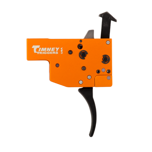

    I got the email today the Timney two stage trigger has finally been release and is for sale. I ordered one and hope it is worth the $195 they are asking for it. We will see.
    https://www.timneytriggers.com/shop/Tikka-T3-P109.aspx

    Received my Timney 2-stage yesterday and got it installed.
    Don't have much time on it yet, but my initial impressions are very good. First stage is extremely smooth with maybe .150" of travel, with a nice hard stop at the second stage. The second stage break is very crisp. Out of the box sear engagement and overtravel adjustment was very good. Right now I have it adjusted with a 14oz first stage and a 2lb 8oz break.
    Other good news-- it's an easy drop in for a Sako Quad, so Quad owners can finally have a 2 stage trigger if they want!
    Some observations though...
    The Timney doesn't have a bolt interlock when the safety is on like the stock Tikka trigger. While the stock Tikka trigger locks the bolt with the safety on, with the Timney you can manipulate the bolt with the safety on. This may be a benefit or drawback depending on your point of view.
    Timney says you can go up to 16oz on the first stage, but I could only get up to 14.5 oz before the first stage spring would coil bind and not allow the trigger to move rearward enough to break. What I did is hold the trigger in the fired position, gently screwed in the first stage weight screw until I could feel the trigger pressing forward against my finger as the first stage spring was fully collapsed, then backed it off about 3/8 of a turn to avoid coil bind. That produced a maximum 14.5oz first stage weight. This will vary depending on how you have the overtravel screw adjusted. If you like some overtravel in your trigger after the break (like an AI) then you'll need to back the first stage screw off more to allow that additional travel without running into coil bind, which means your maximum first stage weight will be lower.
    So far, quite happy with it. Now I'm trying to decide if I want to order 2 more for my Quads or wait until the KRG trigger comes out to try one of those and then decide which one to buy 3 of.

    Glad to hear you got your trigger I ordered mine on Friday the 12th and for some reason it didn't ship until a week later this past Friday the 19th I should get it this week cant wait to get it installed and give it a go. 3/4 MOA is the norm for me with the factory trigger so I am looking forward to see if maybe I can get 1/2 MOA or below.
    Update: Got the new trigger today and got it installed. The lightest I could ever get the factory trigger was around 1lb 4.5oz even with the “Yo Dave” spring. With the new Timney trigger it has very a nice and smooth 11.5oz first stage then a very noticeable “wall” come up on the second stage which breaks very crisp at 1lb 10oz. Dry fired with a snap cap about 20 times. Haven’t live fired it yet, but I think it’s going to be very good. I might make the first stage a little heavier, but other than that seems pretty good with the factory settings. As noted above the Timney trigger does not retain the bolt lock when on safe. The bolt will open when the safety is on unlike the factory trigger.

    Being able to work the bolt with safety on is a good feature in my opinion.
    TAC A1 2 stage is nicer than the standard tikka trigger in my opinion.
    If the Timney improves on that we have a winner.
    Reactions: Bravo6
    Is there lateral movement in the shoe on yours? The demo in their shot booth had a lot of side-to-side present, especially noticeable in between stages. If that’s how they’re shipping I don’t want it.
    I just checked mine really good and compared it to my 700 Calvin Elite, Regular 700, Thompson Center Icon, and a Geissele SSA, and it absolutely has no more side-to-side movement than those do. Mine seems normal in that regard.

    Got mine last week - installed and adjusted it to mimic my Huber 2-stage. The Timney is highly adjustable and so far I'm impressed. I prefer a somewhat stiff/springy first stage and it gets me there - once at the wall it's a perfectly clean break into the 2nd stage. As good as the Timney is it does highlight what great trigger Tikka produces out of the box - not a huge amount to seperate the factory version from the Timney if you're all good with single stage units - but no doubt this is a great option for those who want a 2-stage. Aside from my Surgeon I'm standardising on Tikka's now - so much aftermarket support and they just work.
    IDK that I could justify $200 to improve on a Tikka trigger. IIRC mine is set at 2 lbs and it feels great to me.
    But being able to use the bolt wiht the safety engaged adds another dimension of function to the rifle and may be enough to convince me
    So reading through this thread, you guys don't think the Timney is worth it if you already have a Tac A1?
    I have a Tac A1, but my issue is that I have the trigger right at 2.5 lbs and if I go any lower I lose the wall. It becomes impossible to find the wall without breaking the shot. Compared to my PRS buddies - their triggers can be set right at 2lbs or lower while still having complete control over the break.
    I like my Tac A1 trigger - so if it's not a significant improvement I'm certainly fine with just leaving it as is.
