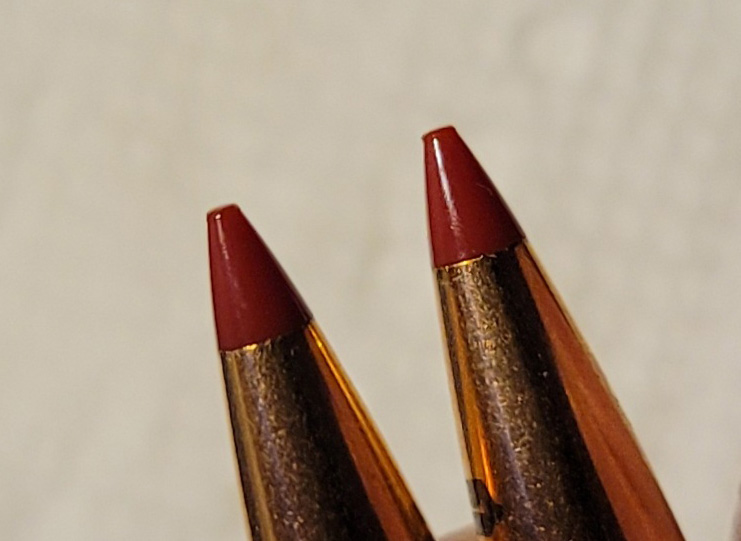

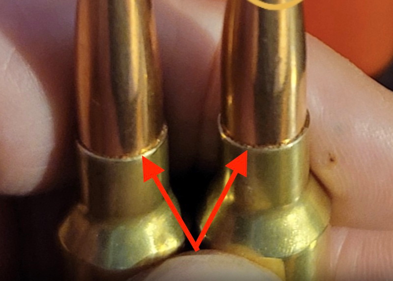

Out of reloading the last 100 rounds I experienced this 3 times. Starting to piss me off. Any ideas? The bullet was not jammed or rammed --felt nothing peculiar as I stroked the press --no unusual resistance.

Which seating die and stem?
"JB weld method" - thanks. I'll Google it.Take a look at your seating stem. You may need to modify it to contact closer to the ogive. There's always the JB weld method for getting a better, more uniform contact area.
I’m uncomfortable with the title of this thread and the description of the problem in post 1.
Take a look at the stem. If it's shallow, chuck it up in a drill press and drill out a good bit of depth, next use some valve lapping compound and a bullet in a drill to profile the stem, that ought to solve your issue if its the stem pushing on the tip."JB weld method" - thanks. I'll Google it.
Thanks..... Haven't got the drill press to modify it so I'll check it out buying onecheck out this page from Berger
Do I need VLD Seating Stems?
When loading a Very Low Drag (VLD) bullet or a hybrid bullet, we recommend that you use a VLD seating stem to ensure load consistency.bergerbullets.com
It is the same thing happening where the stem is pushing on the end of the bullet instead of the body (typically at the ogive)
I use mostly Whidden dies and have had to get the VLD seater stem for a couple calibers.

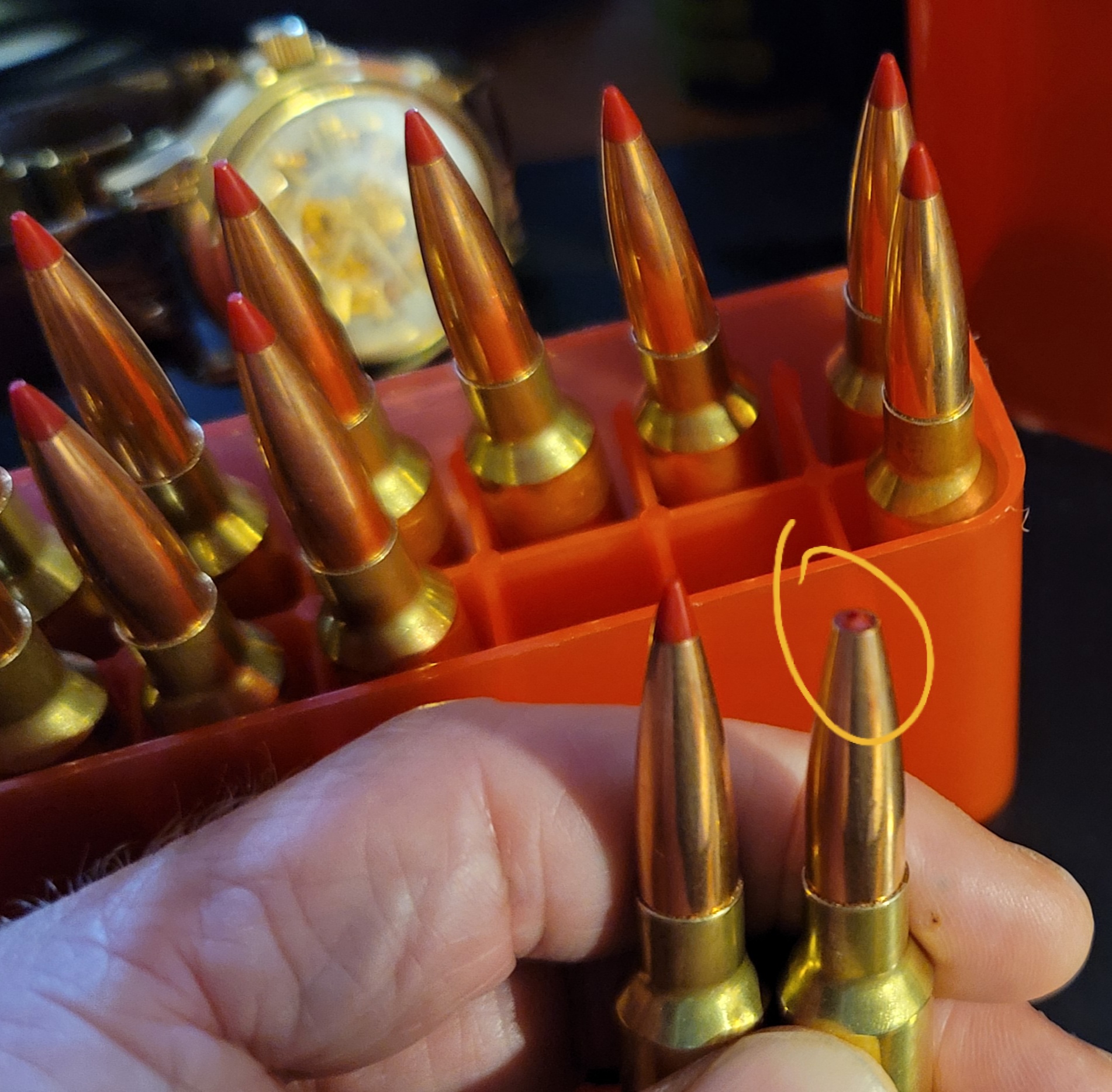

If you look closer at your picture you can see all of the tips are flattened. If you compare them to unseated projectiles they should be more of a rounded shape.

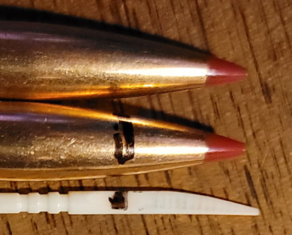

As others have suggested inspect the inside of your seating stem, may have part of a tip or other debris stuck in it, or it just may need modified to fit.

Its not thatMaybe I'm just going to fast and potentially hitting the tip as I first insert it.... Probably need to go slower.
Maybe I'm just going to fast and sometimes potentially hitting the tip on the edge of the seating stem as I first insert it.... Probably need to go slower on inserting.. make sure it's all aligned, no tilt before stroking.
Boom. Called Hornady. It's Hornady seating die part #397111Hornady sells seating stems for their different bullets, found this out after mashing a few aluminum tips. I just made one for my dies on the lathe, but they only cost about 11 bucks if ya wanna buy em from hornady.

.....the tip is hitting the bottom of the cavity before the sides.....
^ I noticed that too.Is it me or you have a bunch of rolled up copper shavings at the case mouth?
The cartridge on the left, just above your thumb, looks like the shoulder is collapsed a little. I've had that happen with too much lube when resizing but have also had that happen if the case mouth was not chamfered and/or the case mouth was not opened up enough to allow the bullet to enter correctly. Brass will have some spring back and I always suspected that was the issue with some several times reloaded brass. Once I started annealing, no more issue.
You're thrusting your tip into something not designed for something that length, that then bottoms out and makes your tip go and hide back in the body.

I bought a Redding VLD stem and the little test from Berger of putting a bullet in the end of the stem and seeing if it tipped (stem too short) is both simple and illuminating.
