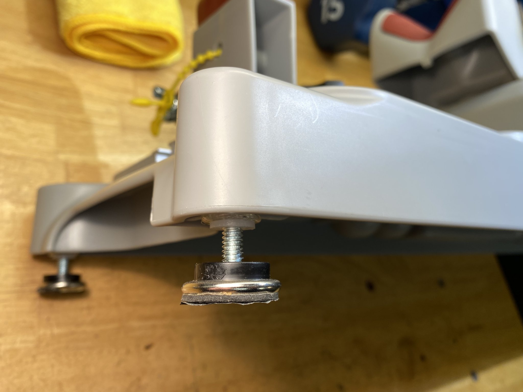

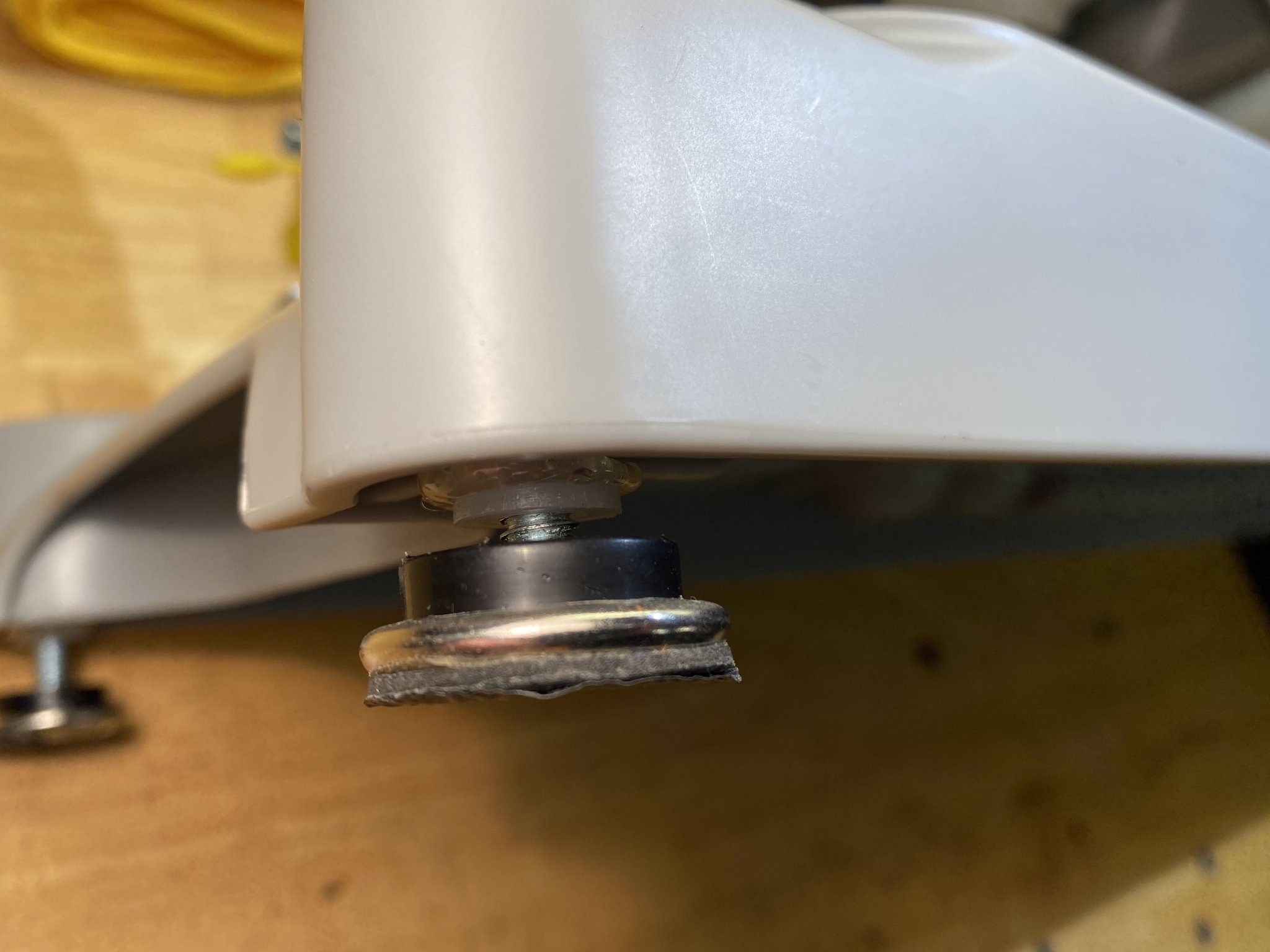

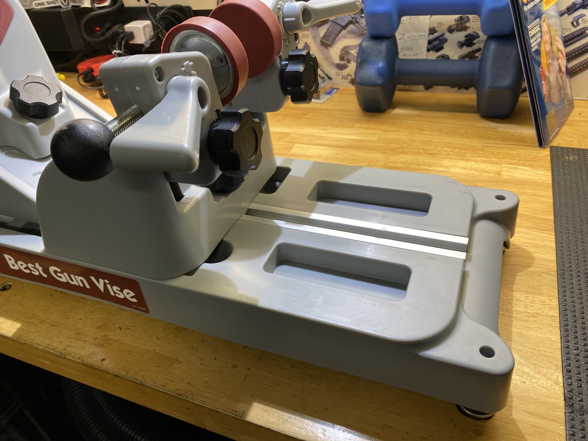

I found the Tipton vise to be useless except maybe to use for cleaning a long gun, but it seems to clumsy even for that too as
I am working the cleaning rods parallel to the bench edge which was awkward especially since the four corners of the
mount slipped on the bench when I pushed tight brush / patch thru the barrels. I replaced the footings with adjustable
larger diameter rubber footings to try to solve some of the problems related to fine tuning the position of the firearm with those goofy plastic clamps etc. I mostly use a bench mounted vise block specific for various rifles that has a lot more positional options and does
not take up the whole bench. My Tipton sits in a black plastic bag collecting dust, probably should just throw it out and free up
some shop workspace.

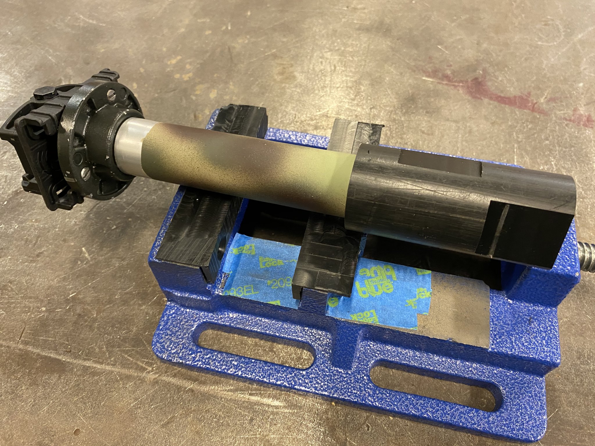

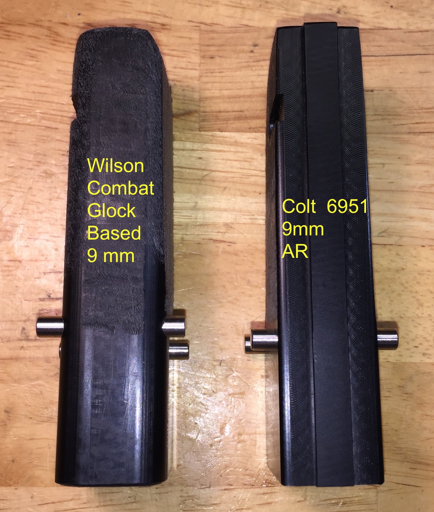

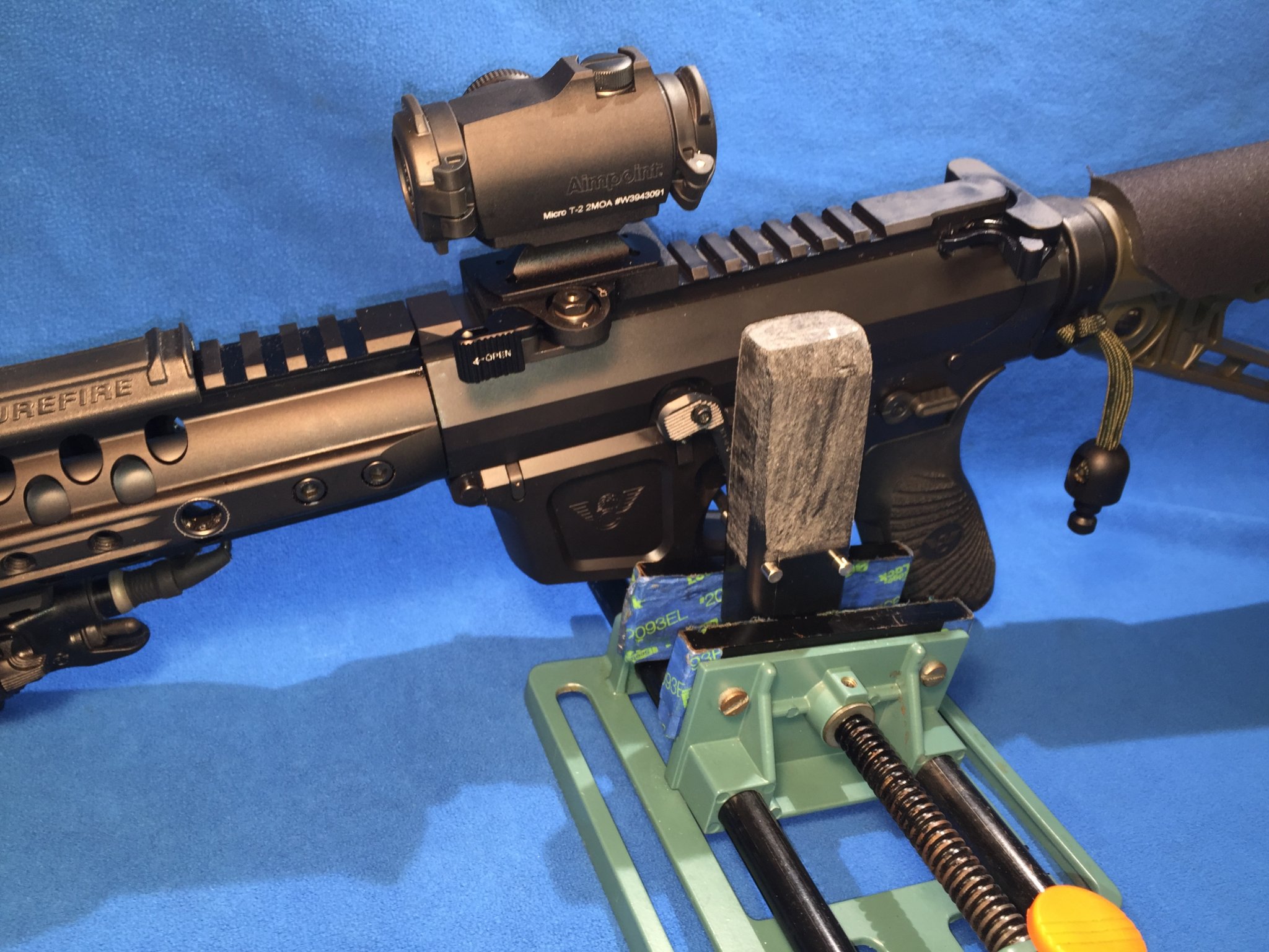

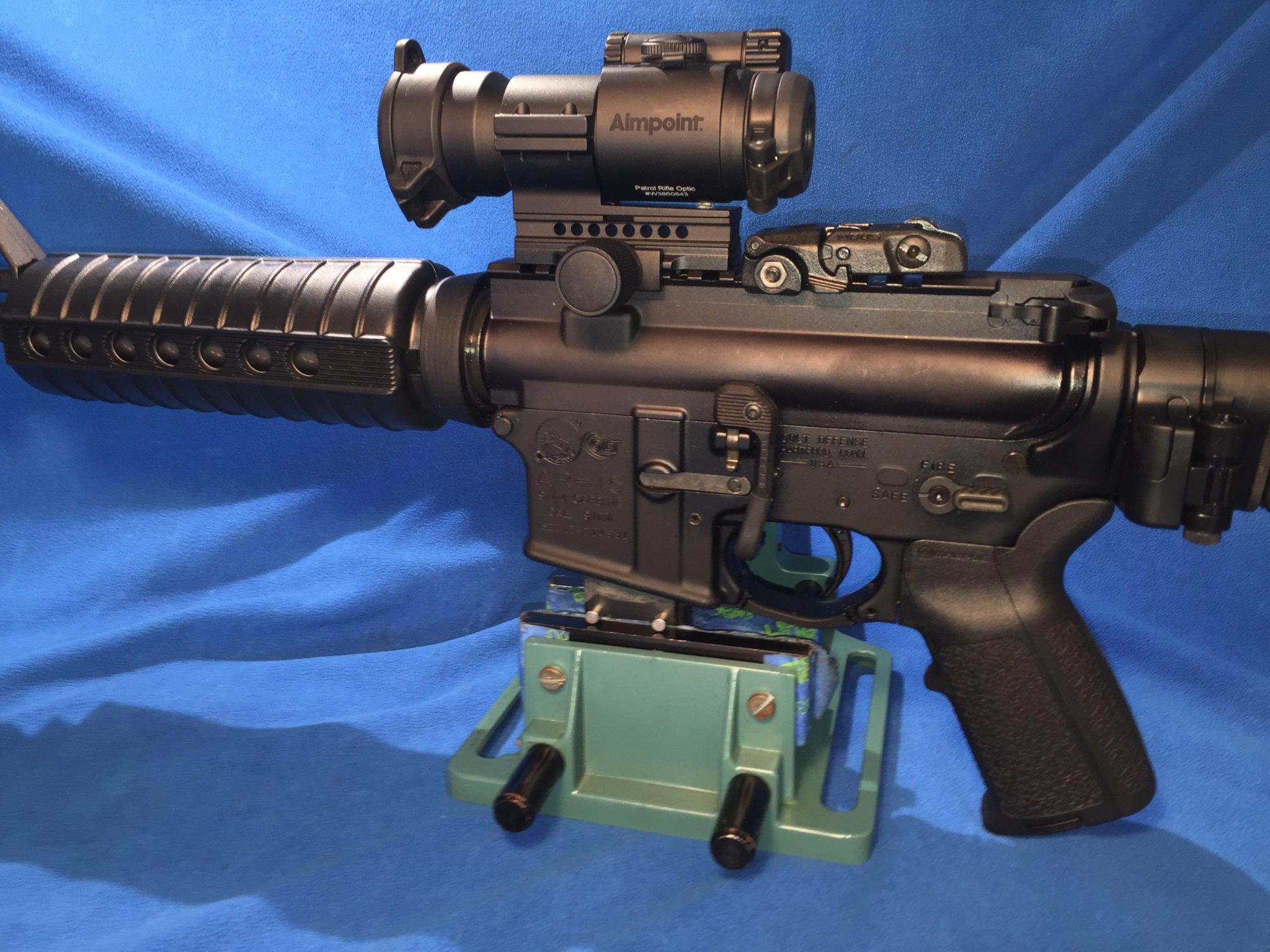

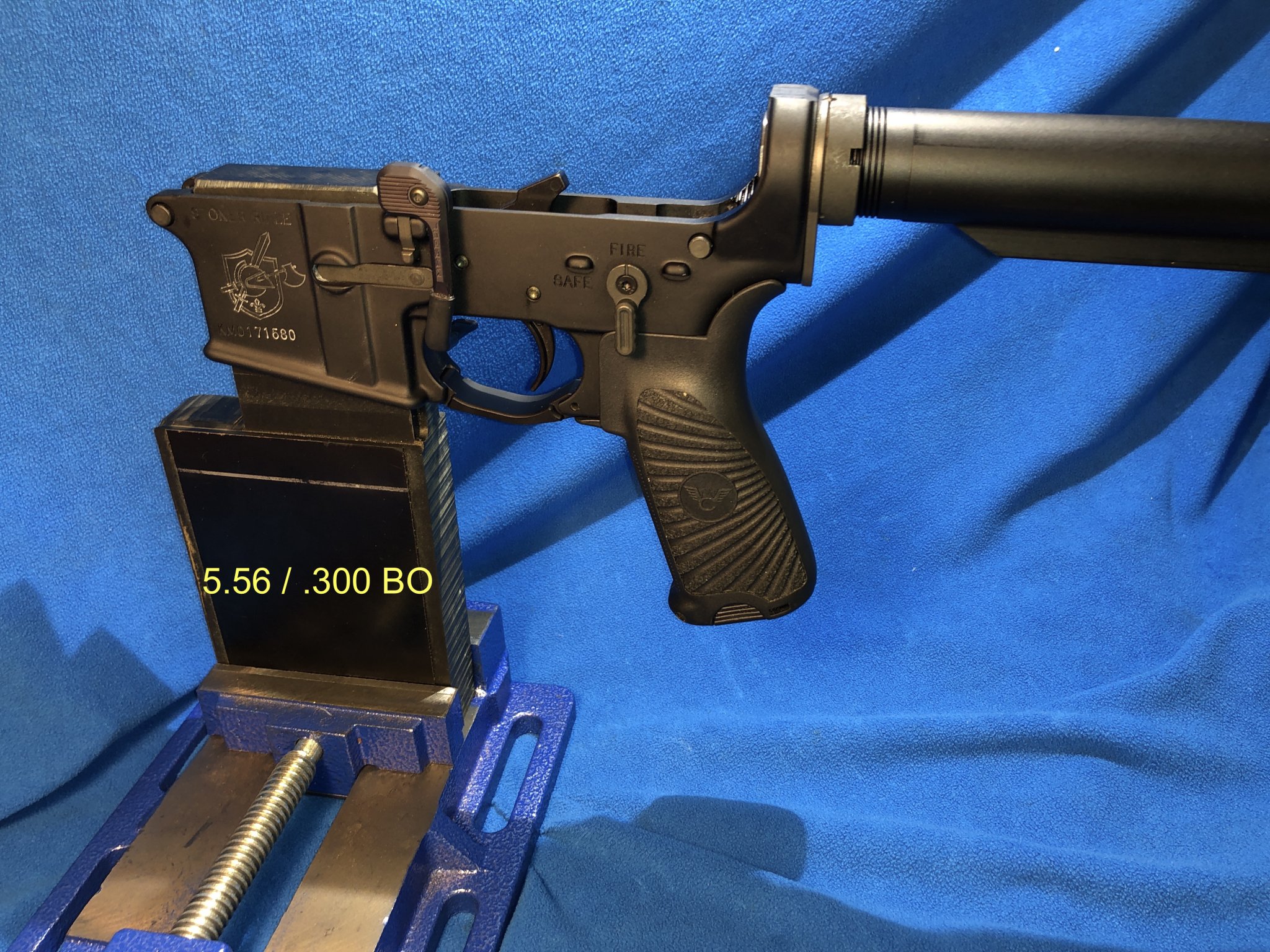

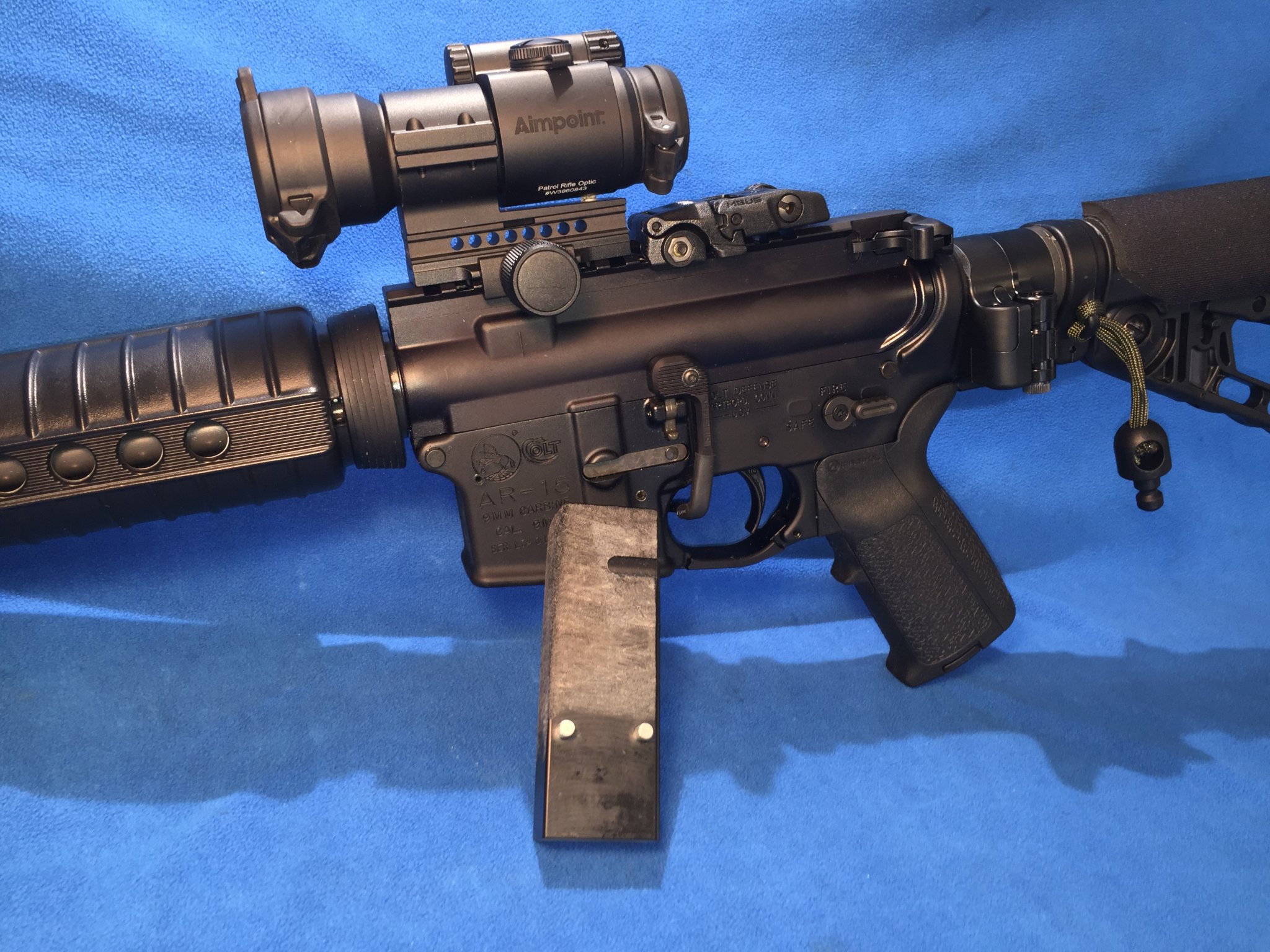

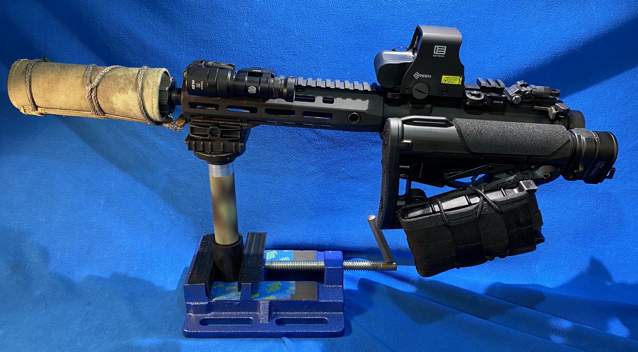

For vise bench blocks I use either picatinny rail mount or magazine well mount. The magazine well mounts have pins to stabilize
the block in the vise to prevent it from rotating off center, for magazine wells that are canted the pins are proportionately off set as well
to make the rifle sit square while working on it. All fabricated with Delrin polymer. A few examples by request.

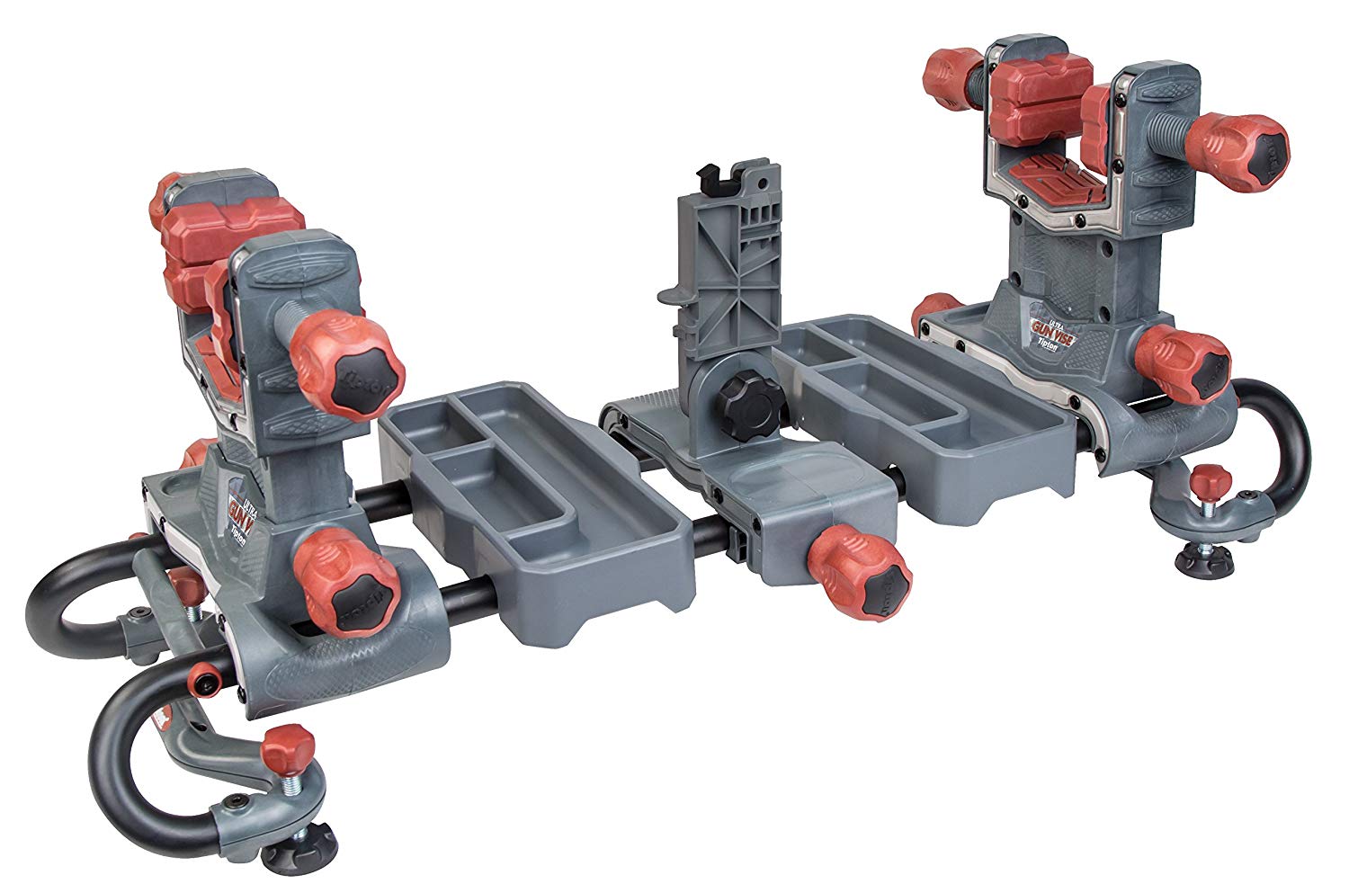

I use the Tipton "Ultra" Gun Vise ... and it's awesome. Use it for cleaning, mounting optics, repairs, mounting brakes, and everything else. It's never failed, nor has it ever "not" adjusted correctly. Had the cheaper one before, gave it to my nephew and bought this one a couple of years ago. Been totally happy with it.
Is this the one everyone "hates"? Cuz that would surprise me.

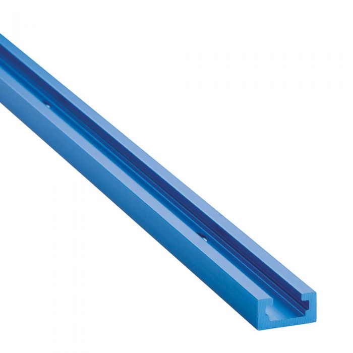

No it’s the garbage version before this one. I bought it and promptly disposed of it in the trash. I couldnt bare to return it or sell it and let someone else waste their money on such a piece of shit. this one doesnt Look any better though unless you modify it to work in a t track system. The biggest issue I had is it moved all over the place. I just use my bench vise now with the right tools.
Bench vise is good for some things, but not cleaning, mounting, etc. This one is great ... use it almost every day. I've found it to be very solid. When I tighten those knobs, the damn thing stays tightened. I've had my son hold down the vise as I've pulled off muzzle brakes that are torqued down and soaked in Rocksett ... so it's proven it's value to me based on a lot of abuse. Those are my experiences. As always ... YMMV.
