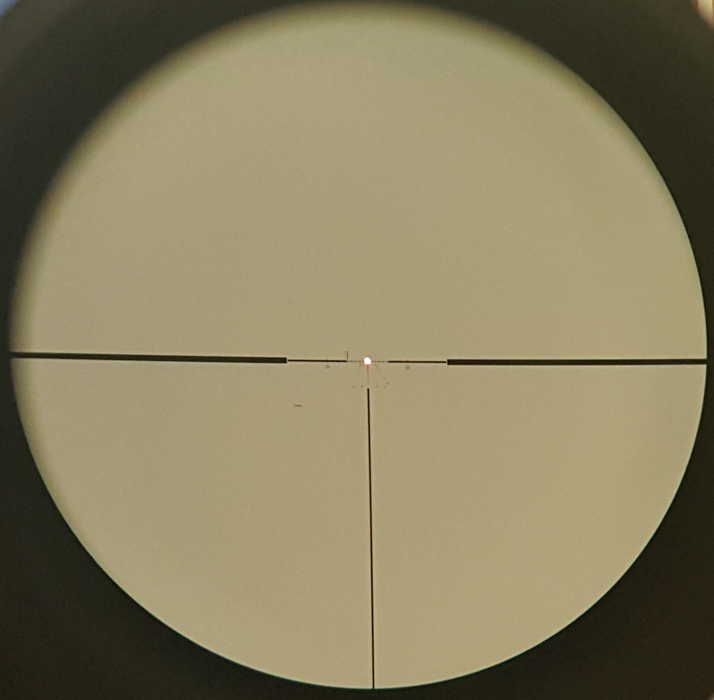

Sounds like you just need to get behind a better FFP 1-6, like the Leupold MK6. The reticle is perfect at 1x (just a nuclear bright 1 MOA center dot) and at 6x (open center dot and illuminated horseshoe surrounding it, with full milling stadia in case you want them).
1x:
7038384
6x:
7038385
I wonder if the tight eye box has something to do with FFP vs SFP.
Like someone else said, my Razor 1-6 is very easy to get behind. Without caps, the image looks like it’s floating in the air. It’s awesome.
1x:
6x:
Imho, that horseshoe needs to be there at 1x. It's of little use at 6x.

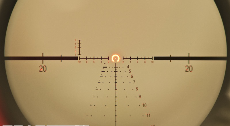

I tested a couple of versions of the March 1-8x when it first came out and liked it a lot. With the optional 6 position illumination, it is a very viable design.
Illumination is still not quite day bright, but the etched circle helps visibility without illumination. The 6 position illumination switch sorta combines the dynamic range of their Hi and Low illumination modules into one unit.
The horse shoe is there for the illumination at 1x, you can't make out the horse shoe at 1x, but since the horse shoe is illuminated it gives you a bigger "red dot". I have an NX8 and like it a lot, it has a 4 segmented circle around the center dot for the same reason, on 1x when illuminated it just looks like a 2-3MOA red dot.
I understand all of that. My criticism stands. If this works for you rock on. I am not judging anyone that's ok and/or prefers this. That's not my point. The large EoTech style reticle is objectively faster than plain dot at short to CQB distance. To lose that at 1x means it's quite pointless to incorporate it. At distance with magnification where you actually want just the dot, you have a horseshoe. This is inherently backwards of what is most effective. Again, if it works for you, rock on, I'm not judging.
The dual plain reticles starting to appear provide the best of both worlds. Until I find one I like, I am sticking with my Bushy 1-6.5 elite. That has a reticle I can use effectively within the intended scope of the weapon platform.
