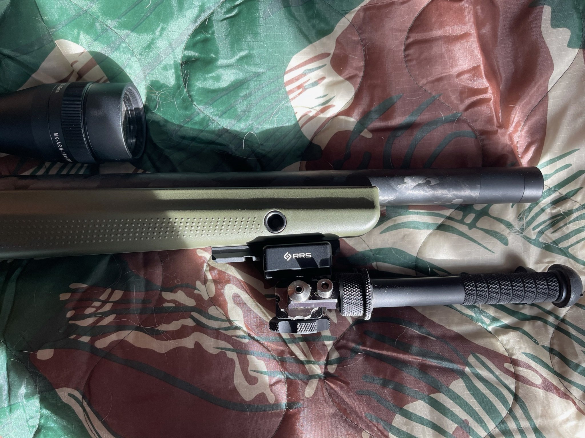

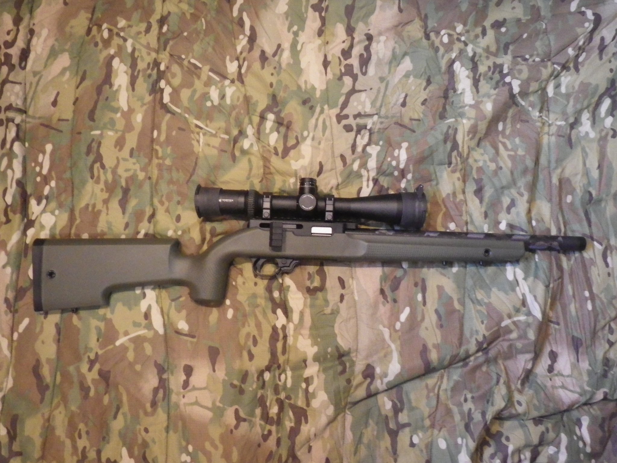

The Titan is plenty stiff for loading. I have had one on a PWS Summit for a few years now and love it. I have use both a Harris on the front stud and an Atlas V8 on a pic rail, both work well.
Like @hwy1strat mentions, I would also take a look at the KRG Bravo as it fits your needs and is in the same price range.

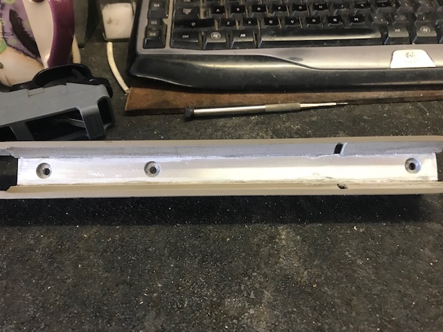

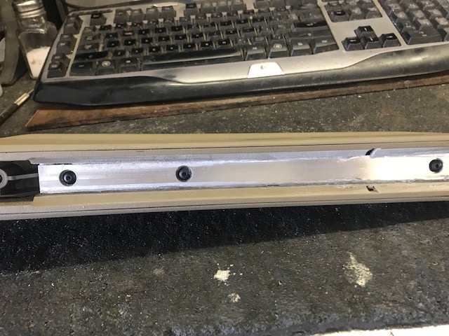

While I wait for black friday deals I did this.
I machined an aluminum spine from 5/8 square for my hunter stock.
Its crude but worked.
Once installed its hidden .
It took 90 percent of flex out of the stock
