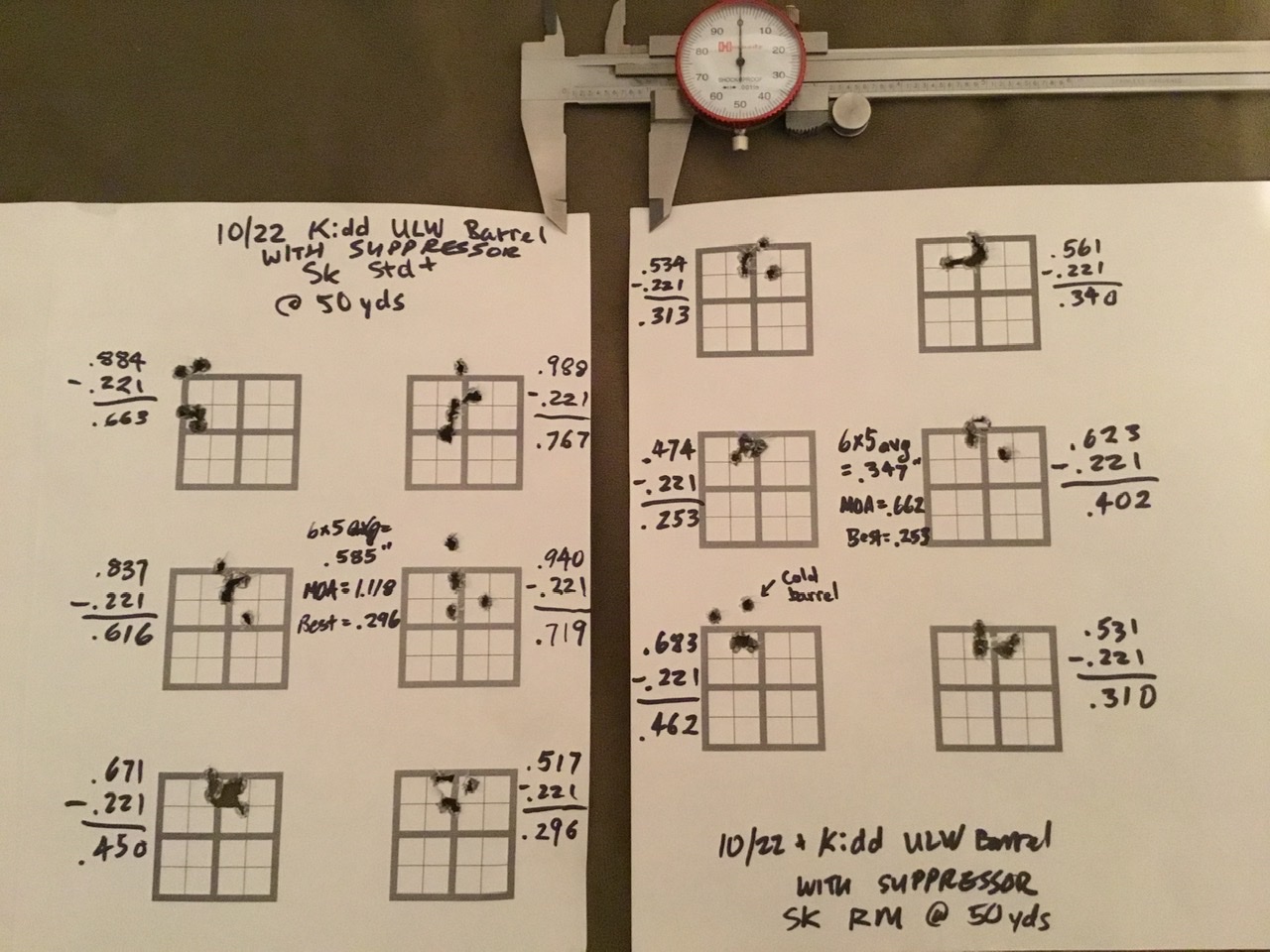

I‘ve only used the stock with the spike anchor. Solid lock up, no see-saw.
My 10/22, Kidd ULW barrel with the Titan22 spike anchor shot .347“ avg 6x5 groups at 50 yds.
YMMV, happy shooting.
