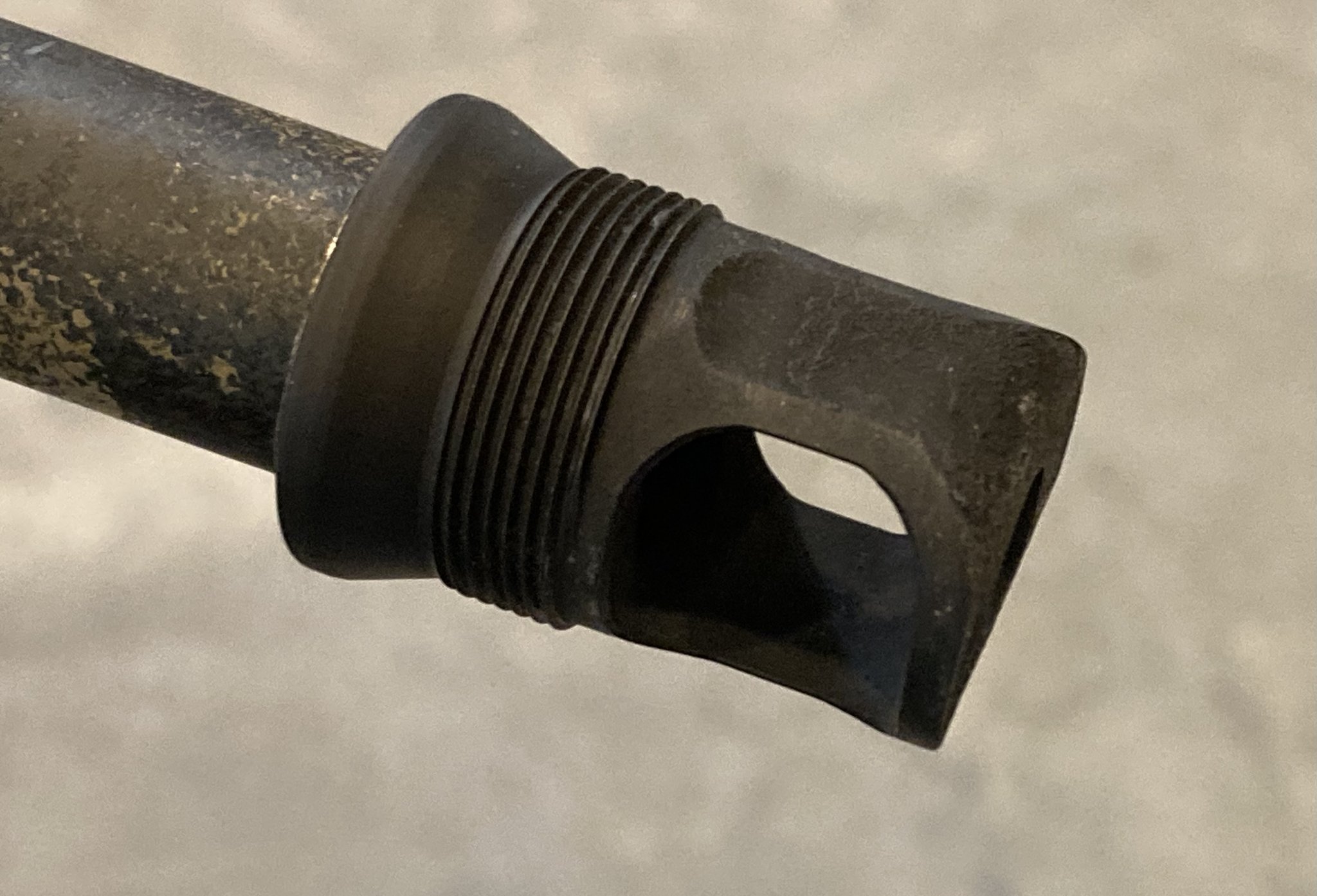

Is anyone making a Ti TBAC CB mount? I’m using an ultra 5 on a lightweight backcountry rig and it seems silly that the mount alone weighs half as much as the can. I’d gladly buy a Ti mount to shave off another ounce or so.

It’s awesome that you guys chime in about requests like this! Which is part of what I love about the hide. That being said, I totally understand use at your own risk. This can is dedicated to this rifle so if it welds itself to the muzzle device then I guess I have a direct thread can now and I can live with that.We would not necessarily recommend doing that due to issues with galling and thermal expansion rates. That’s why we don’t make them. Proceed at your own risk.

No, besides that the retention between a DT can and a threaded barrel is worse than the retention between a CB brake and a CB can.I've often thought about just using red locktite on a cb brake in my cans. I've bought enough brakes that I could've bought another can if my cans were direct thread lol. Is there any reason, for a dedicated hunting can, why it would be a bad idea to just red locktite a titanium brake in a suppressor?
ETA- I missed the part about a "titanium brake". When we used to make titanium-threaded direct thread cans (e.g. 30P-1, etc), we had cans get stuck all the time due to galling between stainless and ti. Not a good combination. We have never-- never-- seen a DLC coated 17-4 CB brake gall and seized on SS muzzle threads.
I gotcha, thanks for the info Zak!No, besides that the retention between a DT can and a threaded barrel is worse than the retention between a CB brake and a CB can.
