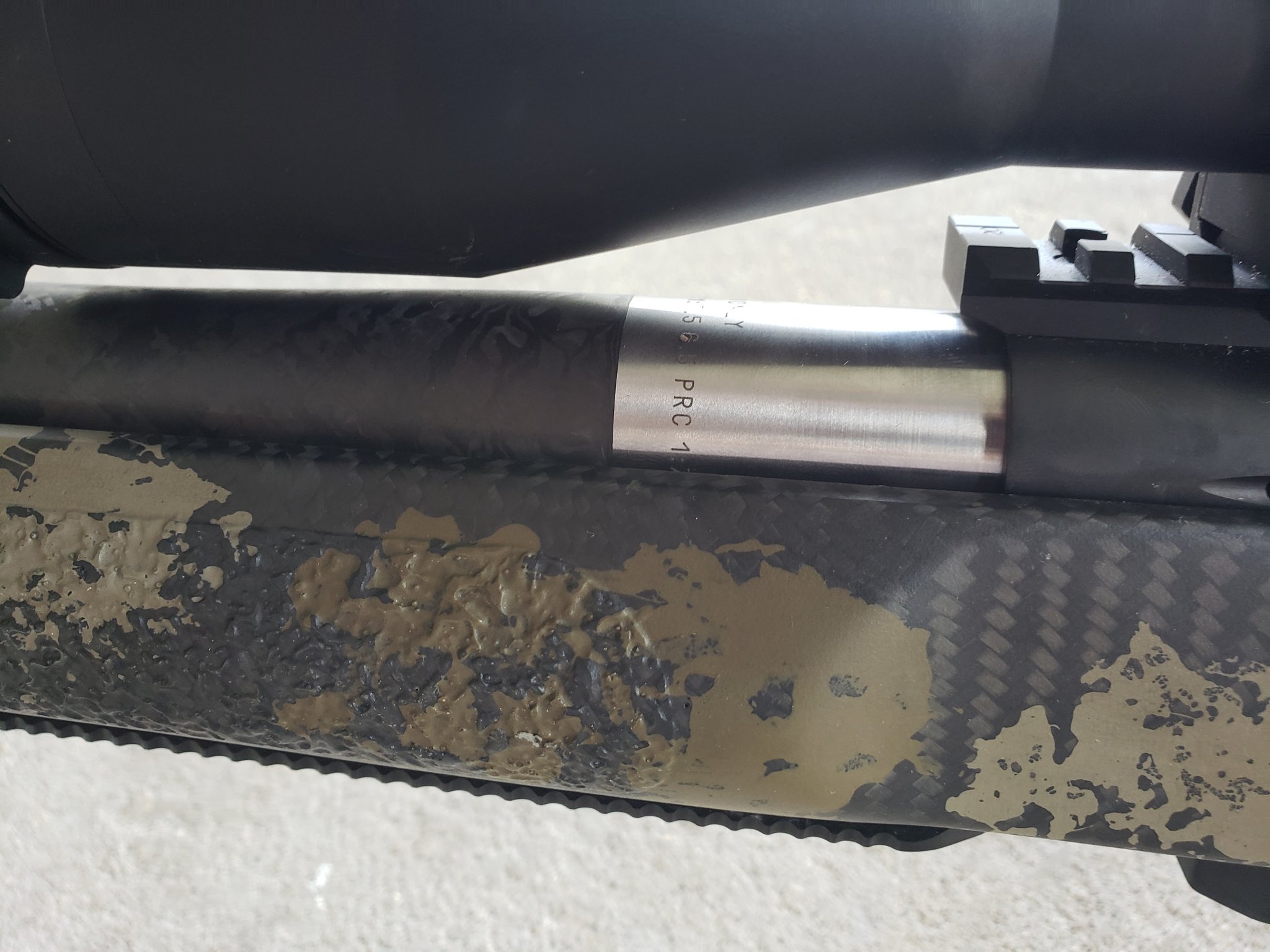

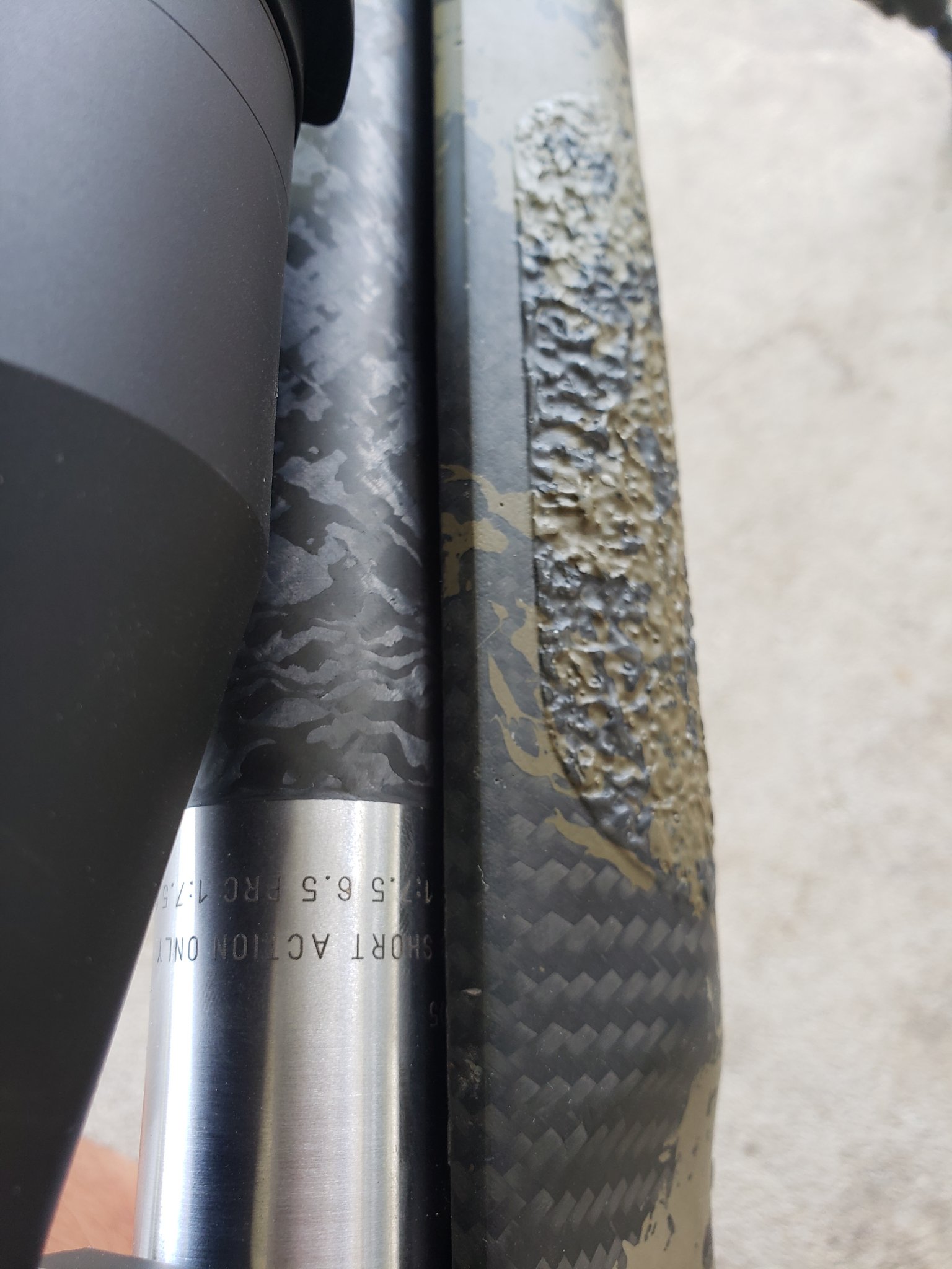

When I did my proof (in my viper) I just somewhat focused more on the breech end bolts while tightening and then once i had all 4 snugged tight i torqued them all down pretty good..... I DID use a toilet paper roll and it made no marks at all on the barrel on the carbon or steel.
Proof that I didnt damage my Proof....
I dont know if id try "just" the rear nuts period... It'll be fine just do what i described with main focus being on rear ones and use something(toilet paper roll) to grip it with the action as close as possible (and yes I left the rail on) and torque it down.Nice. I was just concerned about delaminating the carbon from the steel. I wonder if you can get to 100 ft lbs while just using the 2 bolts closest to the breach. Also maybe I’m just being paranoid....never owned a proof carbon before...
