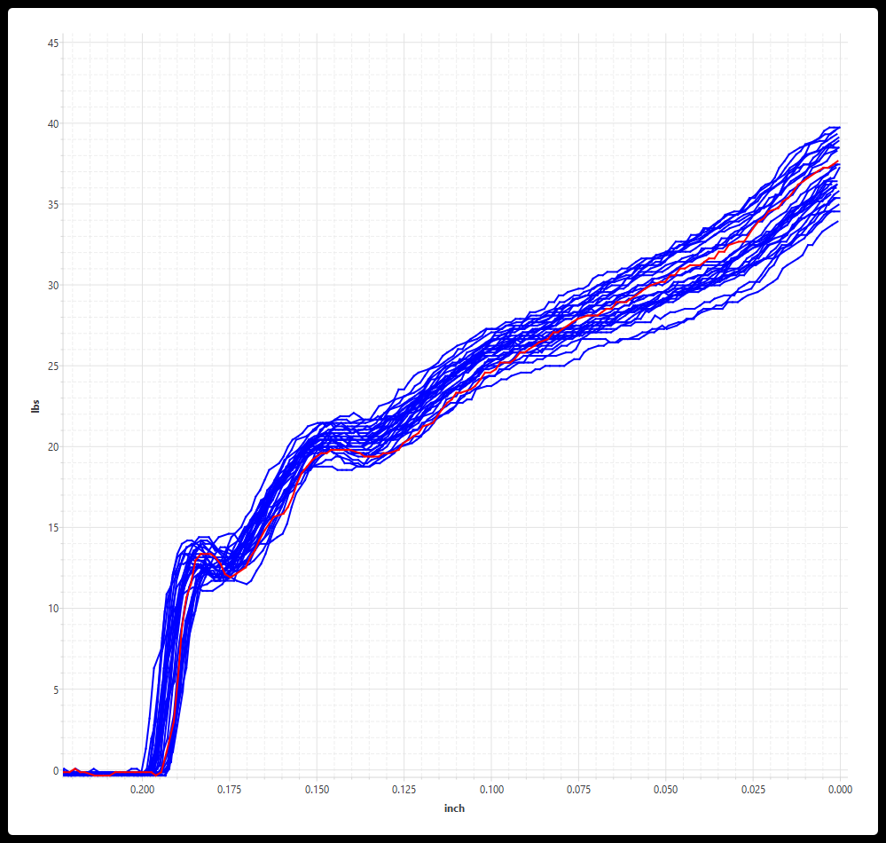

I gotta say... it's nice. Actually, the plotting of the curve is really good. Helps identify donuts and other potential inconsistencies and is a lot more accurate. The ability to save them and go back to review later is great as well. It's a tad bit slower than a hand press, but then I can also sit at my computer while reloading, which is a bonus sometimes.

I wouldn't exactly say it's that easy...
However, using it to hone your process to get plots like this are very satisfying. And this is a little higher spread than normal for this caliber (6 BRA).
