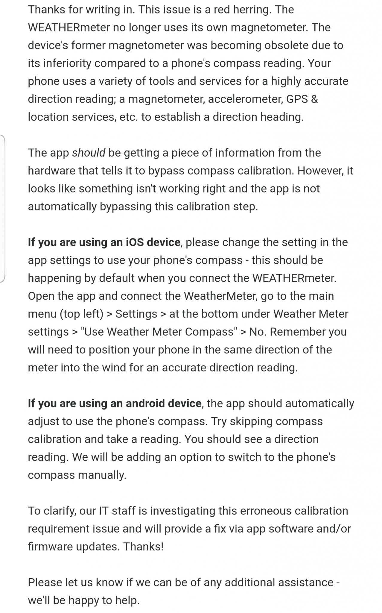

I just received my WeatherFlow Weathermeter Precision Shooting yesterday. The internal compass won't calibrate. I tried all of the troubleshooting techniques, uninstalled and reinstalled, rebooted my phone, so on so forth. I wrote WeatherFlow Support an email regarding my situation and here is the reply. (Disclaimer: I still have yet to go to the range and try it out using my phone compass)
I'm starting to get buyer's remorse.
did u get it to connect to your phone?
I did. I have to utilize my phone's built-in compass and hold the meter facing the same direction to ensure the degrees are right.
The bluetooth connects automatically, not throught the bluetooth options. Download the weathermeter app and press the button once while the app is open. Lmk if you get your compass calibrated.
you have to turn your phone location on in order to calibrate the unit. dont know why. I didnt have to use the weather app I just paired it to my strelok app and it worked perfectly once in turned my location on
Are you using an iPhone or Samsung? I did everything I was supposed to and it didnt do anything. I turned my location on and off multiple times, I spun until I was dizzy, blew slowly. No luck. I'm glad you got yours to work though. With the strelok app I have the option checked to use the phone compass
I found out how to calibrate the internal compass in the weatherflow. I used my air compressor to blow into the blades and then just spun in a circle very slowly just moving enough to light up another slice of the circle then I'd move again. it seemed like it needed more than 1 guest in every position. I dont know how you would have been able to do it with just blowing in the blades but I did get it to work with my Samsung galaxy s8+
Idk if it has anything to do with an update or not, but I cant get another slice to light up whatsoever. I gave up on it and use my internal phone compass. I'll try again at some point. I have an S8. Again this was trying last week when I got it.
