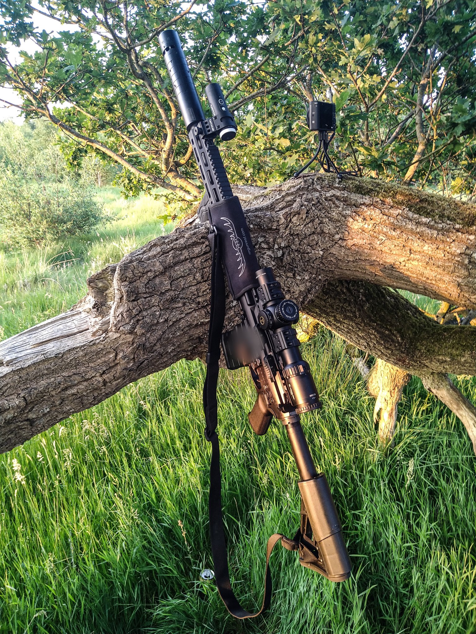

Attached are pictures of my current MDR-10 setup as well as two power point mock-ups future setups..... Yes, I'm a geek that way :)
