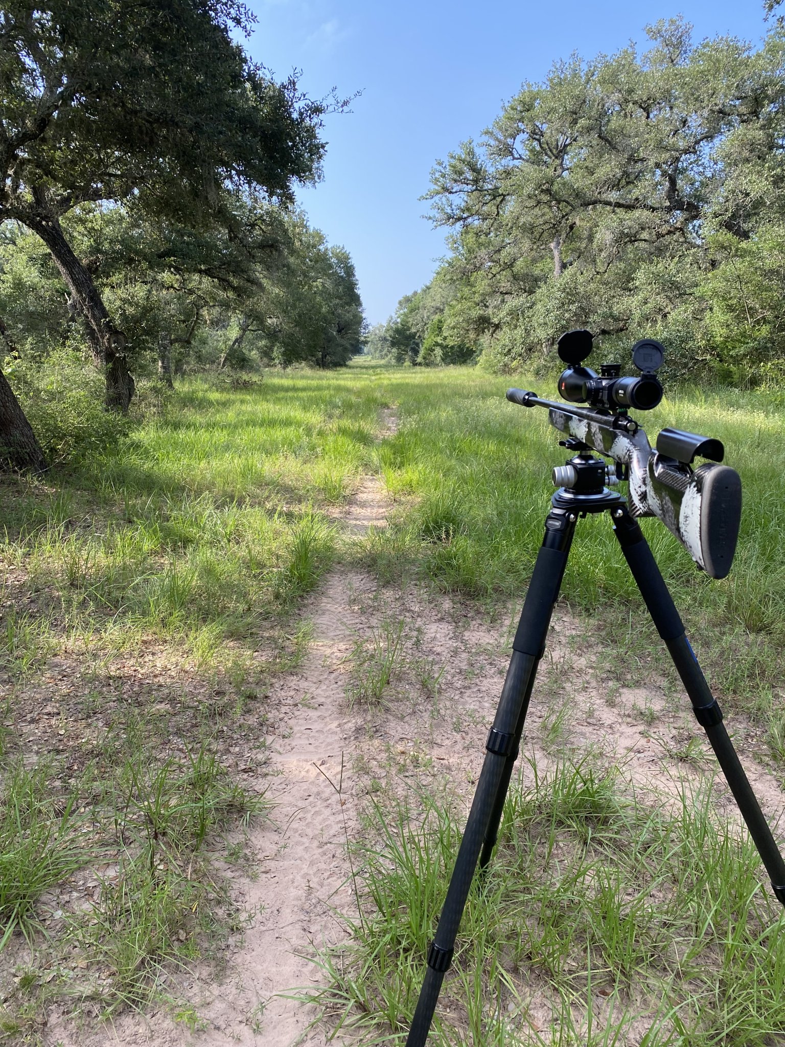

Alright all. Just got my rifle back yesterday from Live Oak Accuracy. Scott is a stand up guy and knows his stuff. Seems he machined all of the Stiller Mk13 receivers back in the day and he clearly cares about craftsmanship. Cut the barrel back to 17.5", threaded, and installed Scott's proprietary brake bring overall barrel length to right at 18.5".
Dropped the action into a used CTR stock, swapped the pistol grip for the traditional one to slim things down a bit. Then threw on a Murphy Precision rail and Leupold VX3HD 2.5-8x36 for the time being. Might go with something nicer down the road, but wanted to start off light.
Here's a beauty shot. Hopefully I'll get her to the range in the next couple of weeks.
