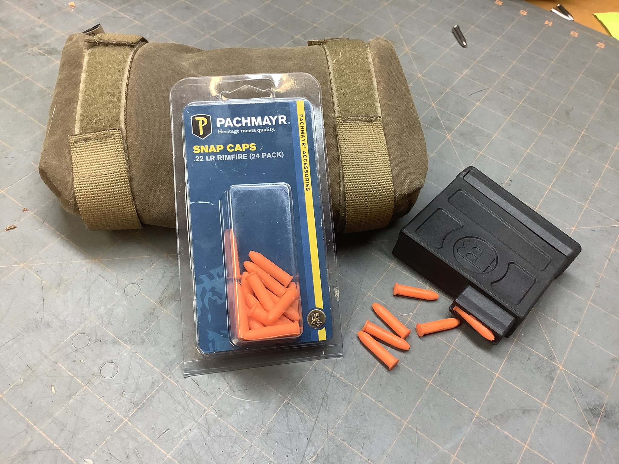

Wulll, I just got these and they look pretty good.
I cycled these 3 times through the mag and no problems. I’ll be using these until something better comes along. I don’t want any more down time waiting for on new firing pin.

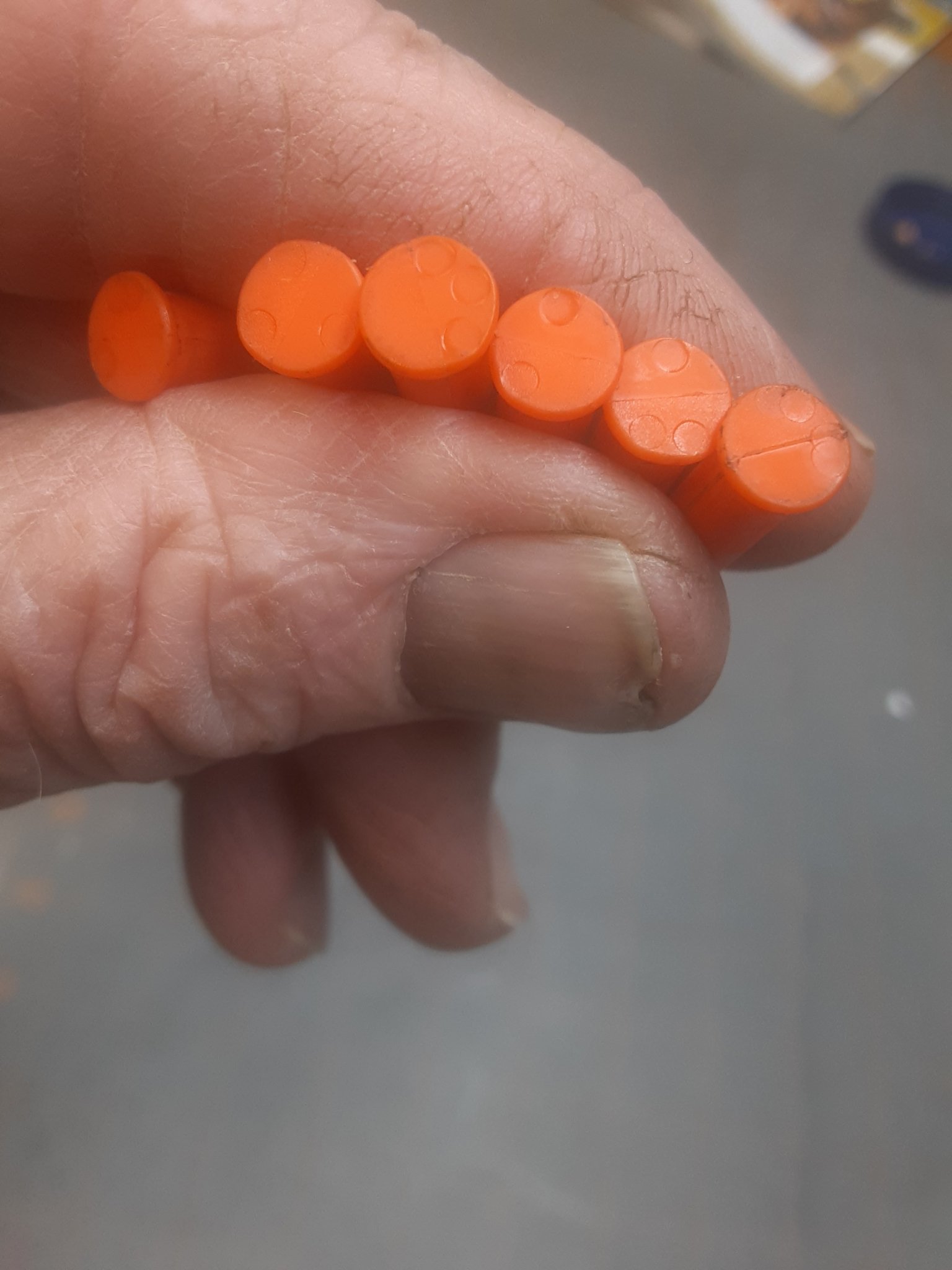

@fasteddie - Yeah, I’m really in the very preliminary stage looking at these. Maybe the real deal, maybe not. After more DF’s I’ll have a better take on them. For now I’ll use them just ‘cause I don’t want to be down for a broken firing pin.
I tried some of the yellow drywall anchors, Hillman 370326 I never ended up using them. while close to a .22 shell at least in the couple guns I checked them in the plastic rim sat below the chamber face, meaning that you still run the risk of peening a chamber should the gun be capable of doing that.
