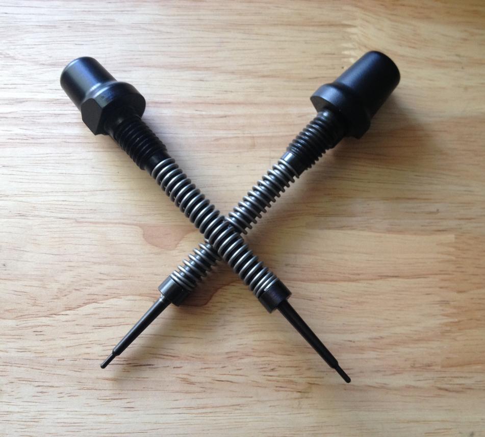

Okay I've heard its NEVER a good idea to dryfire your rifle and that's what snap caps are for, and I've also heard it's no big deal and that you should do so in the dark practicing your trigger pull. Well which is it????? Does it matter or not if you have an aluminum firing pin? What is everyones take on this controversial topic?

unless it's a rimfire, dry fire the ever-lovin'-shit out of the rifle/pistol. Dry fire is one of the most overlooked practices in firearms training disciplines. I think snap caps are a gimmick...I've never used them once, I dry fire my rifles like crazy, and have no issues as a result.
The firing pin bottoms out on the back of the bolt face whether there's a round chambered or not, so how would it do any more damage than regular shooting? The rimfire is different in that the rimfire bottoms out on the rim of a case, which is soft brass, and absorbs the impact, when you are empty chambered, it then bottoms out on steel, and can therefore ruin it.
Dry firing is typically bad on rimfires and guns you forgot were loaded.
All others should be dry fired. If you are worried about damaging your firing pin, buy a spare. A very nice $40-50 firing pin is still less than 50 rounds of ammo for most people. I know my old savage 308 was dry fired over 100,000 times in a 2 year span, not counting the 5,000+ live rounds...Never had firing pin issues. There's one perspective.

I found a little problem when dry firing my 1911 type of pistol. I've dry fired that puppy A LOT over the years and one time when I had it all taken apart I noticed a burr building up on the Firing Pin. I'm not sure it would actually cause a problem but It figured it wasn't right. Now I use a snap cap like cartridge in the chamber of the 1911 when I dry fire.
1911 is the safest firearms to dry fire..if dry firing is matter..i dry fire all my firearms specialy my sti for limited and open competition..i think i dry fire my 1911 more than live firing them and never seen any damage..sometimes i like to see damage so i got excuse to buy titanium firing pin:)
I assume the ptg like most of the others has a steel tip...hence multi piece. I would advise against repeated dryfiring on an empty chamber.
I'm not positive but I thought they were one piece aluminum, I'm gonna check with them tomorrow. So I guess one piece would be ok? I have one of their steel versions too but thought the aluminum would be "better" maybe not huh?

I've always dry fired for practice. I've heard it both ways though. Do it....don't do it or the world ends.... However, a few weeks ago I was dry firing my GAP .338 LM built on a Rem 700 action, and the firing pin actually flew out on one of the fires. I was planning on sending it to GAP for something else, but that sealed the deal and I sent it the next day. Once they take care of it, I'll report back with what they tell me. I'm the 3rd owner, so I don't know what else may have happened to cause that issue so I can't say for certain it was dry firing.
