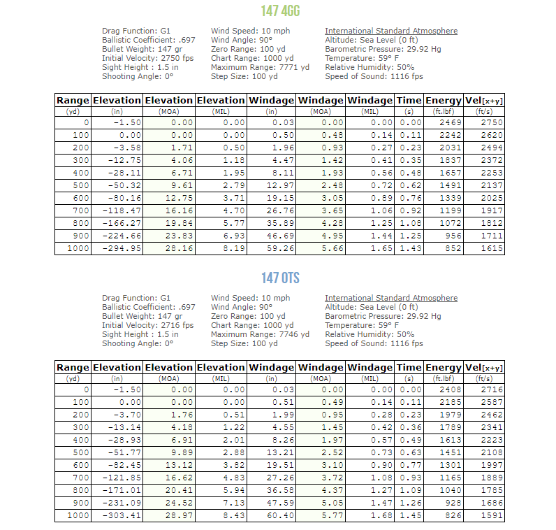

    I've done two videos on this topic, the first is a comparison of my 6.5 CM hand loads versus other OTS options (a while ago, but you'll see the difference) and the other was a video on TRUE reloading options from Low to High end reloading setups (I know you already have your setup, but there may be some newbies here who are thinking of getting into reloading so I included it). My 0.02 is that if you're shooting a match where say 20% of the targets are 800 yds and beyond, then your chances of impacts with factory ammo versus a well trued hand load will be less. But, for the 80% of targets inside of 800 yds, you should be OK with OTS ammo. I did a quick and dirty comparison based on my video and an ES difference of 34 FPS...Included the chart below. THIS IS NOT MEANT AS A DEFINITIVE ANALYSIS, just something to think about:
    This is awesome. Thank you, I will look for your video too
