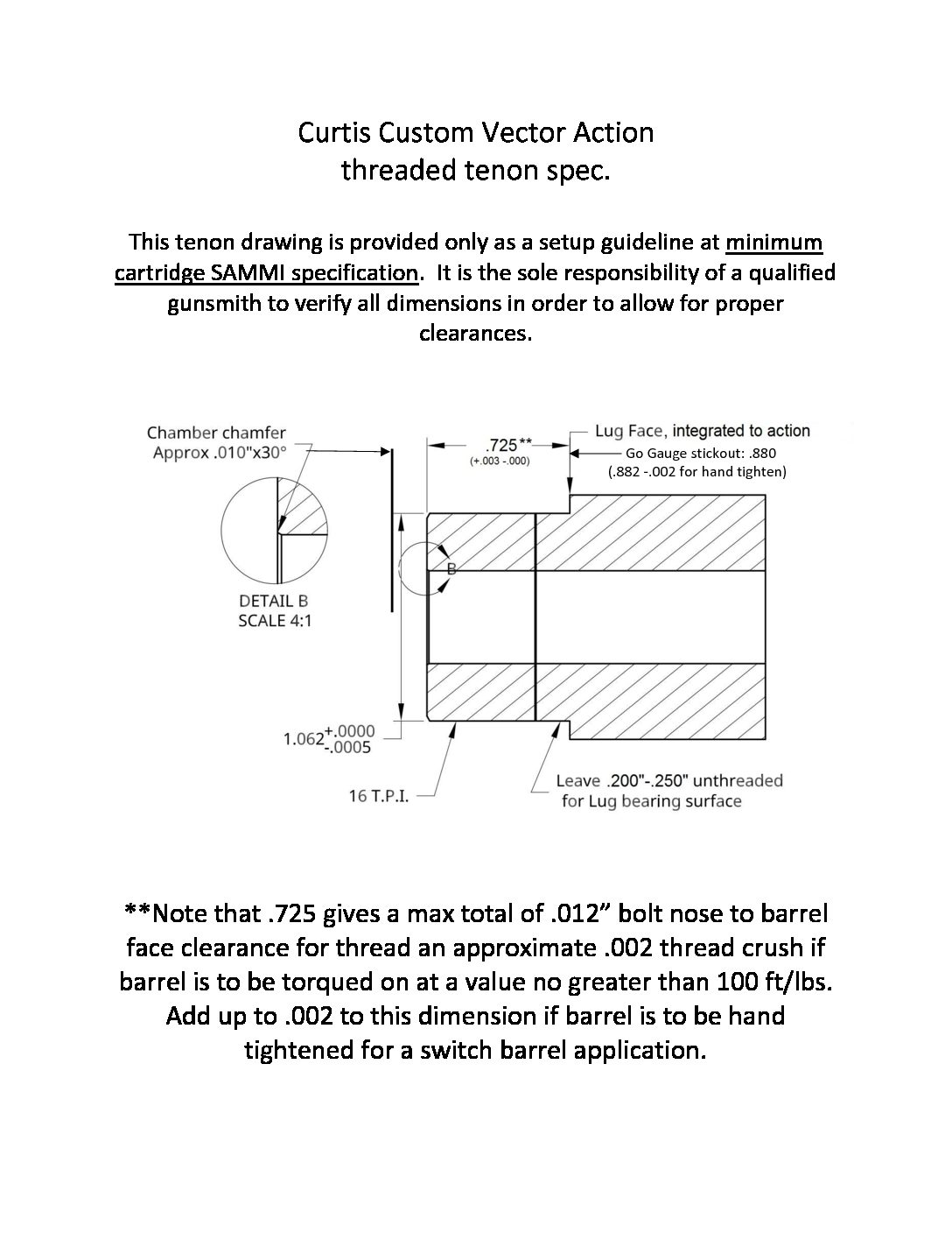

    If your planning on hand tight the gunsmithy is supposed to change the machining to allow that. After torquing it on there is something like .002 thread crush that needs to be accounted for. I dont know if that is an every time thing or if it is just on the first spin, but apparently it is a thing. Here is how I learned about it

    You're giving too much consideration to this .002" thread crush fit thing. The idea is that headspace is 2.xx3" and if the gunsmith cuts it and then tests it on a guage without torquing the barrel at 2.xxx3 , once he torques the barrel on to some high torque value like 100ftlbs it's now 2.xx1" instead of 2.xx3". So they put two straps of scotch tape on a go gauge to replicate a no-go, plus .002" for crush fit. That's all. My point is it really that big a deal? If you're chamber is .002" longer bc your smith cut it for a crush fit that you're not using? The brass is going to be short on its first firing more than likely anyway. Just don't continue running the brass out of headspace. Thats where you'll get into trouble. After the first firing, you now have headspaced brass. Set your die to bump .002" and go.
    By all means, put some torque on your shouldered barrel. The example of guys shooting hand tight is just an example of an extreme to provide some perspective of how little it probably matters between guys advocating 120lbs vs 70lbs or even 40lbs.
    Yup, the question is how tight do you want it, to reduce the risk of it from coming off?
    Obviously, factories go with the "never in a million years" torque spec".
    Gunsmiths regularly go with 80 to 100 on shouldered barrels.
    If you use a suppressor, I like more torque cause sometimes pulling a gunked up suppressor is a pain. Lower torque, which shoots fine and doesn't come off from shooting might not be enough, I have pulled off when a suppressor was stuck on.
    Yes. Makes sense and I agree. I was just theorizing off of what I just learned about, however I do know of some who really do cut barrels and chambers for hand tight only applications. Cant say I agree, but it is a thing. I guess my real point in my previous post was to find out if the .002 bump on the brass was such a big deal that if they wanted to start shooting hand tight would they need to account for it. I wouldn't doubt it would be safe enough, just trying to figure out the reloading concepts before I start.
