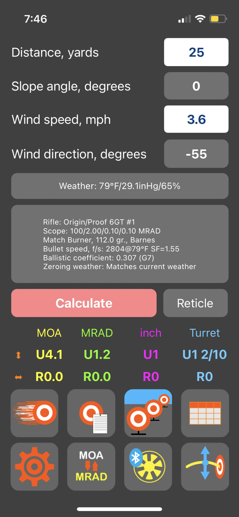

Just set it to "stop" a mil below zero. Then you could dial down even though I don't understand when that would be necessary. Maybe all scopes won't let you set the stop below zero?

Strange but true, never really thought about shooting my bolt-gun at 25 yards, but now I know lol.
Yup. It’s why I have always said if you zero at 100 you will be dialing up whether it be 10 yards or 1000. In matches now there is usually nothing closer than 200 yards but we used to shoot in close just to imbed this in shooters. We shot at 14 feet before. If I remember it was about 13 mils up. Lol

Not relevant for the distances shot in LE, but one reason not to use a zero stop would be to switch to Speed Drop Factor 0.
For example, with a 5.56 shooting 77gr BTHP at my elevation, I need to dial down 1.5M to use Speed Drop Factor. The scopes I have do not allow dialing down that far if the zero stop is set.
